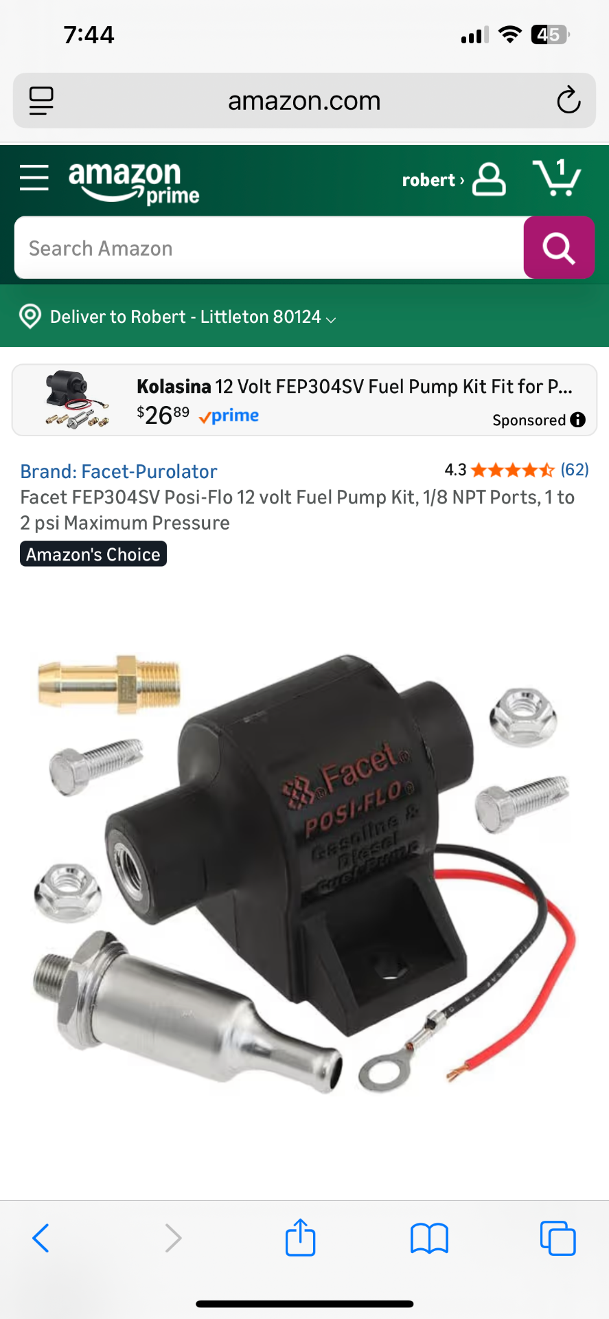

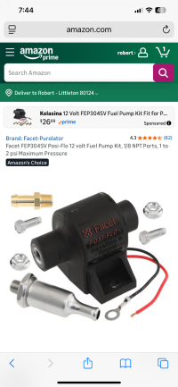

I use this one on two of my diesels. It replaces the bulb in my 743
