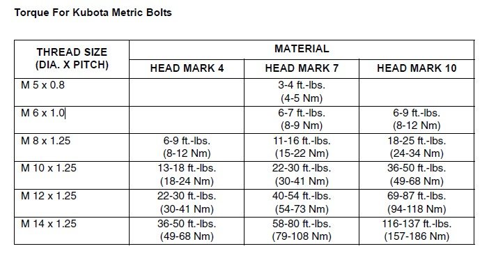

Hi All, I finally pulled my engine to address some oil leak(s). I had multiple areas around the oil pan gasket which were leaking. Does anyone have the torque spec and pattern for the pan bolts? Thanks. Dale M
    54.9 KB
Thanks Fortworth.... sorry for the delay in getting back to you but we finally got some dry weather here in western PA and my cousins needed help with hay. As the saying goes, 'Make hay while the sun shines"...... Dale M
