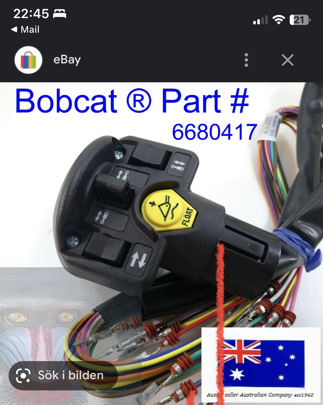

The only things I can come up with is that the lift Joystick or the ACS controller cause the problem. The actuators moves once when I put the ignition in on before the ACS light turns on. Can the joystick be the problem? When I tried ignition on before connected the joystick I got code 32-24 ACS Controller Calibration Performed and that is why I think the ACS controller is okey and it's the joystick or something else.
Do you guys have any idea?
Edit: I have these kind of joystick and forgot to mention that they are stuck sideways and the floor pedals are also stuck.
