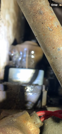

I have found that I have a very serious leak that is coming out the cap at the back of the tilt spool valve. The cap has a small hole in the centre of it. The leak is not a drip or a weap but a serious jet of fluid when the machine is running. Is this likely some sort off o-ring or seal? If someone can point me in the right direction I will try and order the parts and fix this myself. I live in France and don't speak the language so trying to get help here won't be easy + much more satisfying if I can do it myself.
Once I have managed to repair this I will replace all the hydraulic fluid, are there any other hidden filters other than the main hyd filter at he rear, to the right of the motor that I need to replace?
Thanks for any help.

Here is a link to the parts list:
https://partscatalog.bobcat.com/
Hopefully you can open it in France. Otherwise you could try to use a VPN linked to the US and it may work.
