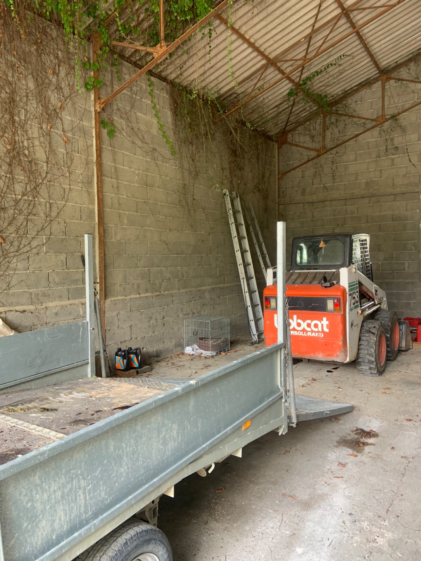

I have owned this bobcat for about 14 years and it has never given me any trouble other than once I had a condensation build up in the fuel tank.
Yesterday I lent to a friend in a neighbouring village so he could shift some soil. After about 1 hours work he said the bucket movement slowed down considerably and then shortly after he lost drive as well. After climbing out the machine he saw that he had left a trail of fluid along the 30 metre track. Now the machine is stuck and will not move.
If I put some hydraulic fluid in it will I be able to start it up and drive it straight on to a trailer?
Do I need to bleed anything?
How much fluid do they hold?
I have just changed the hyd fluid in my Kubota tractor so I have the old 10 litres I can use to hopefully get the bobcat moved.
Any helped really appreciated as its stuck in a really awkward place.
Cheers.

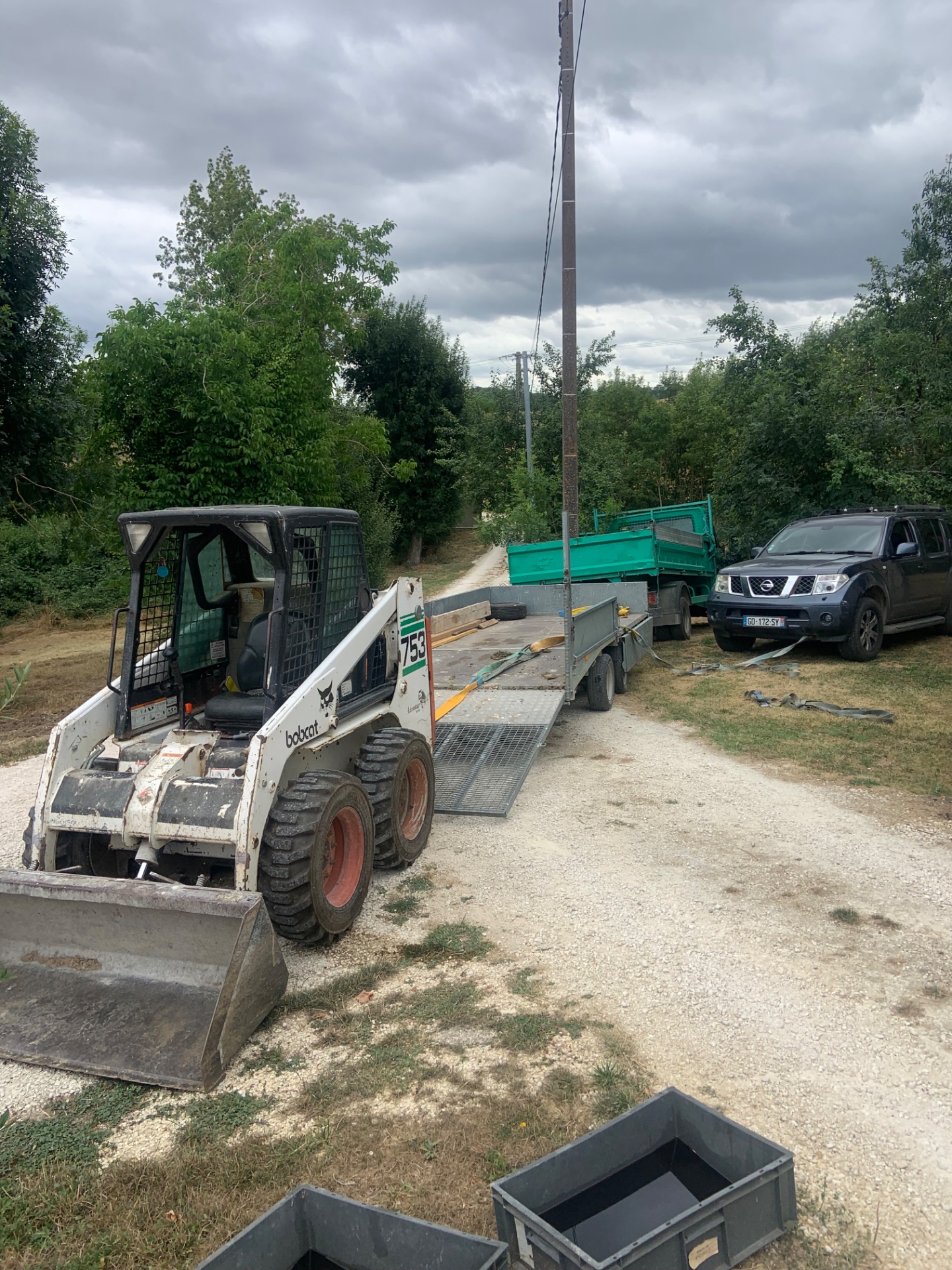

I had a similar situation one day on my little Daewoo. I was just pulling out my side by side from a mud pit after a rain and as I rounded the corner the drive became sluggish so I had the foresight to jump out and open the rear engine compartment door . At this point the motor was shut off but the problem became obvious. The hydraulic filter had been blown out at its base probably because of a build up of moisture. Fortunately although on a Sunday it turned out to be a thirty minute $50.00 fix thanks to NAPA , good luck with your search!
Thanks everyone for your help, especially Mrbb for such great detail.
It has taken me the whole day to recover the Bobcat and get it home.
I managed to tow it up onto the trailer, and once home it rolled off my beaver tail trailer with a little persuasion.

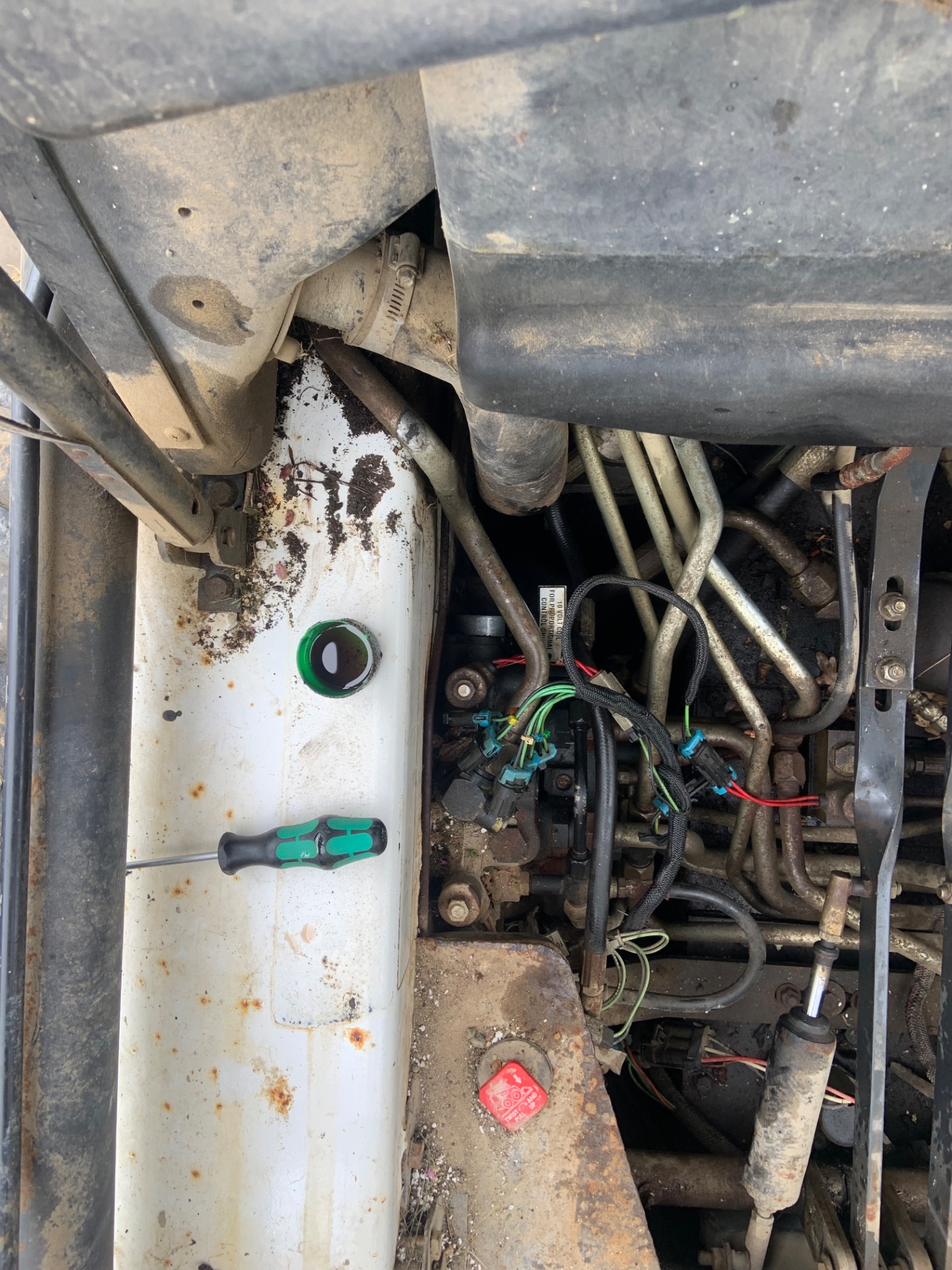

I lifted the cab and had a look around, unfortunately couldn't see anything obvious, although it's definitely the right hand side of the machine. I then took the cover plate off, from between the wheels, looking inside here I saw what looks like a green lid (looks like the lid from a shampoo bottle). It was just sat there on the bottam, about 6 inches to the left, and it was full of hydraulic fluid. You can see the green lid in the photo and that is roughly thow far back it was found, but obviously under the pump/motor or what ever that is under that bunch of electrical connectors.
So that's where I am right now.
Thanks again for all the help and any advice for my next step would be hugely appreciated.
She is a Bobcat 753 G-series 2000 serial 516220519 and has done just under 2000hours

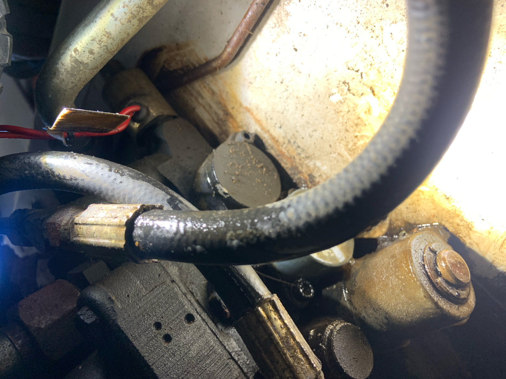

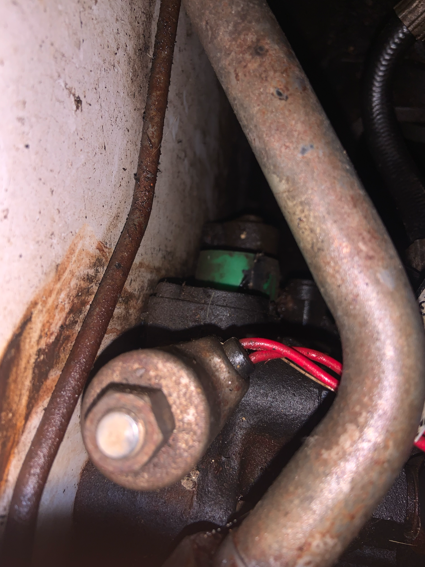

Is the bucket positioning valve what you can see in my third photo above? in line with the screwdriver handle?
Many thanks

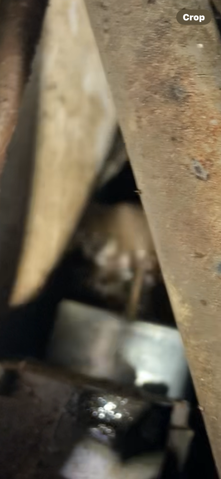

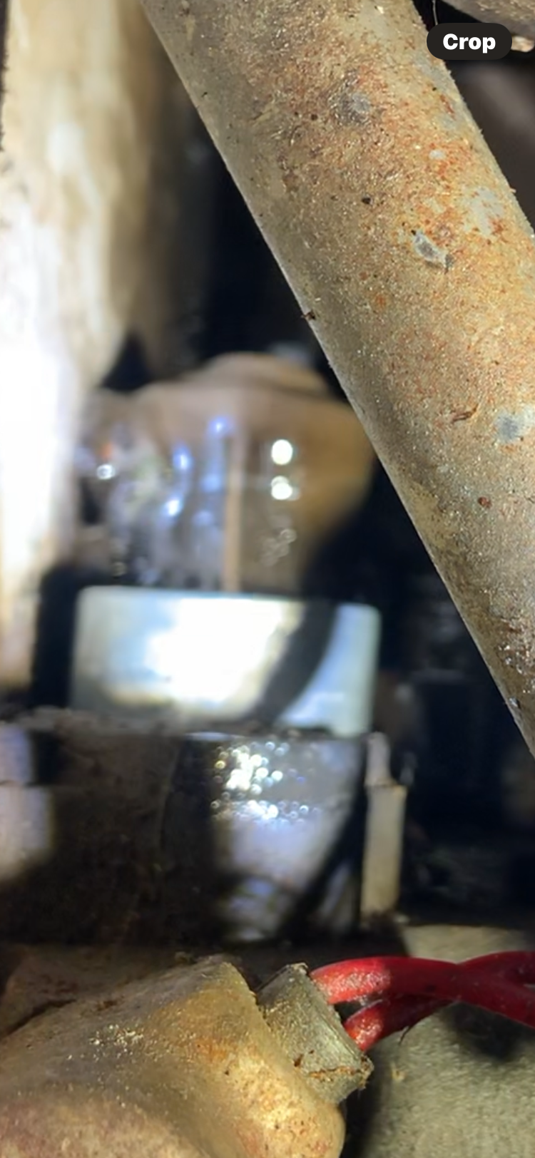

I still have not managed to find the leak. I have been cleaning and doing some electrical wiring repairs until I can get to the shop to buy some more fluid. How much would be a safe amount of hydraulic fluid to put in to help find the leak, I know that I will loose it fairly quickly, so don't want to waste too much.
Having studied my ow photo above I noticed that there was something that stood out as being so much cleaner than everything else, and sure enough that green cap fitted it perfectly, and was obviously on it until fairly recently.

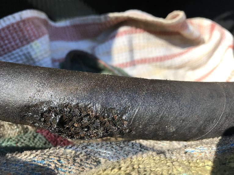

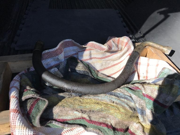

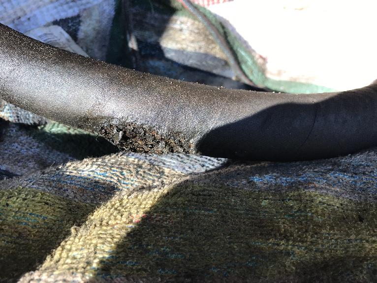

Sounds exactly like what happened to me a few years ago. Long story short, you've blown one of the larger hoses.
Tilt up the cab and look down both sides and you should see a nice deep pool of hydraulic oil on one side (mine was on the right from driver's position). The hose connections on the back are miserable to get a wrench on - I had to buy stubby 1" and 1-1/4" ones to get the fittings off and to put the new line on. I'll see if I have photos of it...
Sorry, no photos of the leak or work. Only a photo of the blown hose - the leak is subtle - hose was totally intact but the outer case was worn thru from long hours working.
    89.7 KB
    99.9 KB
    103.6 KB

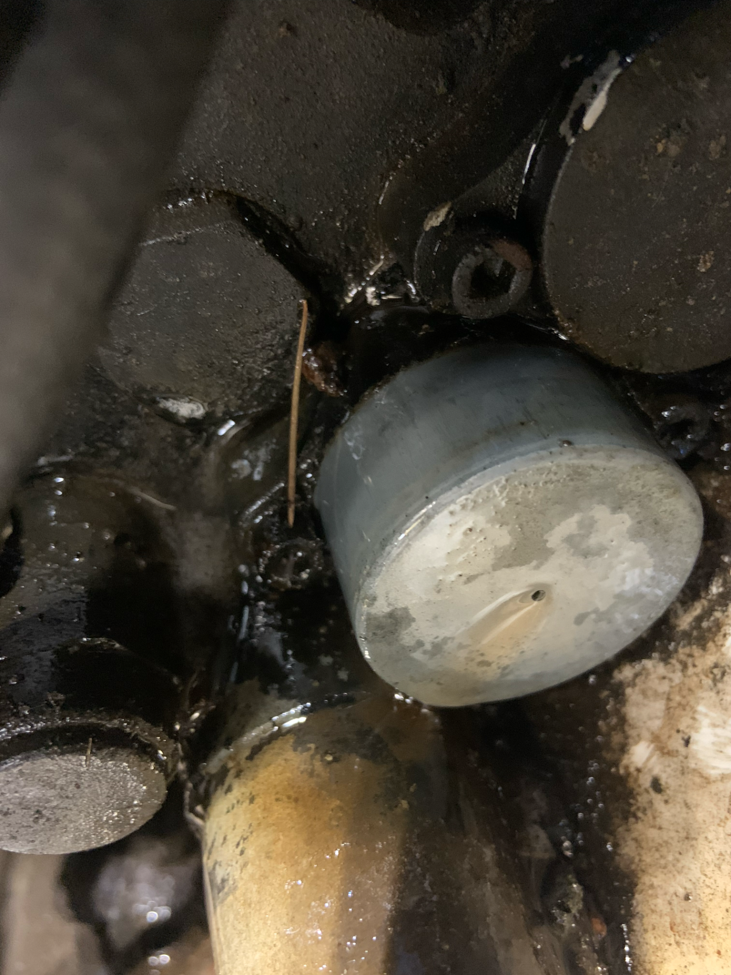

5 months later I finally found some time to try again to find the leak. As Mrbb suggested I put in 7 litres of 10w/30 oil, lifted the cab, I then started her up and after about 30 seconds the leak was very easily spotted. It gushed out with such force. I think it's the valve that controls the tilt and lifts the arms. It is where the green lid was fitted in the above photos which I posted in July. Here are some photos of the oil leaking through the small hole that is in this end cap. Im hoping someone will be able to tell me exactly what part this is and what seals or O rings I will need.
TIA
