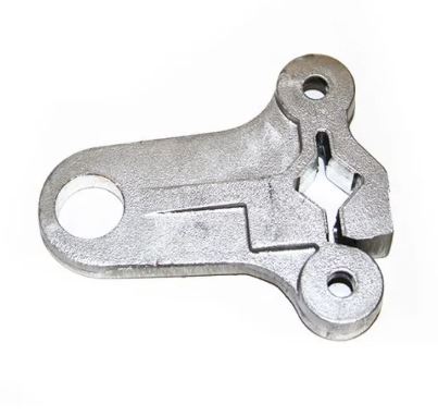

It looks like all 753's have manual control hydrostats. I would take a look at the lever on top of the pump. Check for wear or cracks. You don't want it to be loose.
