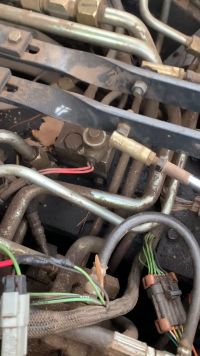

Bobcat 753 auxillary control work around.
WK Carlson
Oct 1, 2023
8
I have attached a short video of what I did to get my grapple working until I can get into the dealer for ACS replacement. I neglected to take a pic of where I taped the 3-way switch. It is taped up under the cross arm on the left side and I use it to switch between solinoids. Like said a little clumsey but it works. I will be taking the machine in for the replacement within the next month and hopefully that will get everything back to normal.
thanks Bill c.
  • 753 wiring video.mp4
    16.2 MB
I just bypassed all the factory wiring and put a dpdt switch on the handle and wired it to the solenoids. I did put it a switch that deactivates it.
