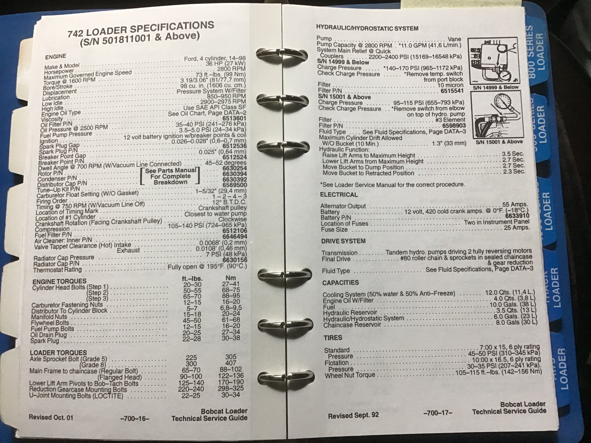

It should be 3.5-5 PSI.
I had my 742B pump go bag recently. It was still pumping fuel, and once it stated it was fine. But it was a beast to get started with low pressure.
I have attached the specs page that I have. You can find the fuel pump pressure about a quarter of the way down the left page.
