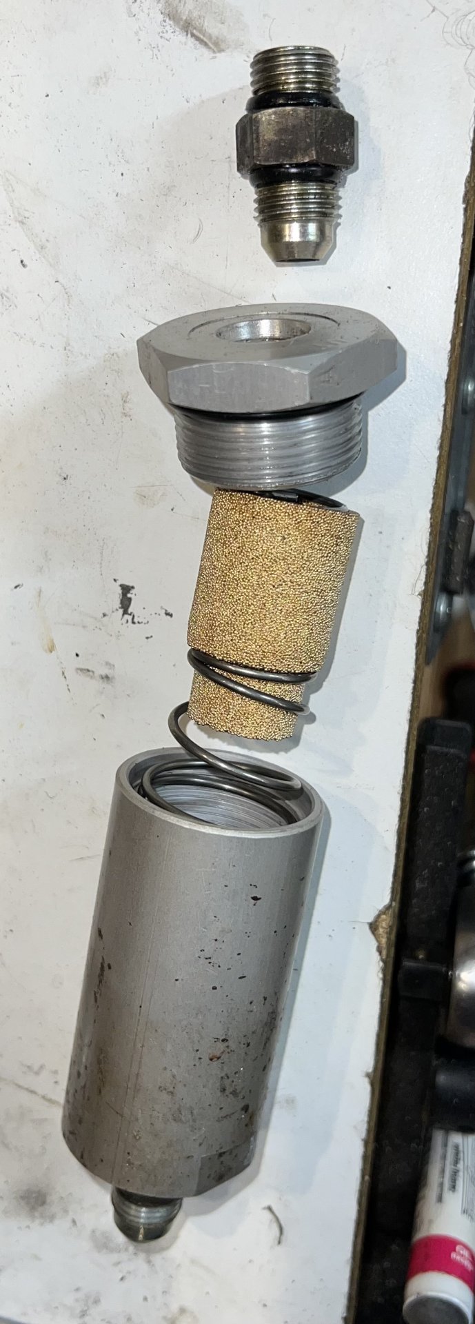

Any advice on getting the fitting that holds this thing hides behind broken loose would be greatly appreciated. Things I've tried......
  • Socket - Nut fitting so thin it just kept popping off. Tried putting a bar clamp on it but nothing to clamp to
  • Impact hammer - not nearly enough room
  • Thin 1 7/16 wrench - Fitting was rounding off
  • Screwdriver bfh method - Groove in the fitting but blow after solid angry blow failed to break it loose
The port block fittings on either side broke loose easily though I was only able to get one out of the way due to the fact one is a 90deg. Bought this thing at auction and rebuilt the engine (Deutz F2L511) myself. Engine runs great but machine seems sluggish with or without the lightweight over the tire tracks I put on it. Nothing in the manual about changing this filter even though it shows it in the hydraulics diagram
Assuming the 731 uses the same filter housing as an 853, the picture below shows your choices for taking it out/apart. Definitely change the Boss o-rings while you have it out.

@wateka...... have a big plastic box with hundreds of O rings if I could just manage to break it loose. Not much experience working on these things maybe that's part of the problem. Thanks for posting the pic. Gives me an idea what it will look like.
@cdmccul....... I haven't tried a pipe wrench. My biggest issue is that the fitting does look a lot like the thinnest one in the pic wateka posted. I'd guess that 20% of it is recessed back into the port block. A terrible design imo. The thing really hasn't been that bad to work on but this makes no sense to me at all. I'll give the pipe wrench a try thanks.
