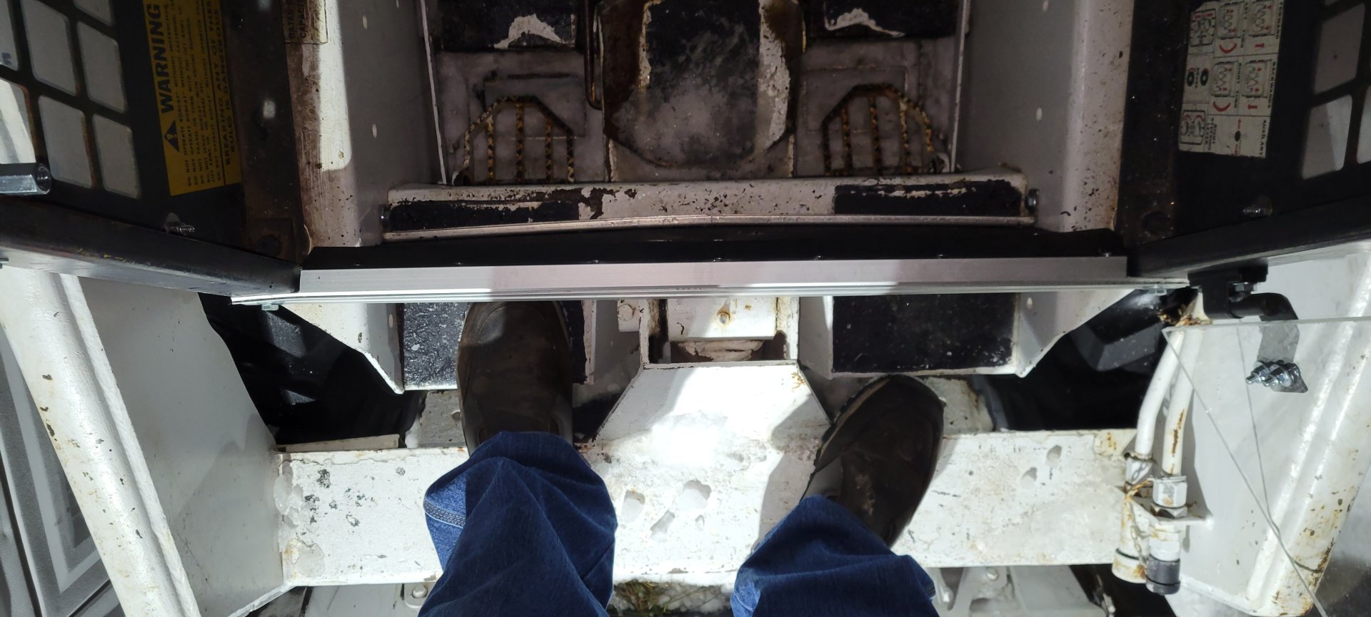

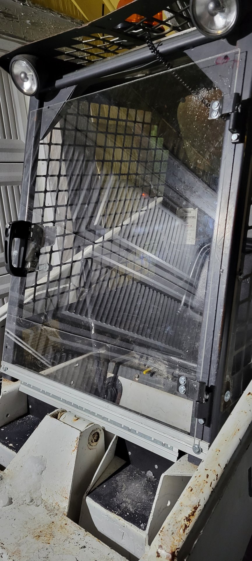

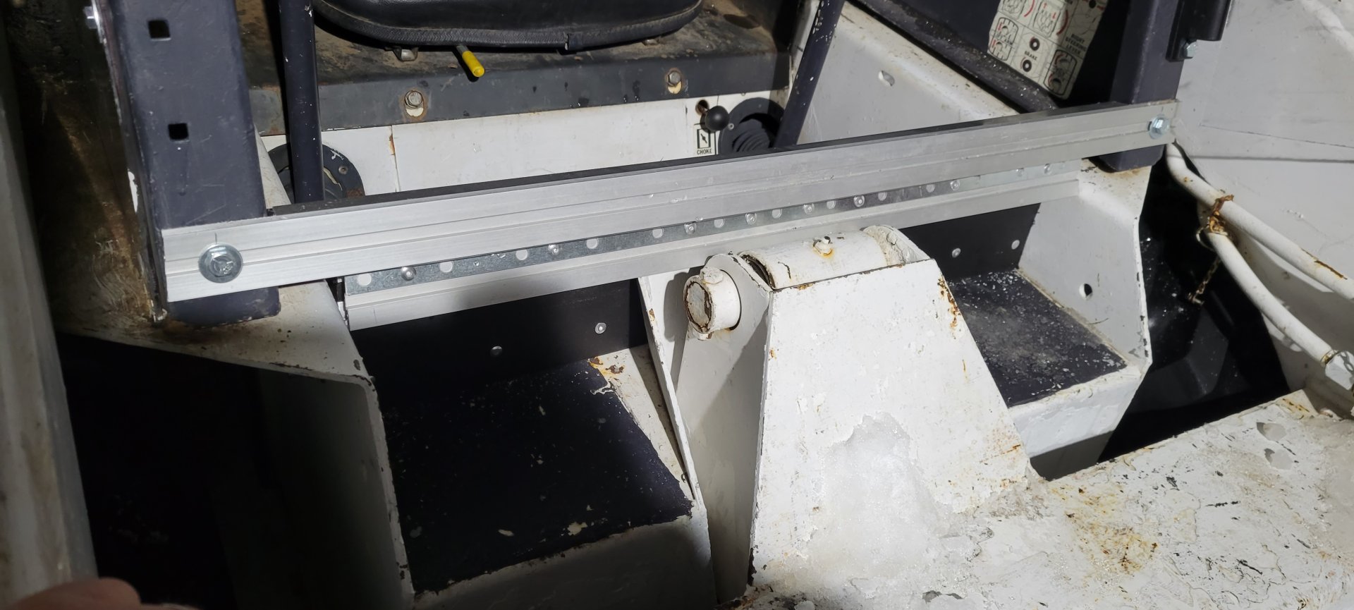

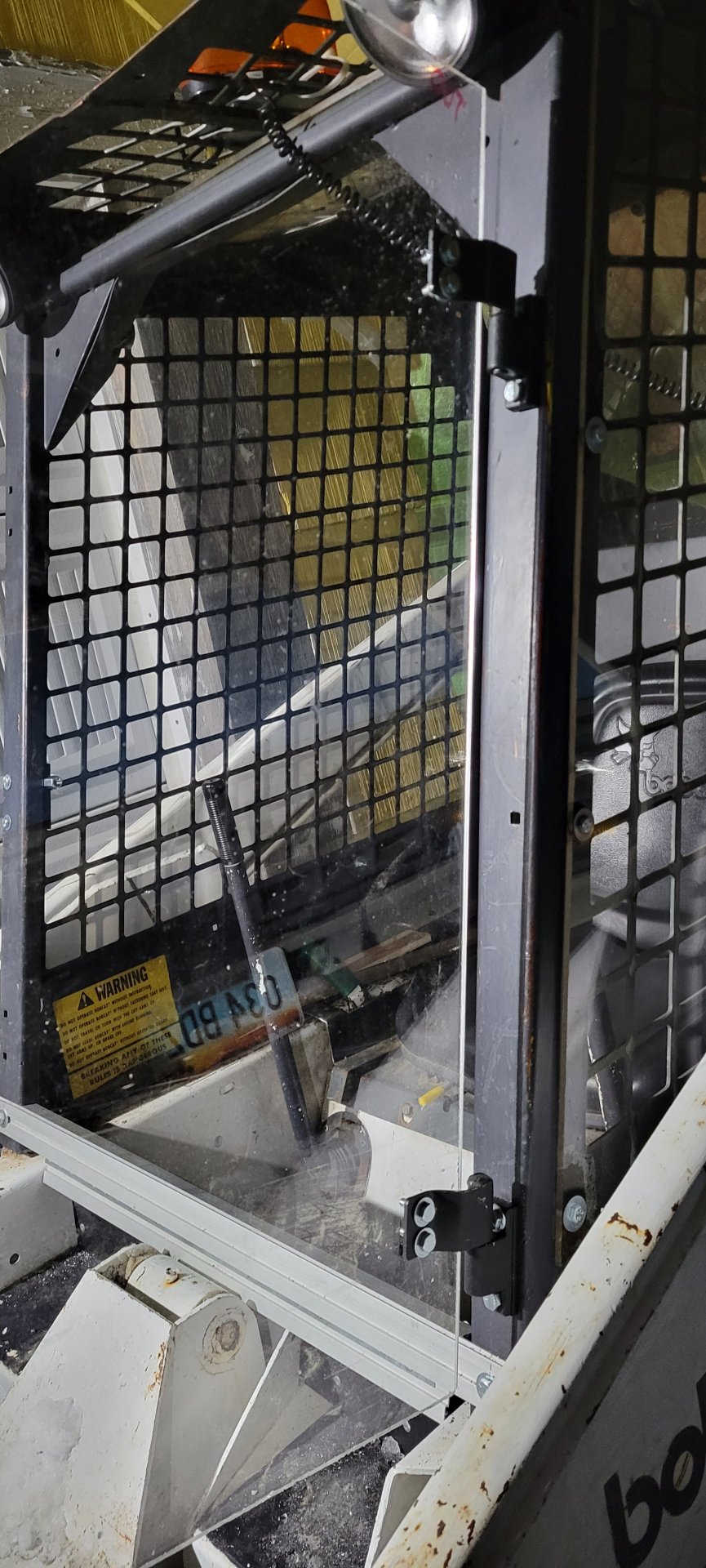

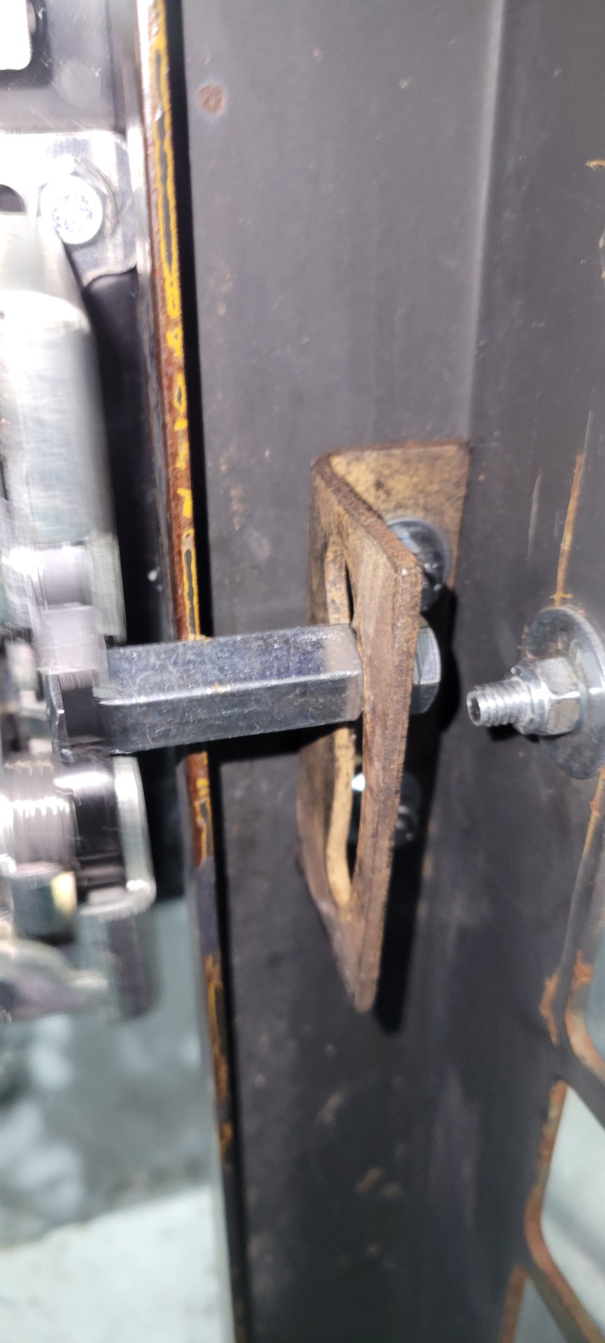

Well, I built my door. I screwed up some math, however. But, nothing a little redneck engineering won't fix!
Here's a few preview shots.
Happy to answer any questions.

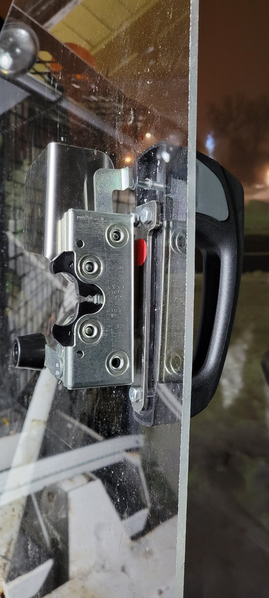

One consideration for building a door is “emergency“ exit.
I built my own door out of old Lexan from a police station remodel (3/4” thick, bullet resistant). One of the considerations that I made was to make sure that I could remove the door from the inside.
This came in handy when I had the lift arms up and a tilt hose blew out. The door kept me from being sprayed with high pressure hydraulic oil. The problem was that the blade I had attached was now in the down position and the arms could not be lowered enough to get the door open without flipping the skid steer.
Luckily, all I had to do was lift the door off the hinges to get out. If I had not designed the door this way I would have had to pop out the back window and then replace it.
The door hardware kit I used came from "skidsteerdoors.com" (was overstock or otherwise unused hardware). It included half barrel hinges. So yes, all I have to do is pop the door latch and then lift off.
