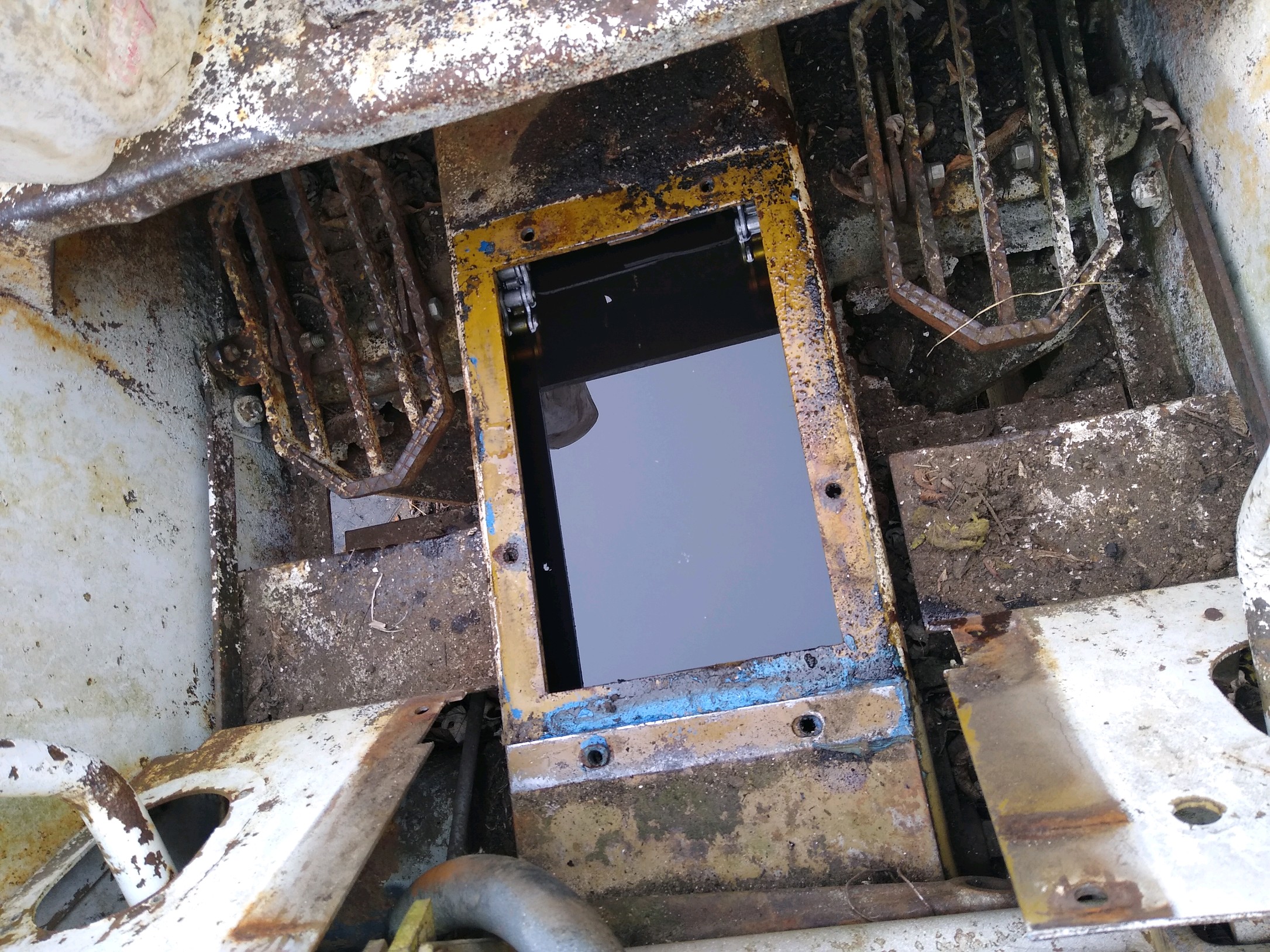

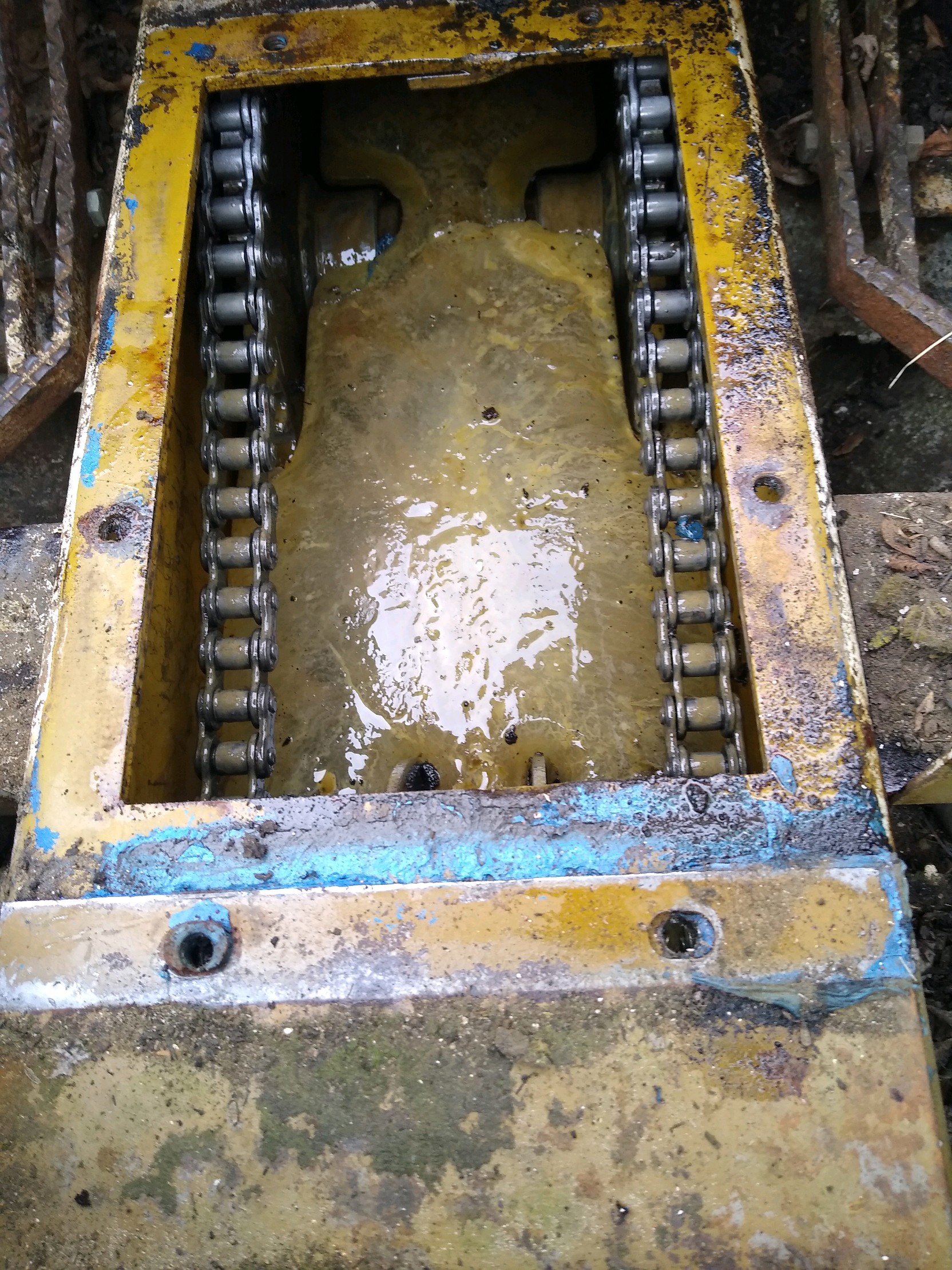

Well sure as heck.... Looked clean but over-filled. He popped the drain plug, nice clean clear water drained out, followed by oil. Now the wheels turn until the chain slack is taken up. He said it appears to be mostly clean inside now that the giant block of ice has melted. Going to let it dry as much as possible and try flushing it. Pictures attached.

We have no idea how the water got in though. Gasket was good, and it wasn't submerged or taken in deep water high enough to get in Will investigate more.
Glad you found the issue. Bobcat uses a special caulk called "Mat 10" to seal the cover back on. Done use a gasket which may have been standard back then. They are foam and will let water seep in causing, well you know what. Any good sealer should work, NAPA most likely sells something good also. Make sure to seal around the bolts good too.
