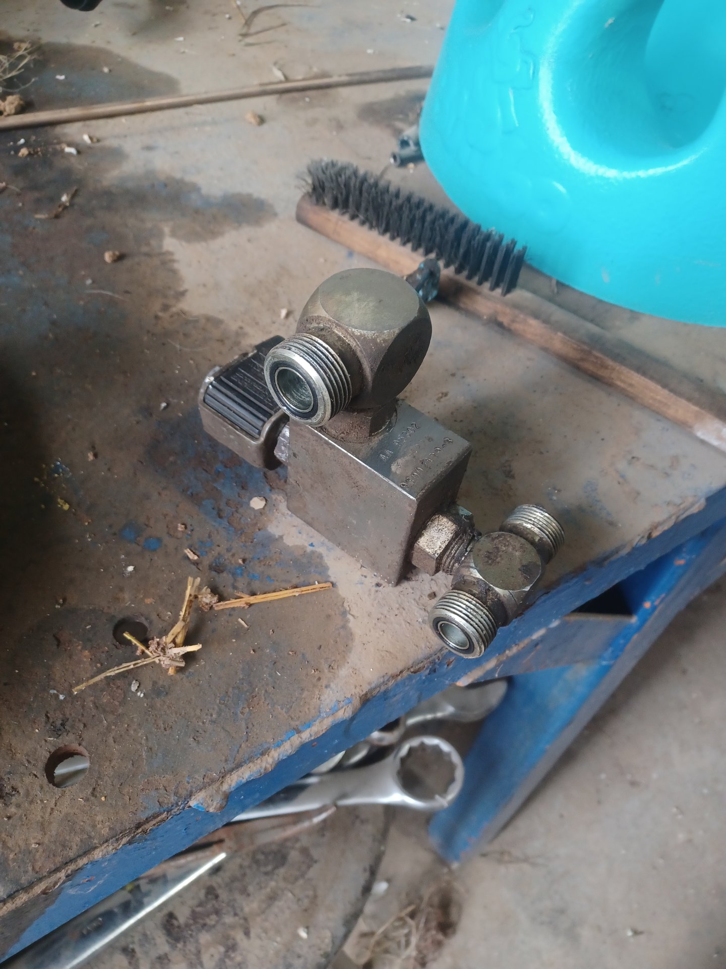

Could be blocked line, lose the hydraulic lines on the ether end of the bucket and run machine briefly, to check and see if oil comes out and or air. If that is all good check ur vale control flow silinodes..looks like the pic
    340.5 KB
If the bucket cylinders have extension force but not retraction force, almost certainly one of the bucket cylinders has the piston broken off the end of the rod.
