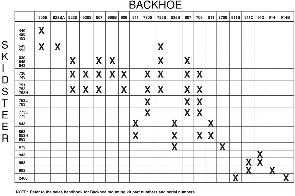

Can anyone tell me the differences between the Bobcat backhoe models available around the late 80's that may fit my 1988 843? I believe the models are 905B, 907, T906, 909, 911 and 913? Which ones fit my machine? What are the differences? Thanks.
spitzair
Dec 17, 2009
163
The one you want for your 843 is the 911. The 809 and 907 were for the 700 series machines and the 913 is for the 900 series machines. I am not 100% sure but the 909 might fir the 843, it is lighter and has a 9 foot digging depth versus 11 for the 911. There is also the newer 811 model that should fit your 843 as long as you can find the hook style frame mounts.

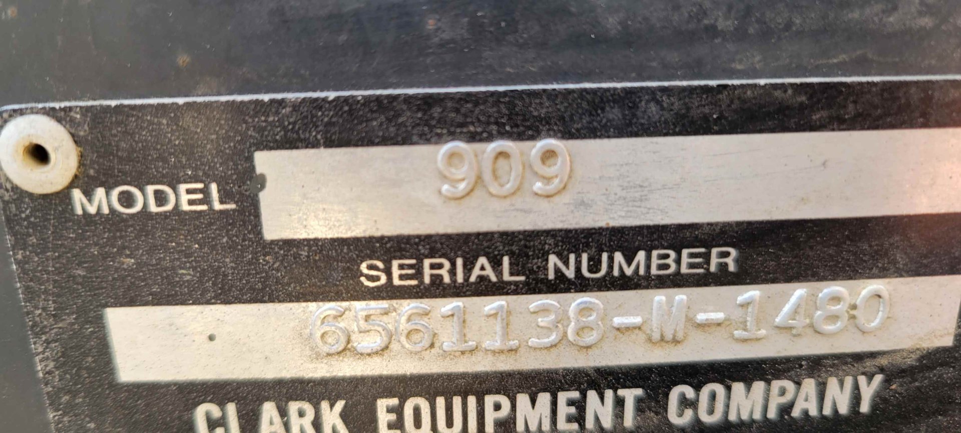

Sorry, my previous post should say the 909 and 907 are for 700 series machines.

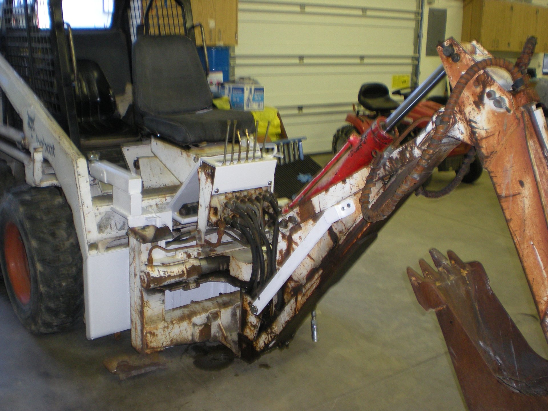

I Have a Early 843 and thought a 909 would fit but it does not so I can only assume the only unit that fits is the 911.

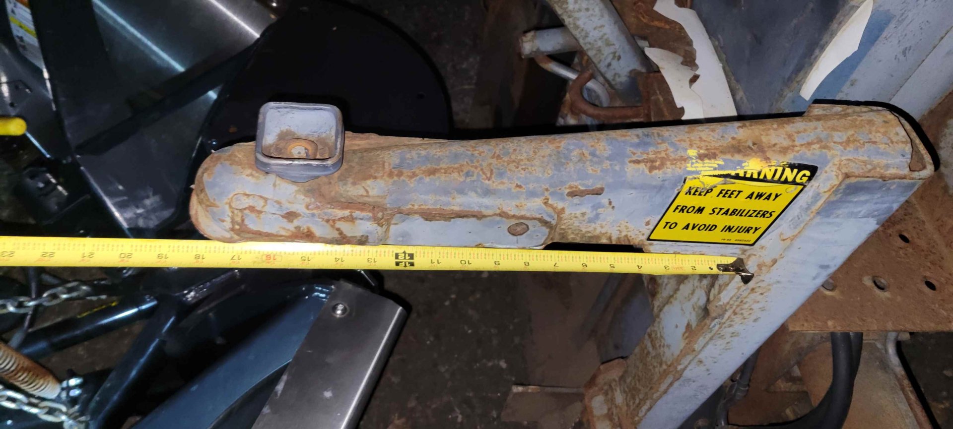

I'm in your same boat, I bought a 909 backhoe because I thought it would fit my 843 and it's too short to get to the balls. I don't have the option of finding a 911, so I'll have to re-weld those brackets.... Will you please measure your 911 in the places I'm showing in the photo (on my 909)?
I need the height from the *top* of the quickattach bracket to the *bottom* of the arm (in the photo it is about 8")
Also the length of the arm to the ball - from the face that faces the bobcat (that extends up from the quickattach), it'd be like the armpit of the ball - to the end of the ball. In the photo it's 15"
Thanks for the help! just redid all the hoses and cylinder seals and I'm bummed that it doesn't fit... doh!

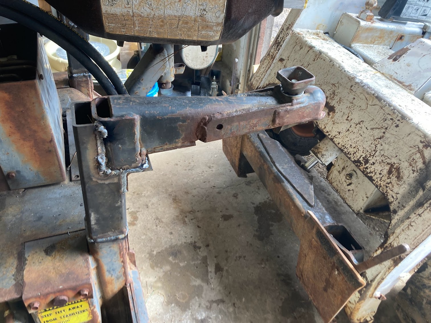

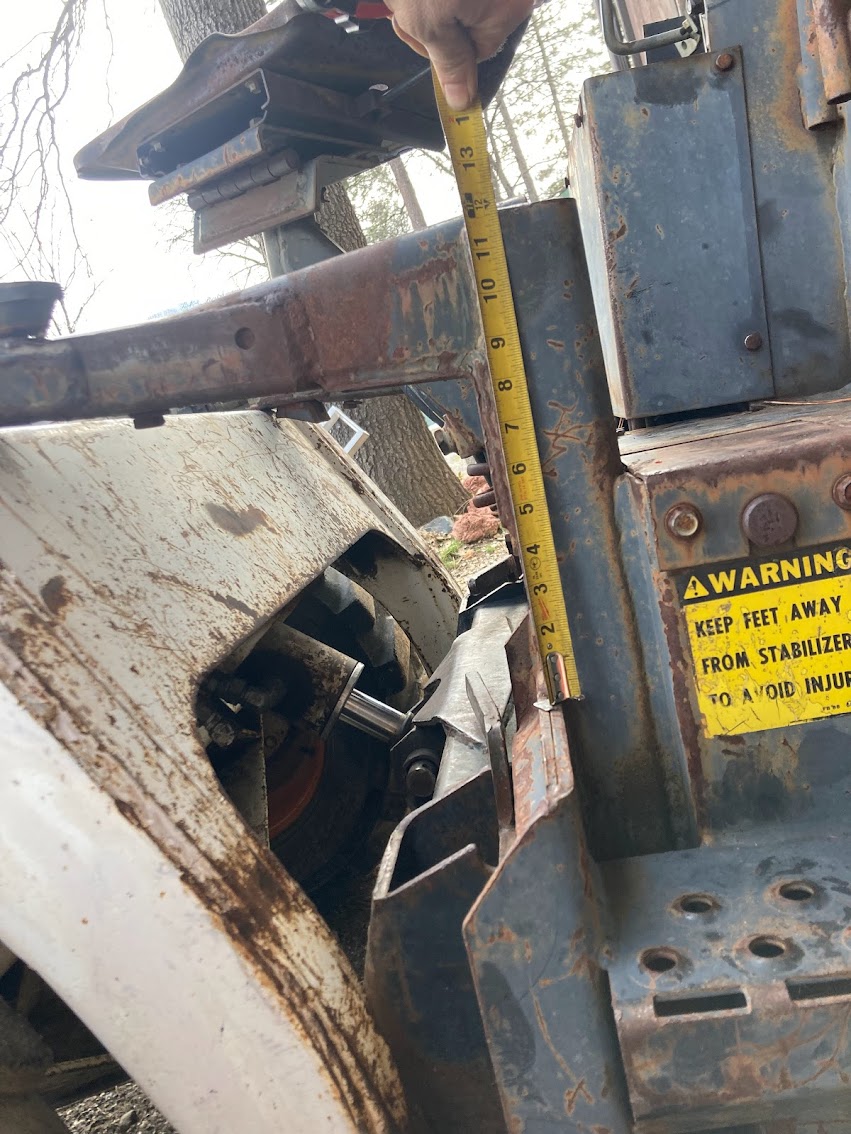

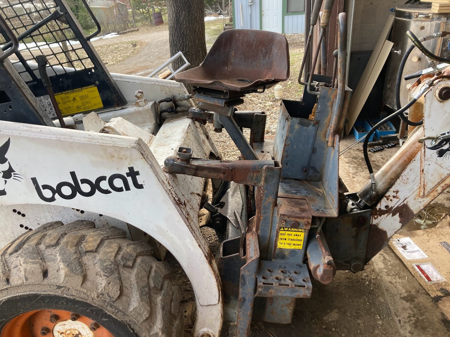

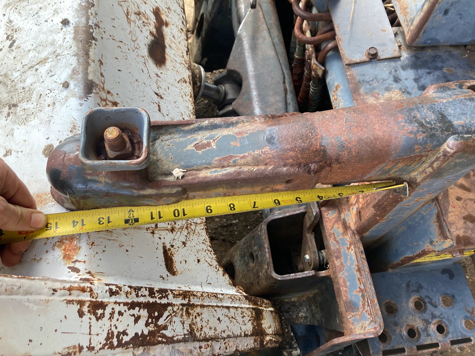

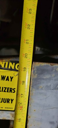

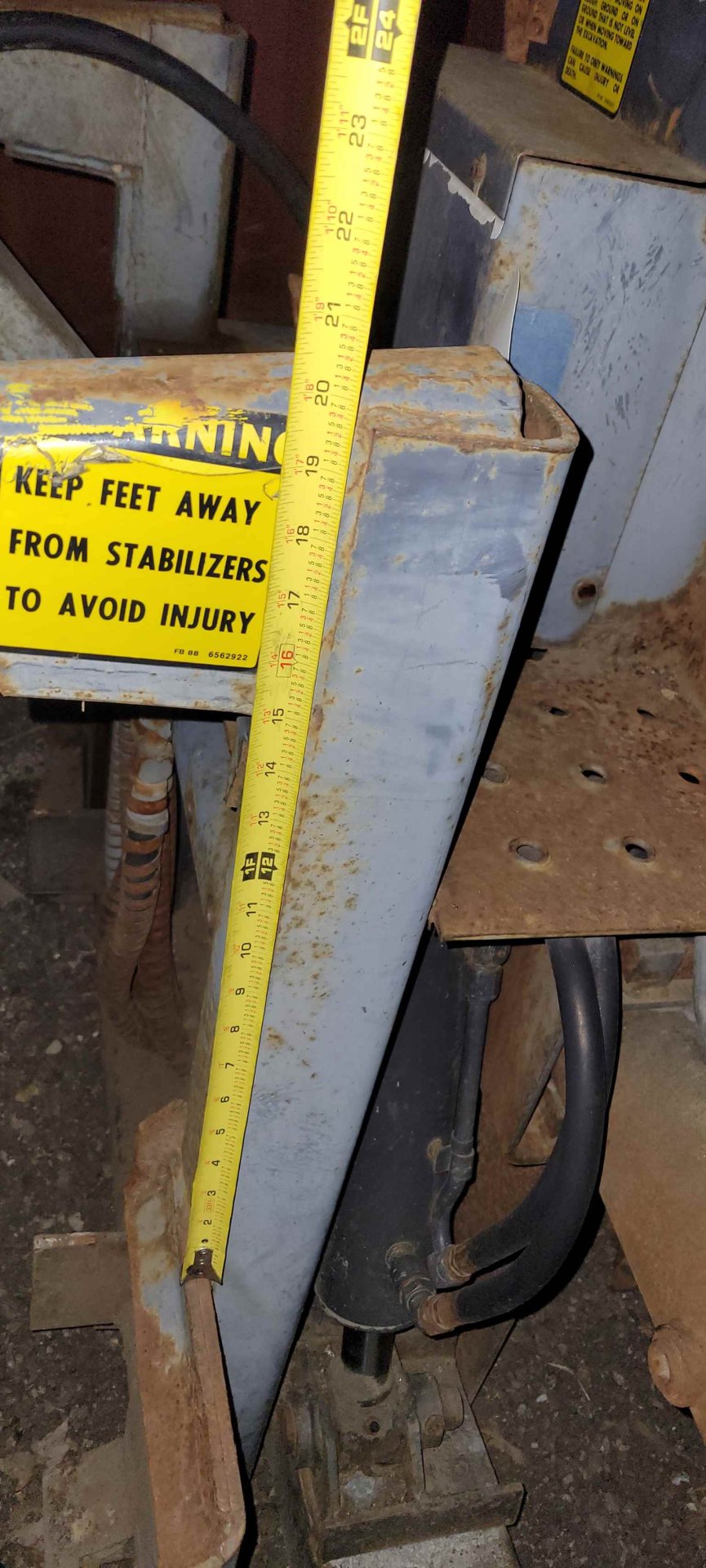

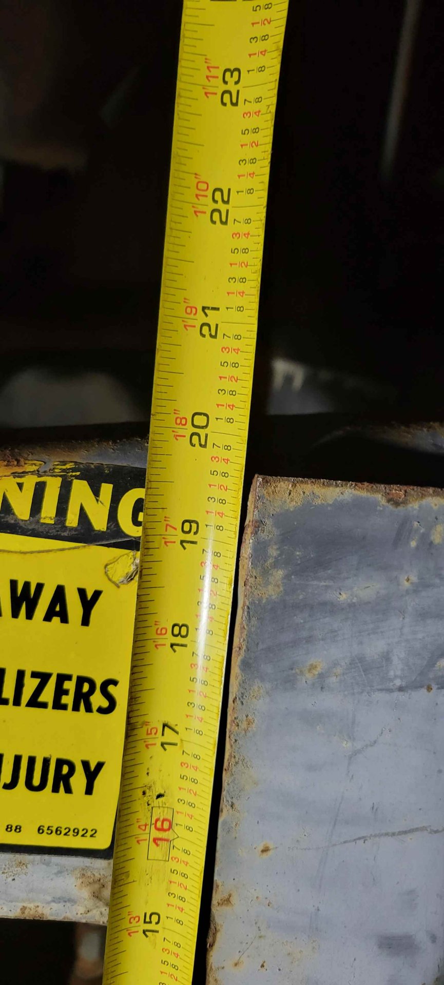

Hope these photos help you in your redesign these are of a 911 attachment

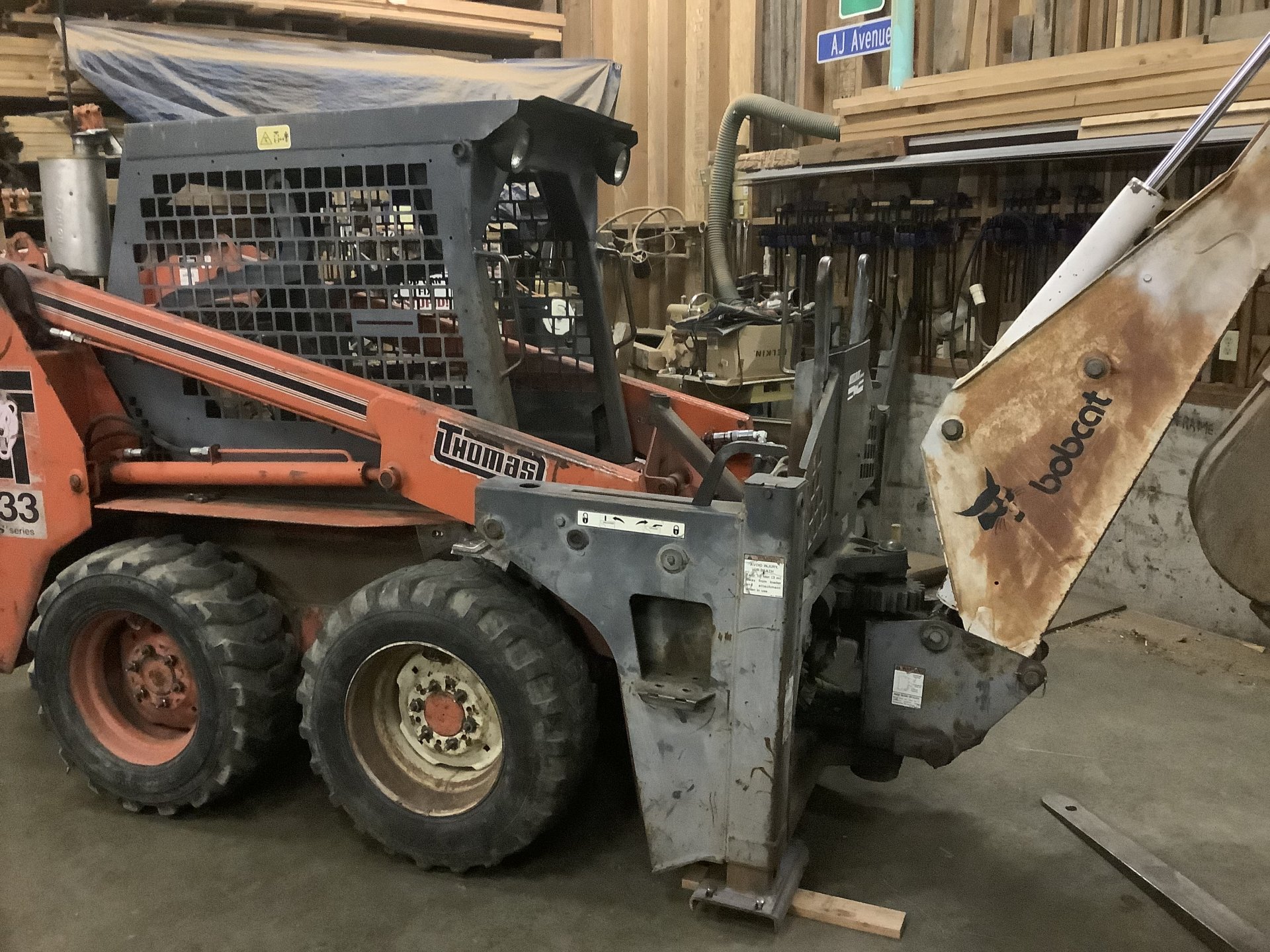

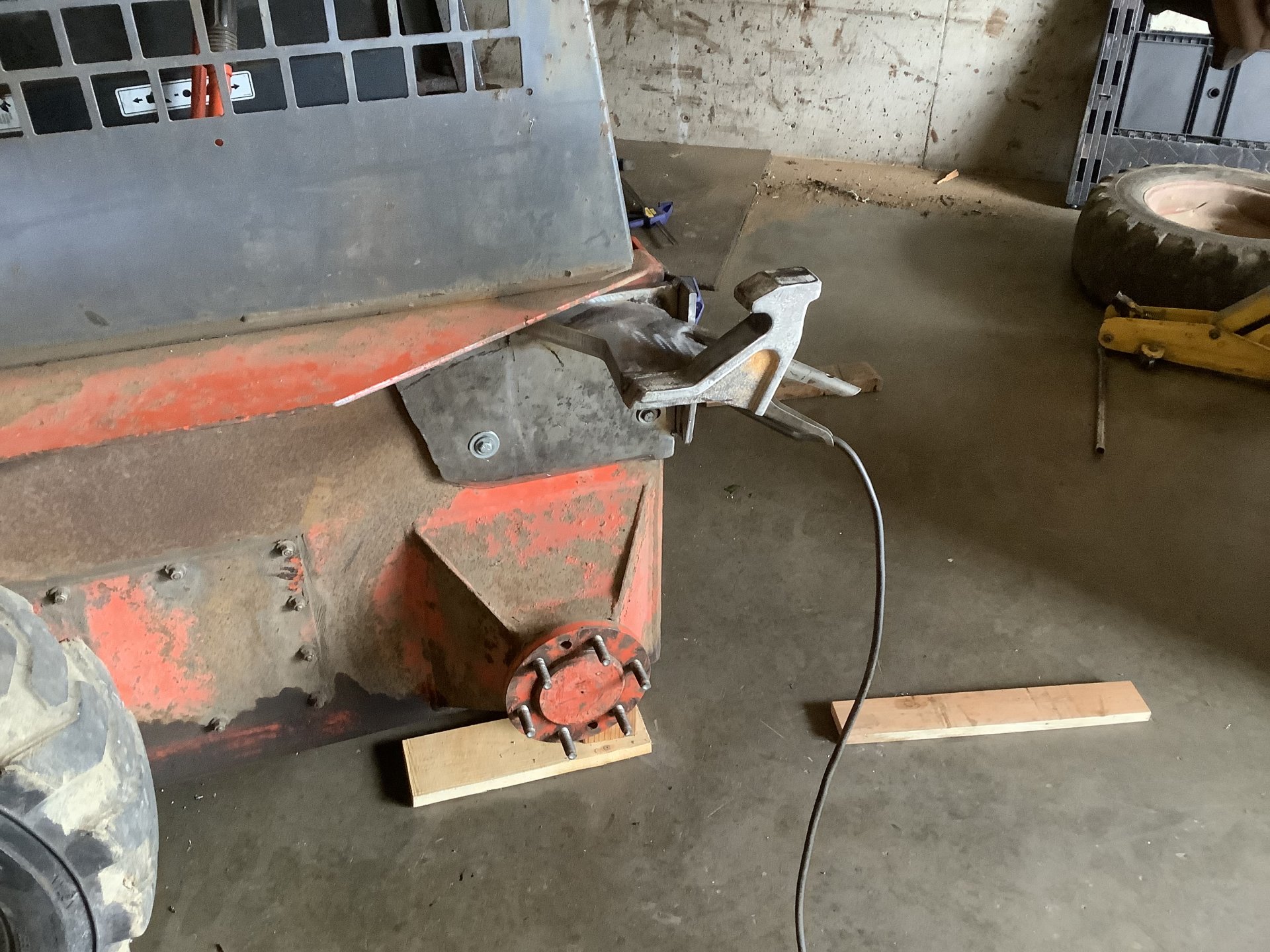

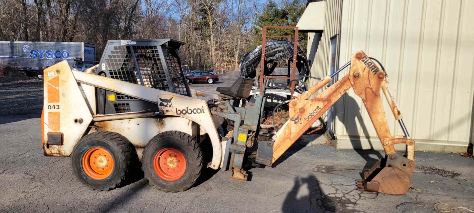

You guys have it easy compared to what have been working on over the last three days. Bought a 709 backhoe that was on a 2000 753 Bobcat last week and I am trying to get it to fit on a Thomas T133s. Have spent 20 hours cutting apart the brackets into individual parts. Then cutting, fitting, recutting, refitting over and over again I finally got the brackets to fit the Thomas. This was mostly 1” and 1/2” thick plates that needed to be cut and shaped, with all the holes that have to be hand drilled through the 1/2” thick side plates. Now that everything is fitted, brackets need to be removed and welded up 100% with my mig welder, cleaned up and reinstalled and hand drilled out to 5/8” holes for the bolts that came off the 753. When I looked up the price of the bracket kit from Bobcat, it was 1300.00 plus tax. I will NEVER buy anything directly from Bobcat for the backhoe. They want more than $750.00 for just seal kits for the cylinders and $1500.00 to replace the 18 hydraulic hoses that are 32 years old. Bobcat may be the largest manufacturer of skid steers, but way over charge for their parts. Even the decals for the 709 can be bought for less than 1/3 of the price Bobcat wants to charge for them. Sorry for the rant, guess I have never had to deal with Bobcat except for the renting of equipment over the last 45 years. I wish I only had the balls to deal with.
Be safe everyone.

Thanks very much for the photos Midwaycc - that helps a lot

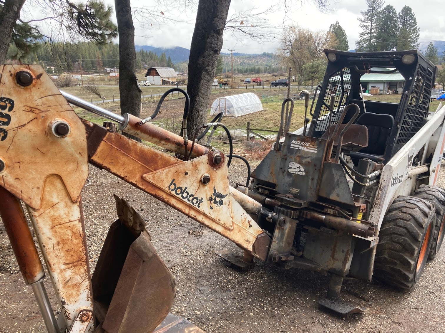

Thanks for the help on this. Hacked it together and it fits nicely. I'll have to keep an eye on the lower weld to see if it needs reinforcement, but it should be fine for how I'll be using it.
Now just have to wait for the ground to stop being so waterlogged so I can get some projects rolling!
