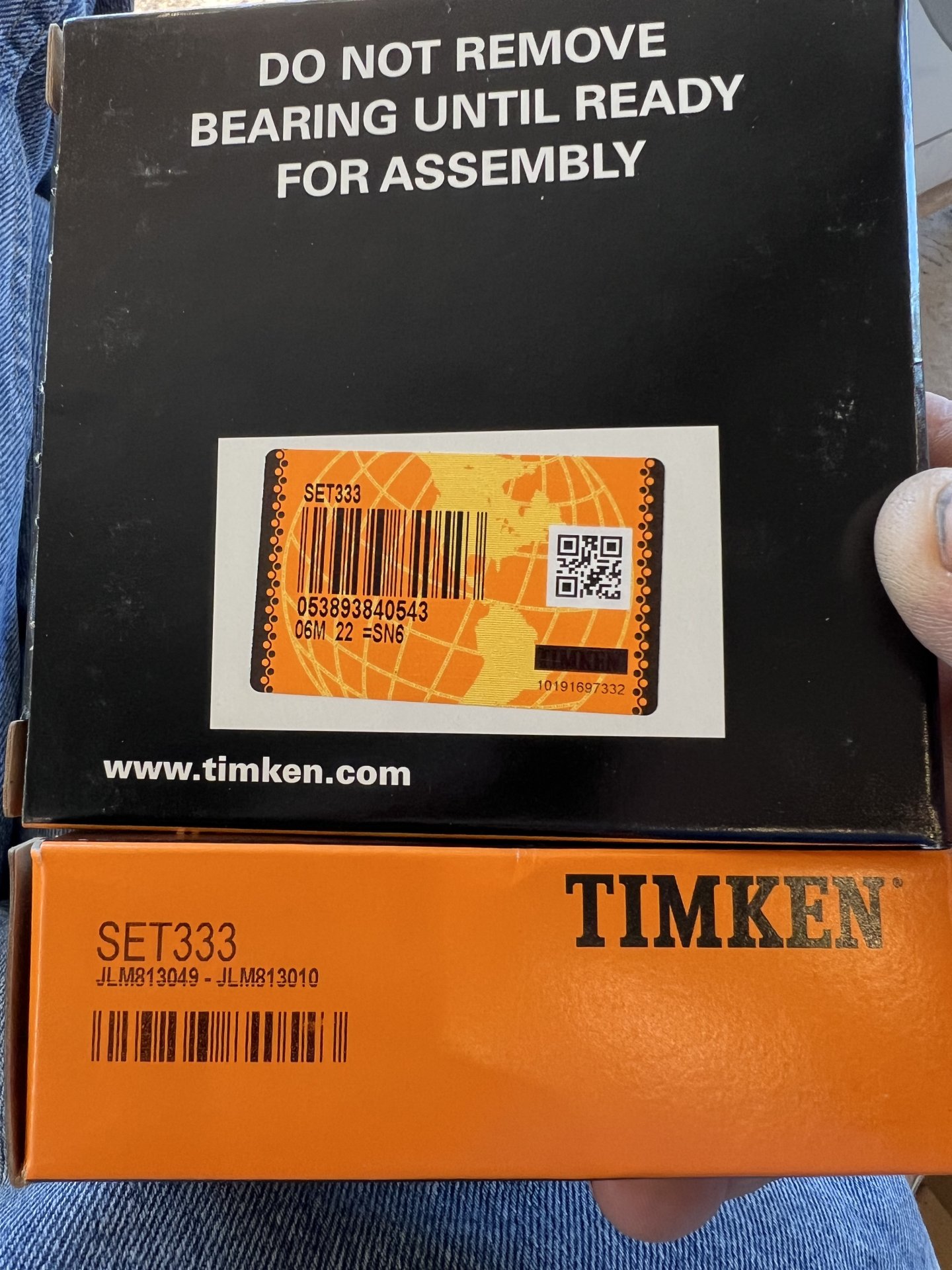

I’m replacing all 8 sets of axle bearings on my 853 and Bobcat has none available. If they did, they would be about $125 for the cup and cone or $1,000 for all 8 sets.
They are Timken metric bearings and the Timken part numbers are JLM813010 (cup) and JLM813049 (cone). They are sold as a pair in Europe in one box marked SET333. Some Volvo heavy trucks use them as well.
I could have found inexpensive import bearings on eBay but did not want to take the axles out again during my lifetime so decided to stick with Timken.
Google led me to Scotland and the very nice folks at Bearings Online. It was not quick because they did not have 8 in stock - if you have a deadline, and they are not in stock, this may not be your best option. The Timken warehouse is in France and Brexit issues really slowed things down. It took 24 days from order to arrival.
The price made it worthwhile. All 8 sets delivered cost me GBP433.60 which (today) is about $491 - less than half the cost of buying them here.
Gotta love a strong dollar if you’re importing.
