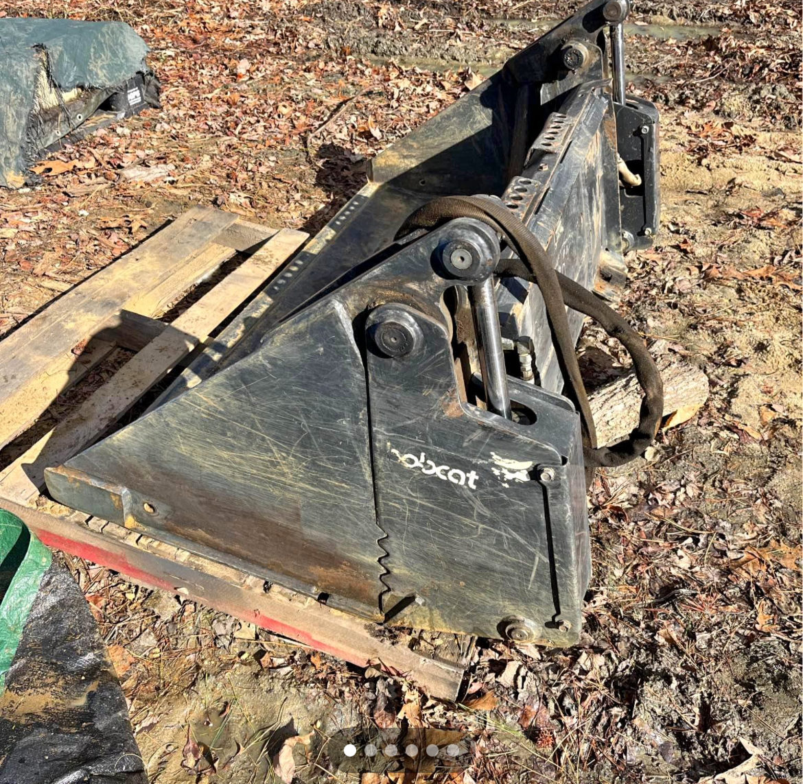

I have an interest in using some attachments, like a fronthoe and a 4 in 1 bucket. The 11 gpm flow of the 730 is lower than would be ideal for such attachments.
