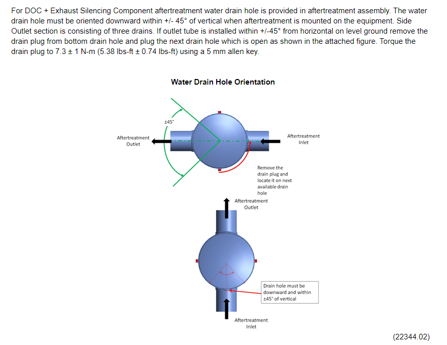

We rebuilt our unit for about $40,000 out of our pockets. New engine, wiring harness, and hoses. ASV and Cummins still have not provided any letter or documentation that as designed without a plug and with exhaust blowing into the engine compartment directly on the engine is not a fire hazard. Not sure if they intend to, however I have continued to request documentation and have yet to receive anything. Cummins did send out their fire investigator along with a Cummins rep however I have not received anything back on that either. In the field they said the fire was caused by the missing plug, however now they say that was only a hypotheses (guess they know who butters their bread). Other customers on other forums have reported they have found components are noticeably crispy in their engine compartment directly under the unplugged, open muffler port. I would like to protect the substantial reinvestment we have had to make rebuilding the unit and would not want to see a fire in another 200 hours.
