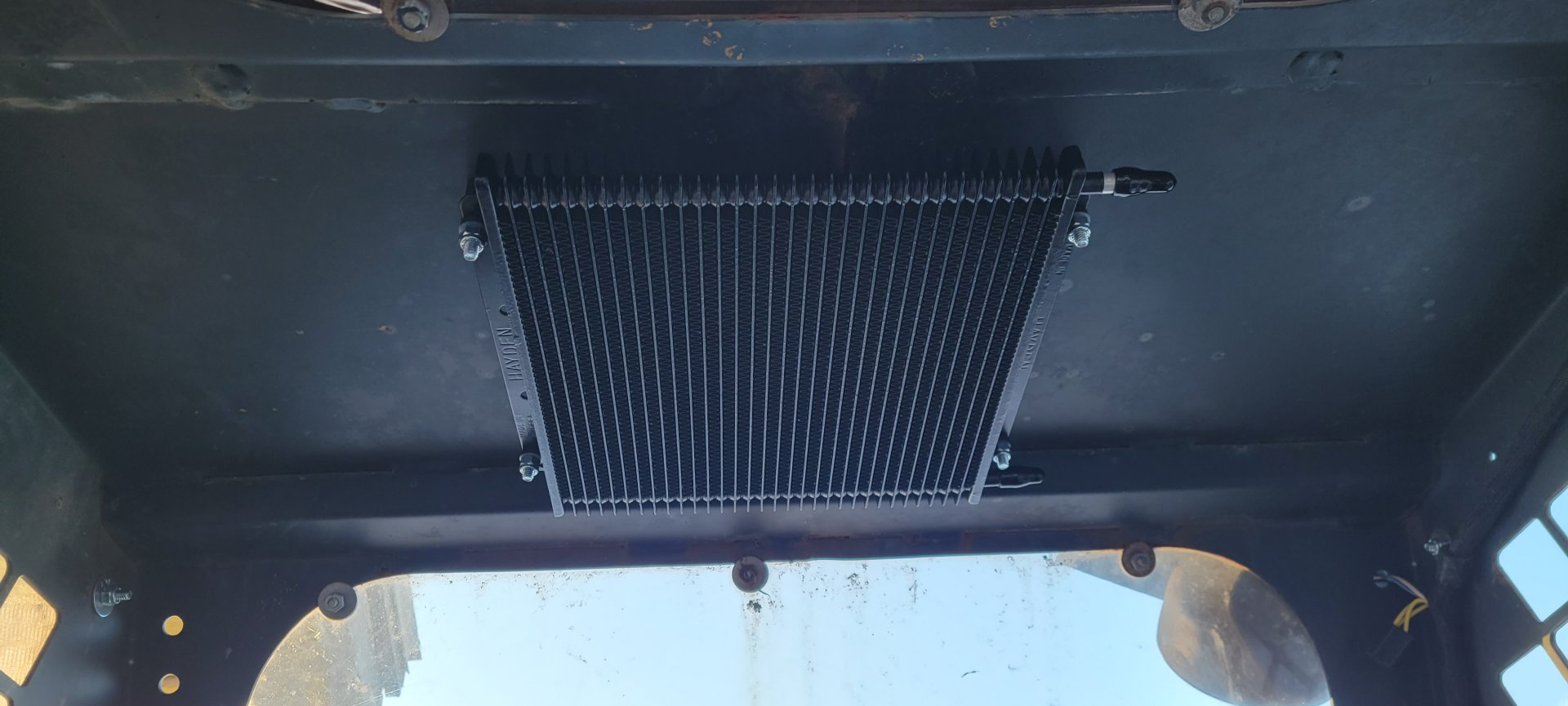

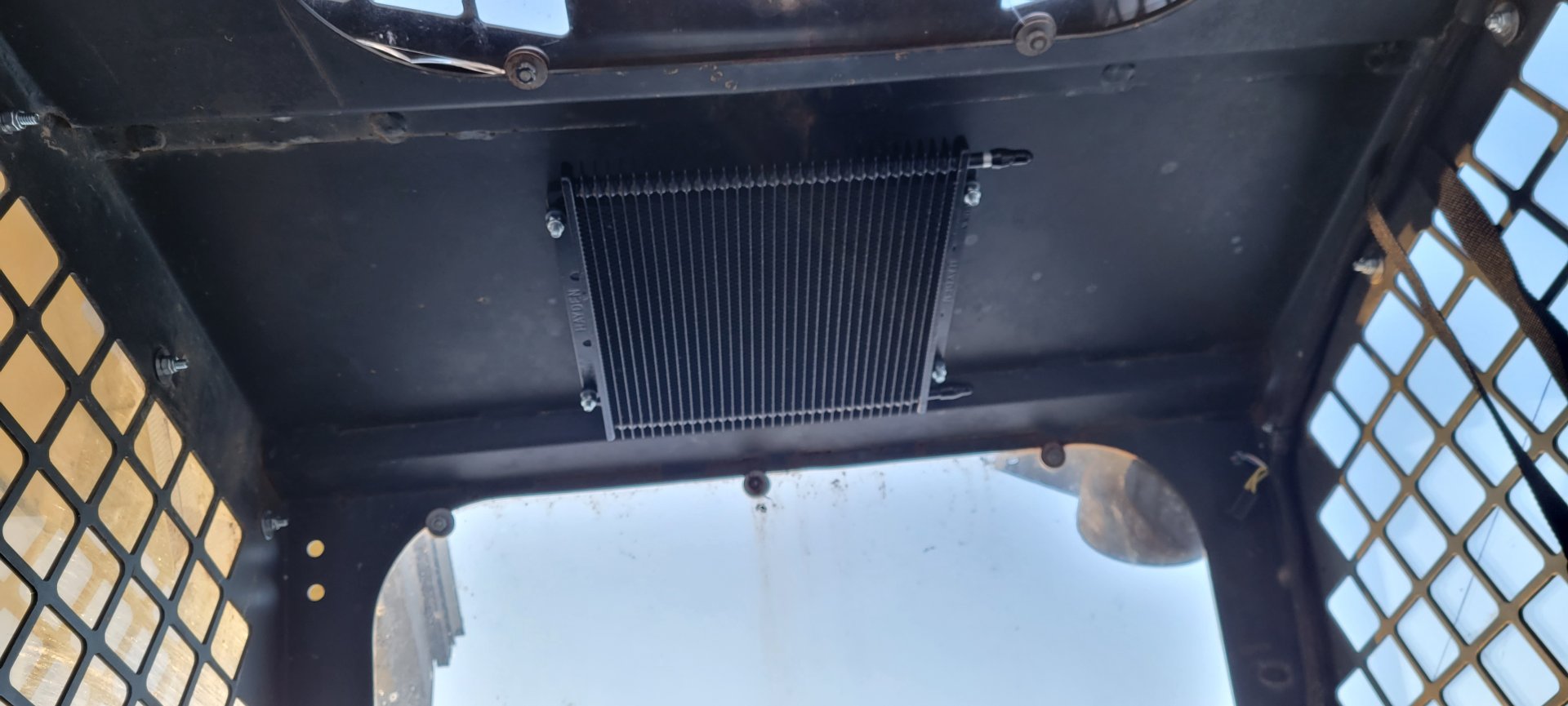

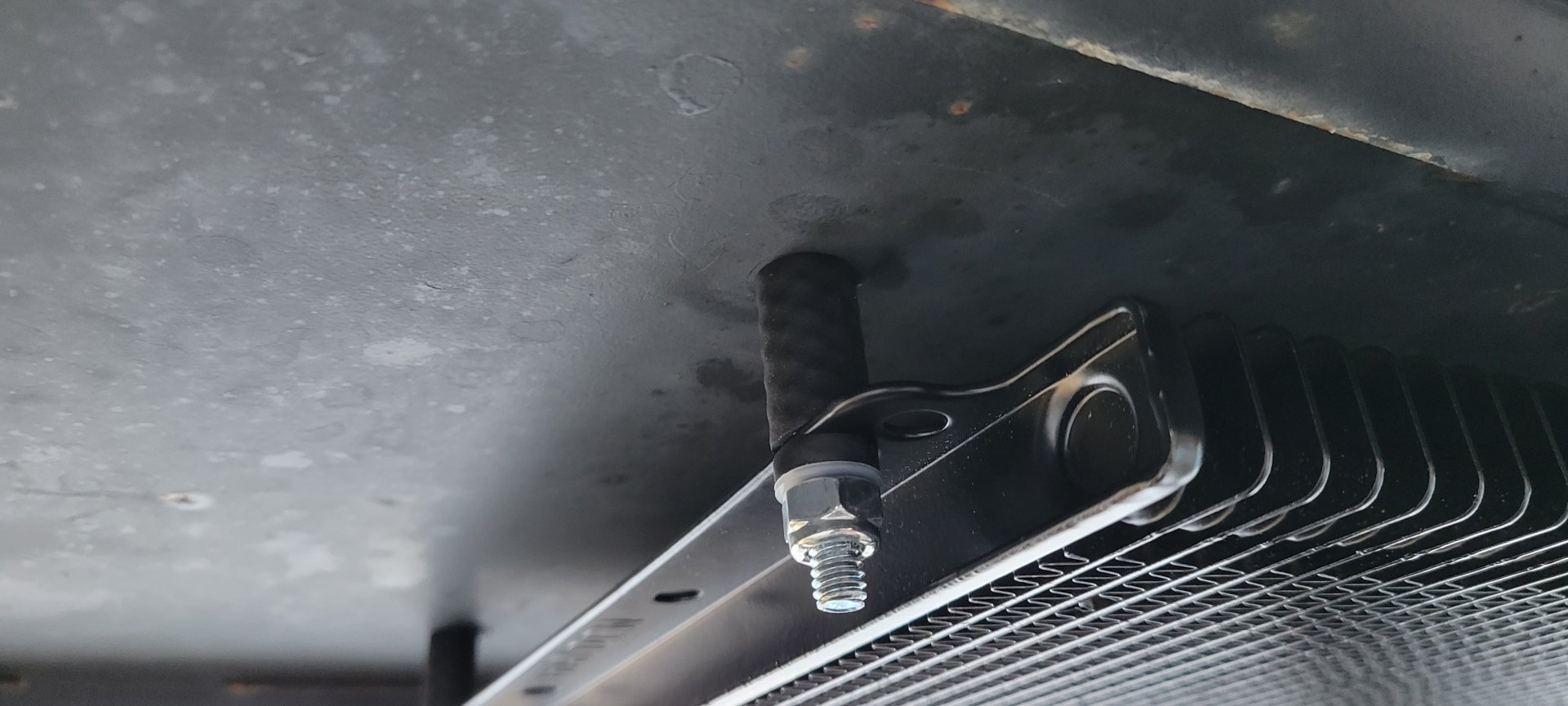

I'm putting up a heater in my skidder, 632 Bobcat. It's not done yet, but here it is so far...

Pretty good idea are you putting a fan ?

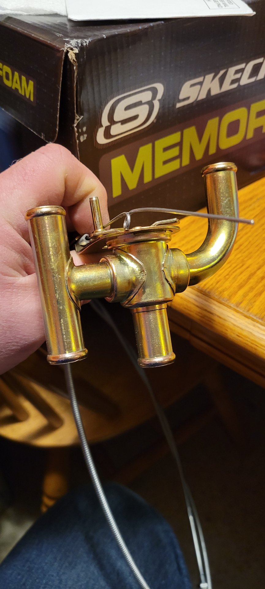

Yup, I have 10 inch push/pull reversable, with a switch to blow it down on my head, or up and force air down the windows. I also have a heater diverter valve that I'll be installing so that I can vary how much heat I get, so I can use just the fan in the summer.
I intend to do a writeup on it one of these days.
