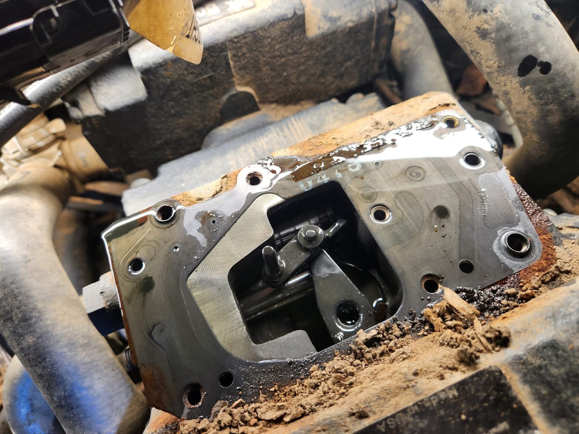

I was using my Bobcat A300 and out of nowhere the left side just stopped moving forward. The only movement I get now is in reverse and even that feels weak.
Before this happened, the left side was already acting off. It was slower than the right side and had a delay when moving.

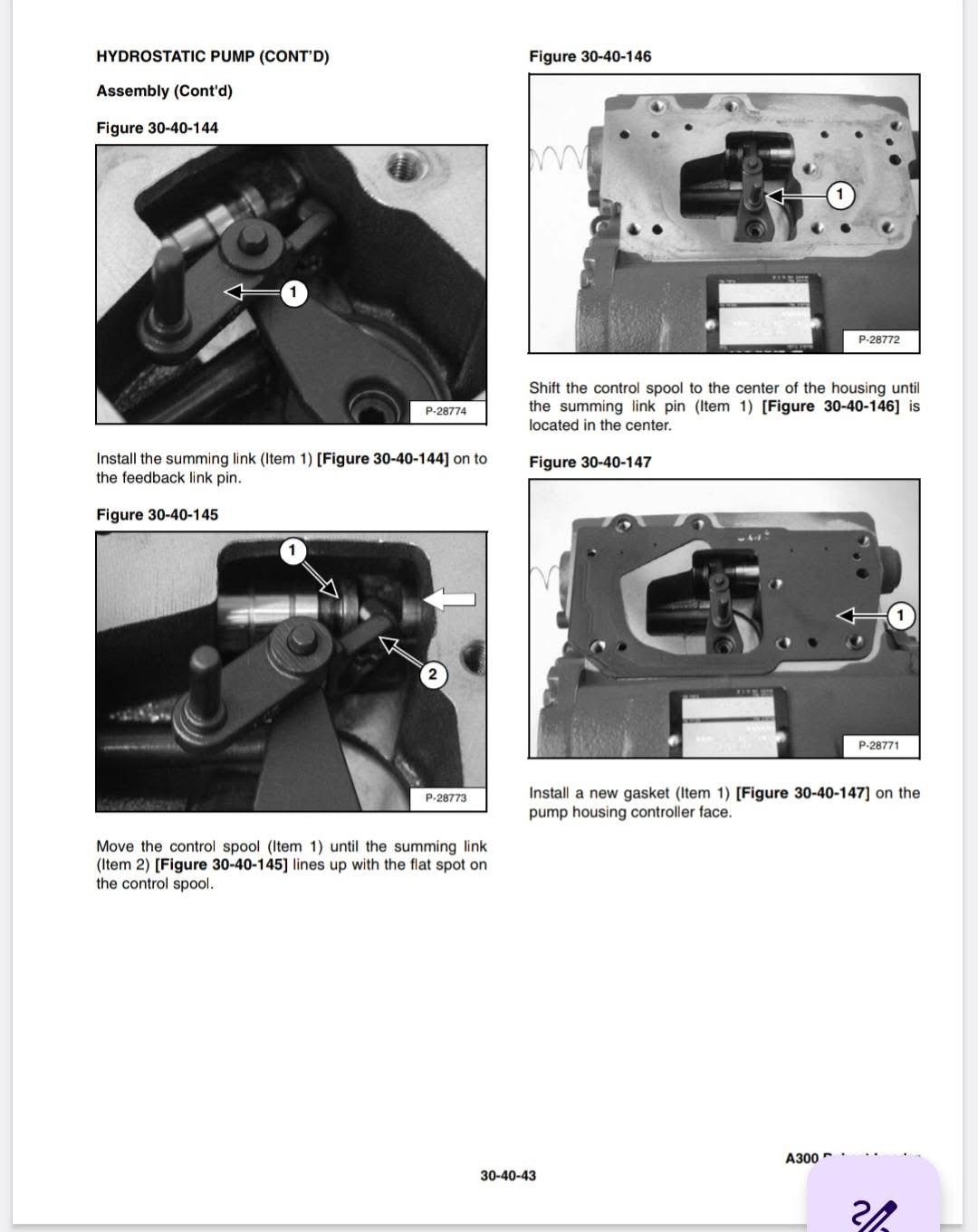

I took off the left hydrostatic pump controller to check it out and noticed the control spool is not staying centered like it’s supposed to. I can move it to center by hand, but it just slides right back out. When I pull it to center I also hear a suction or vacuum type sound coming from it.
The machine has around 4000 hours on it, and since I bought it it’s been running good for the last 100 hours I’ve used it with no major issues until now. The only thing I’ve had to replace so far were all 4 hydraulic cylinder seals on the all wheel steer system.
I’m also planning on changing the two case drain filters to see if that makes any difference.
I’m not sure if this is a bad centering spring behind the spool, something internal in the pump, or maybe some kind of pressure issue. I haven’t opened up the bore plug yet to check the spring.
Has anyone dealt with this before? What would cause the spool not to stay centered like that? And is that suction sound normal or a sign something is wrong inside the pump?
Trying to figure out if this is something fixable or if I’m looking at replacing the pump.
Any help would really be appreciated.
