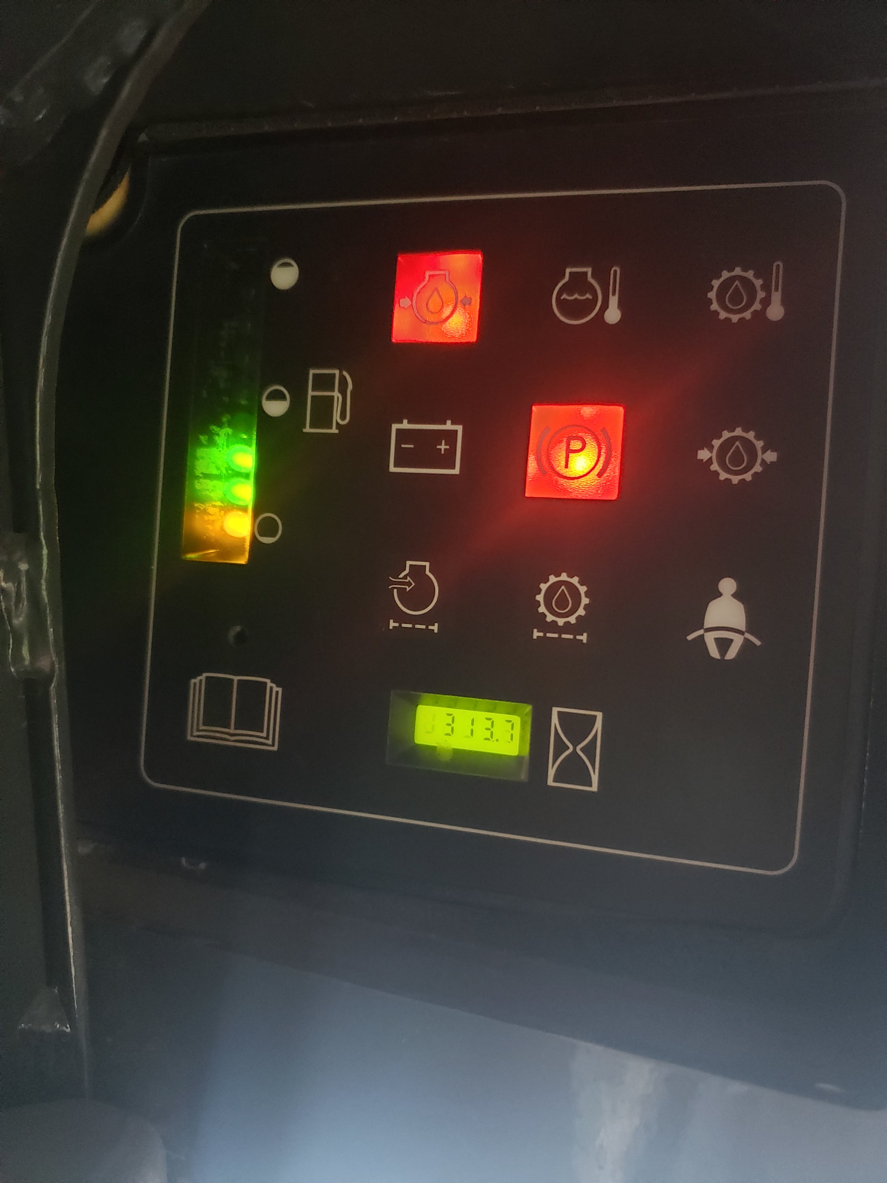

This unit purrs and runs as if new. However, it will randomly lock up when you exit the machine or shut it off. It may work 15 times and then you shut it off to talk to someone outside and when you try to start it again it will not function. It will start, the bucket curl works but the arms will not raise or lower and zero forward or reverse motion.

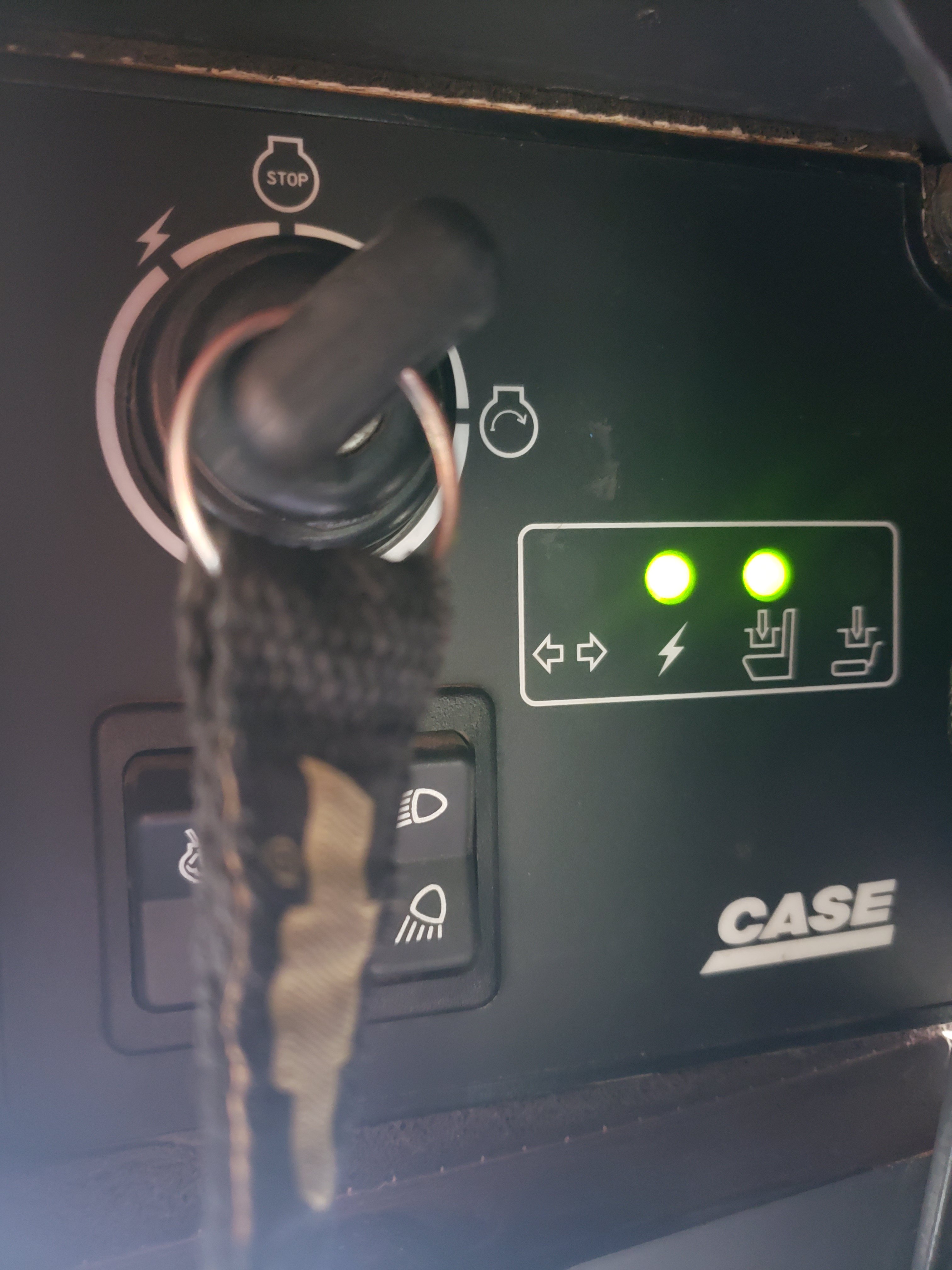

The upper right control panel has three green lights that must be activated for the unit to function. Light one is switch on, light two is seat switch and light three is the Lap Bar switch. Light three does not come on. If you turn the switch and have three green lights you are good to go.

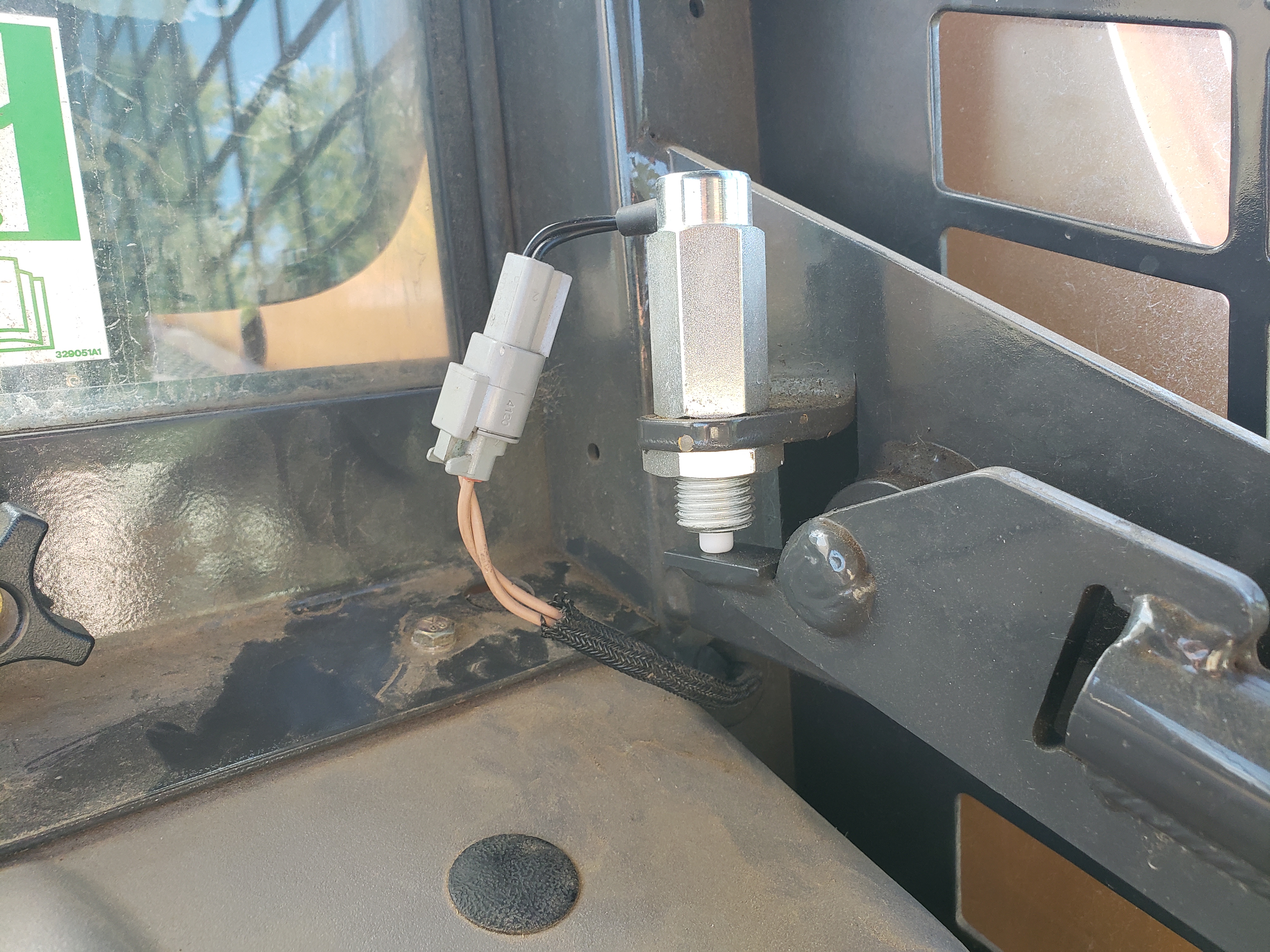

When light three is not lit up - you get in and out and in and out, bounce on the seat, lift and lower the Lap bar endlessly, wiggle the relays and fuses (which I took out and cleaned off the old contact grease and re-lubed) and it may or may not start. When this happens there is no current getting to the Lap Bar switch, I tested it.

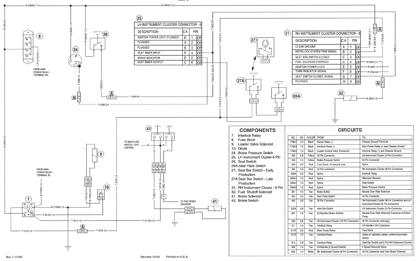

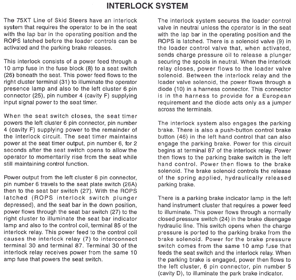

I have a service manual. The following is the interlock system description and wiring diagram:

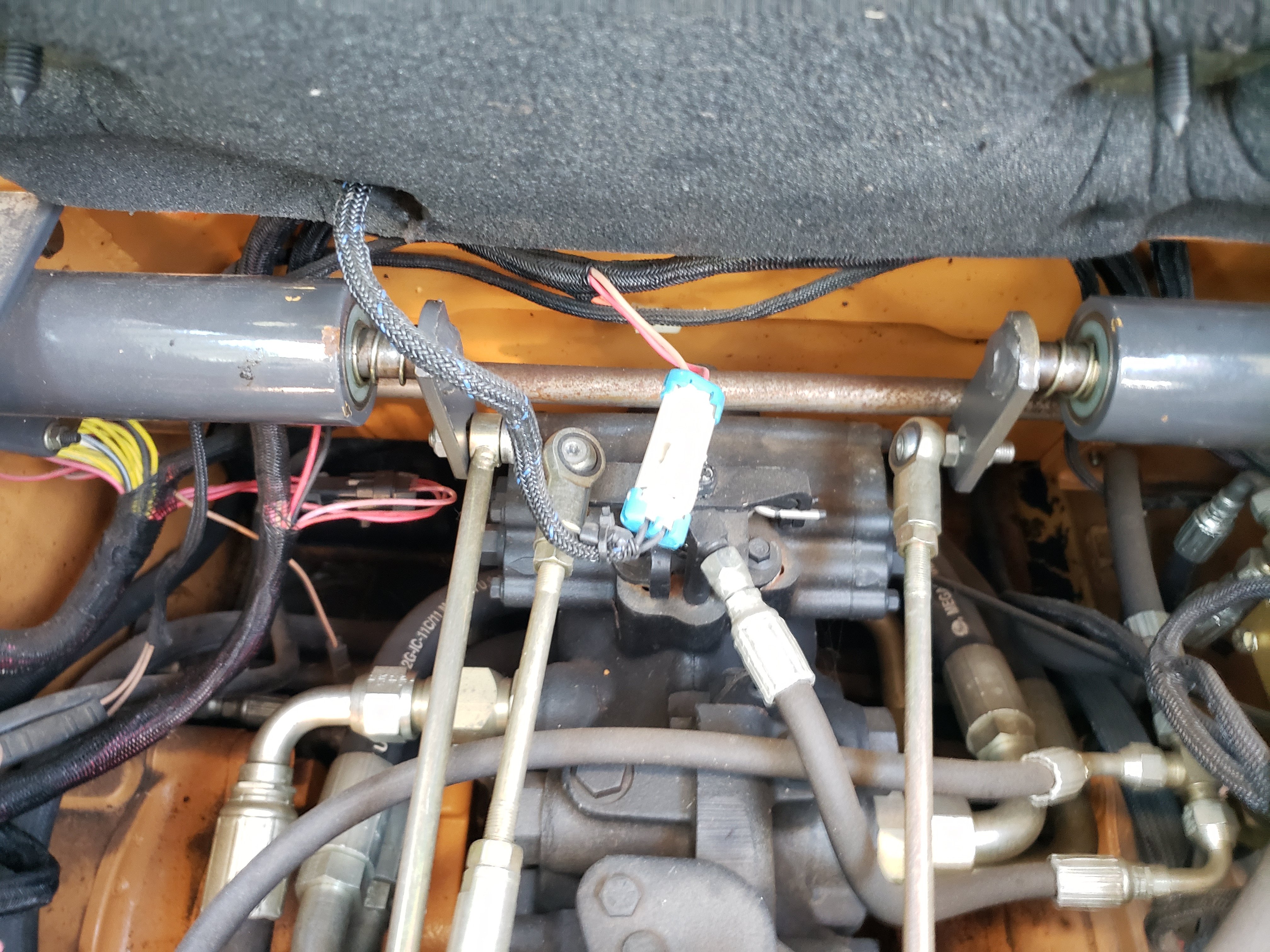

I figure it is either a short or something in the controller/display board. I really don't want to totally tear the unit down to trace a short and I really don't want to spend a bunch of money replacing a board that is not needed. Any insight would be helpful. I was thinking about tapping power off the seat switch out wire and running it to the lap bar switch, but I don't think that will solve my problem. Your thoughts would be appreciated. I have spent a lot of time reading about others having similar issues.
