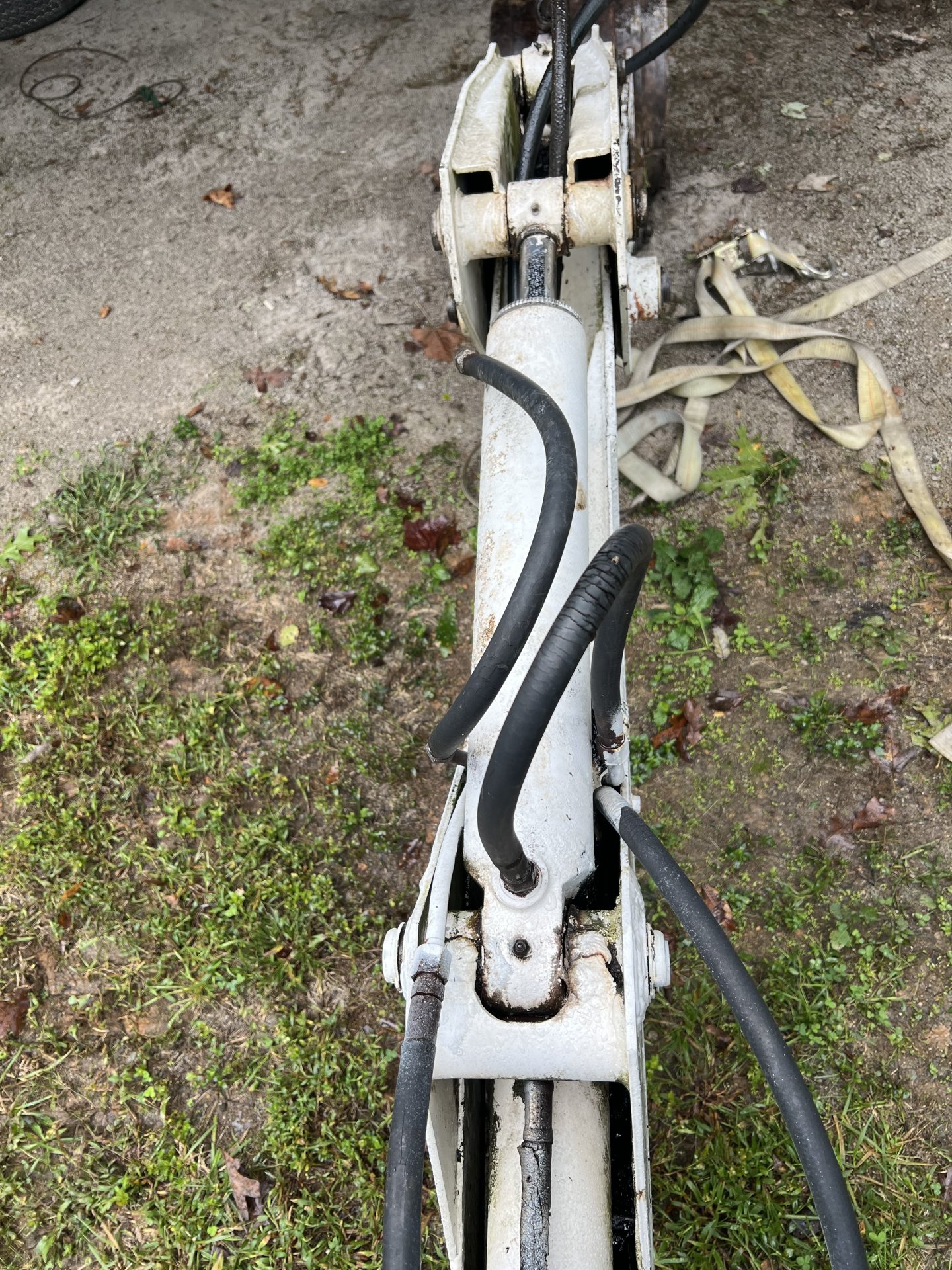

I have a new to me 909 attachment on a 763G high flow. This thing is so old. The serial number is 6561138 – M – 4100. Looks like a normal min 09 other than the fact it has a Melroe company sticker on the front of it.
My big question is, does anybody have the part number for the arm cylinder, seal kit and a part number for a new cylinder and possibly a source. Somebody tried to rebuild it and got it cross threaded, and the cap simply will not tighten all the way down.

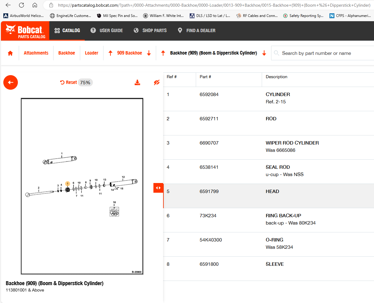

Parts diagrams are available on the Bobcat parts website, you can look it up by model number.
https://partscatalog.bobcat.com/?pa...5-Backhoe+(909)+(Boom+&+Dipperstick+Cylinder)This link should take you to the page you're looking for. A good machine shop might be able to rescue the cylinder barrel for you, and then all you'll hopefully need is a new head and seal kit. As far as I know the boom and stick cylinder on these backhoes are the same...
Hope this helps.
Edit - that link might not take you right to the page you're looking for but just to the main page, you'll have to see what it does when you press on it... Here's a screen shot of what it looks like.
