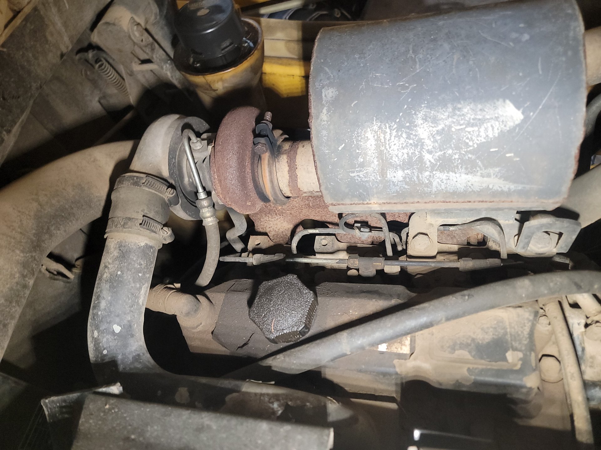

Hello folks, I have a 98 JD 8875. There is an exhaust leak on the hot side of the turbo where it goes to the exhaust, I can see that is is leaking around the clamp that connects the turbo to the exhaust. Is there any packing in there that needs to be replaced ?, tighten clamp or replace clamp ?
Looking for repair ideas
TIA

well I would suggest removing the clamp and seeing what the pipe under it looks like
it might be rusted or dented in causing the gap, and that will say what options you have, like
if solid pipe still take muffler o a good exhaust shop and ask them to flare it open a small amount, get a new clamp and see what that does!

Thanks for your reply, I will give that a try
