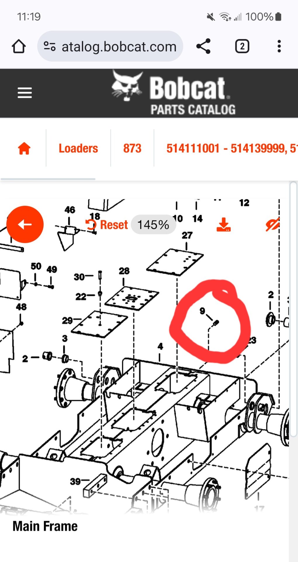

So I got my 873G home. Bought at auction. Wasnt my best move! Finally got around to opening all the access covers. There is oil everywhere inside the doors. I have found 1 obvious leak from fuel pump. But the thing is covered everywhere in oil. Also is there a drain plug for the housing of the machine, as there is water in the belly? It doesnt seem to smoke a ton like a head gasket failure. It runs fine. I havent been able to operate much as there was also a fuel line leak from the returns, so waiting on new lines. Any ideas? Has less than 2500 hours.

Look on very bottom in back, facing backwards, should be a bung type plug to drain it. Make sure you have an Extra large pan to catch it! It will be a lot.
I would slowly clean / wipe areas (Do not use pressure washer) and see where the leaks are coming from. Then go from there.
Post pictures of your new 873G
Here is your skidsteer. See #9 should be drain plug.

I took off a "drain cover" that bobcat calls it. Has 3 bolts holding it on in the rear, but for the life of me, I cannot locate a plug for the side access area.
