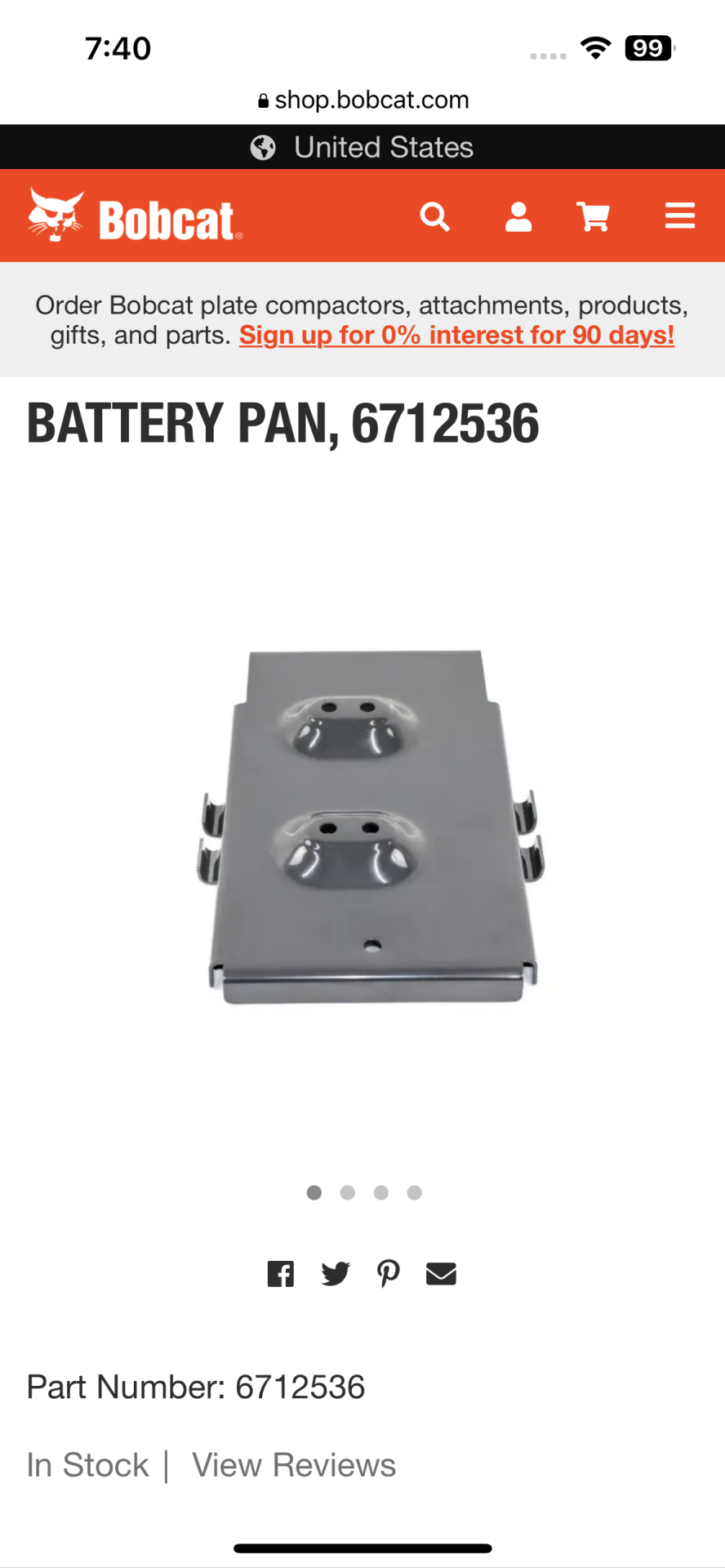

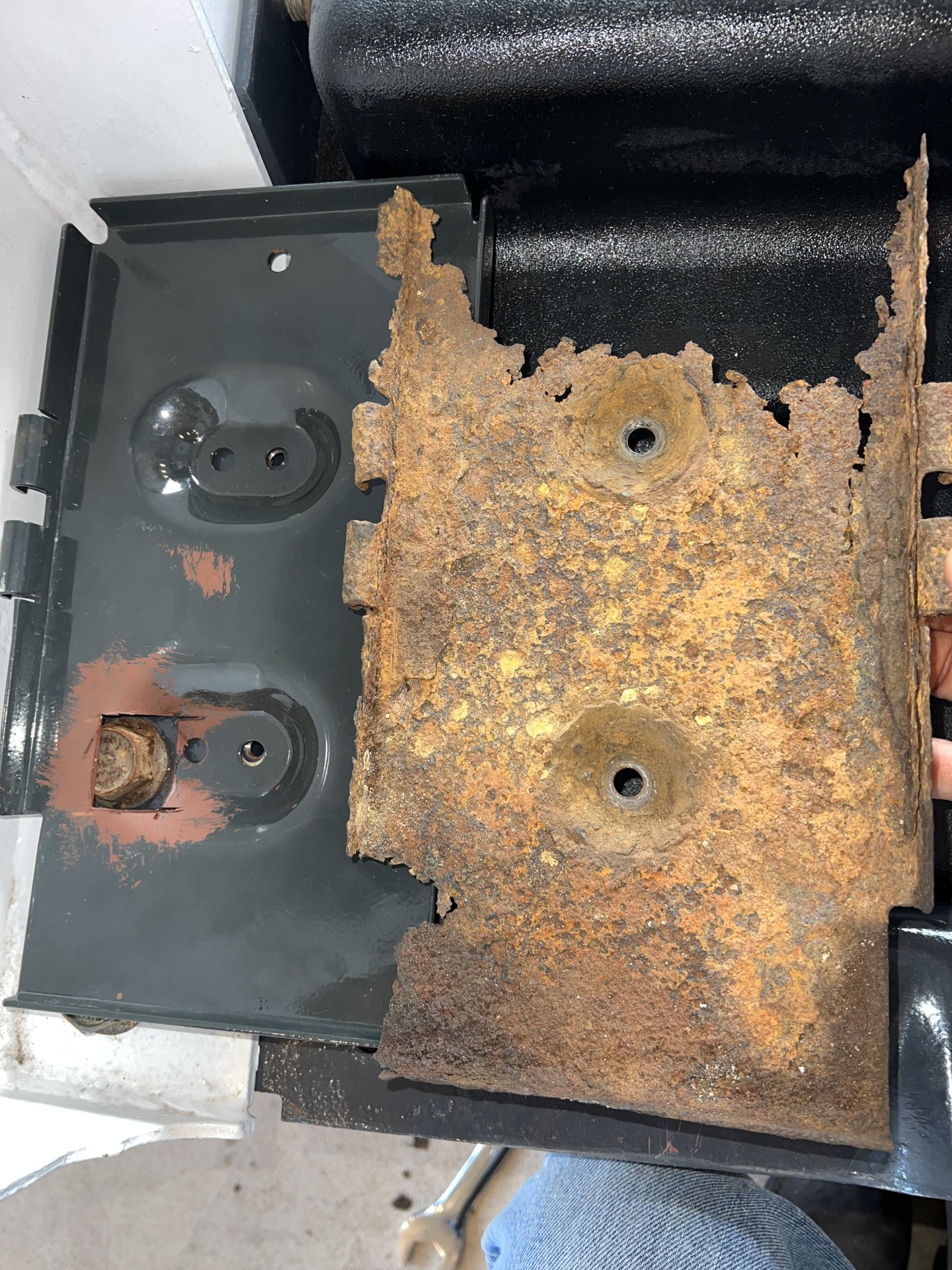

See pic - if you’re replacing your battery tray, you might need a grinder to make it fit. The replacement battery tray has a wider well and two screw holes. That extra width hit a body bolt on my 853. I got my tray from AllSkidsteers but the Bobcat site has the same layout.
