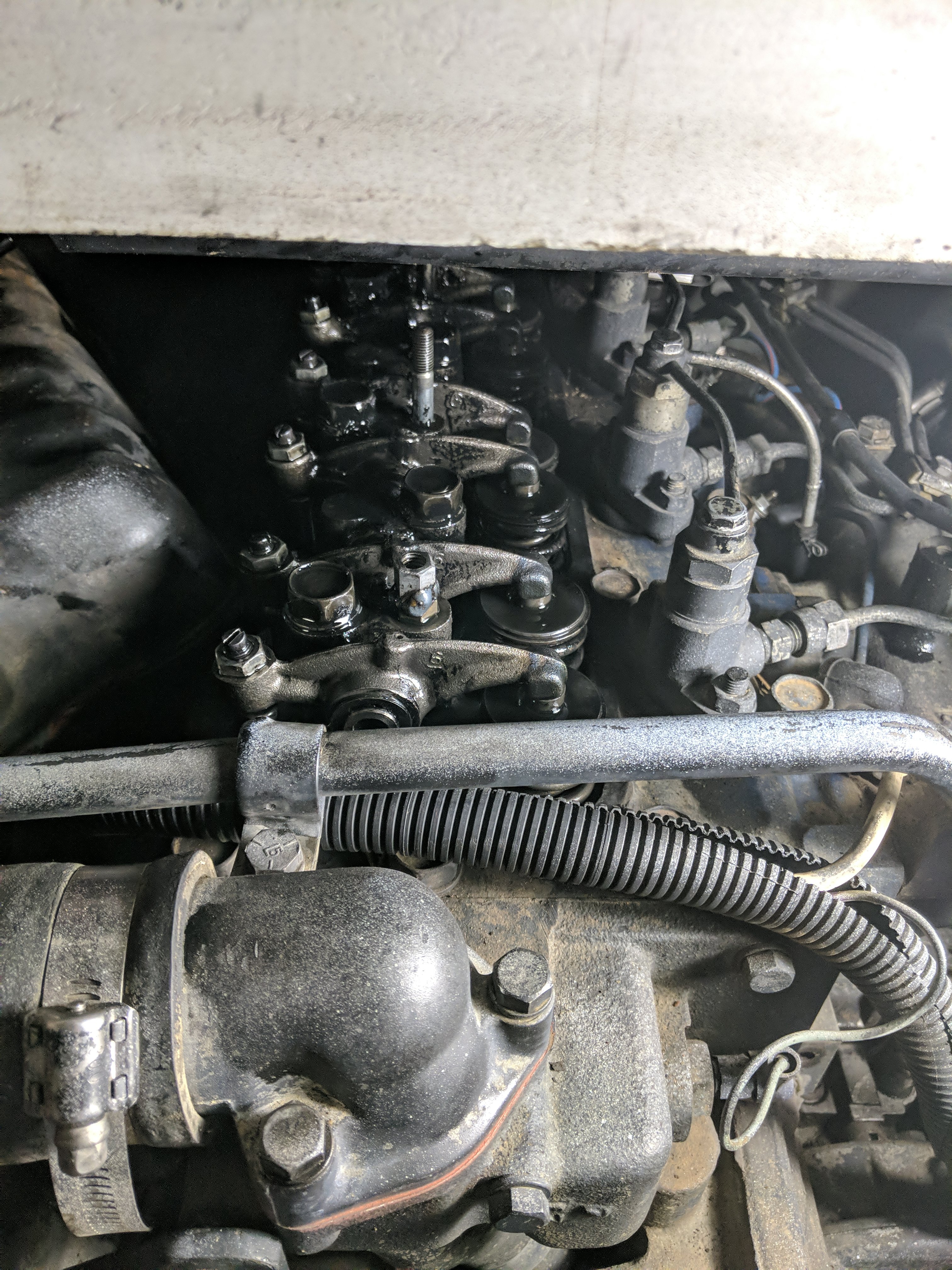

I have an 843 about 6985 hours . I noticed the oil light flickering after unloading from the trailer . I had this problem on an f250 and it ended badly . If the switch isn't bad I would guess its probably sludge slowing the flow from the pickup tube . On mine I recently changed the oil after running it for 20 minutes with about 24 oz of diesel fuel in the motor , then filled it up with fresh oil and more diesel and dumped it again after another 20 minutes idling. Finished by changing the filter and filled it up with new 15/40 .
Oil light has stayed off for a few weeks now . A couple days ago I adjusted the valves and noticed how clean the rockers were !
