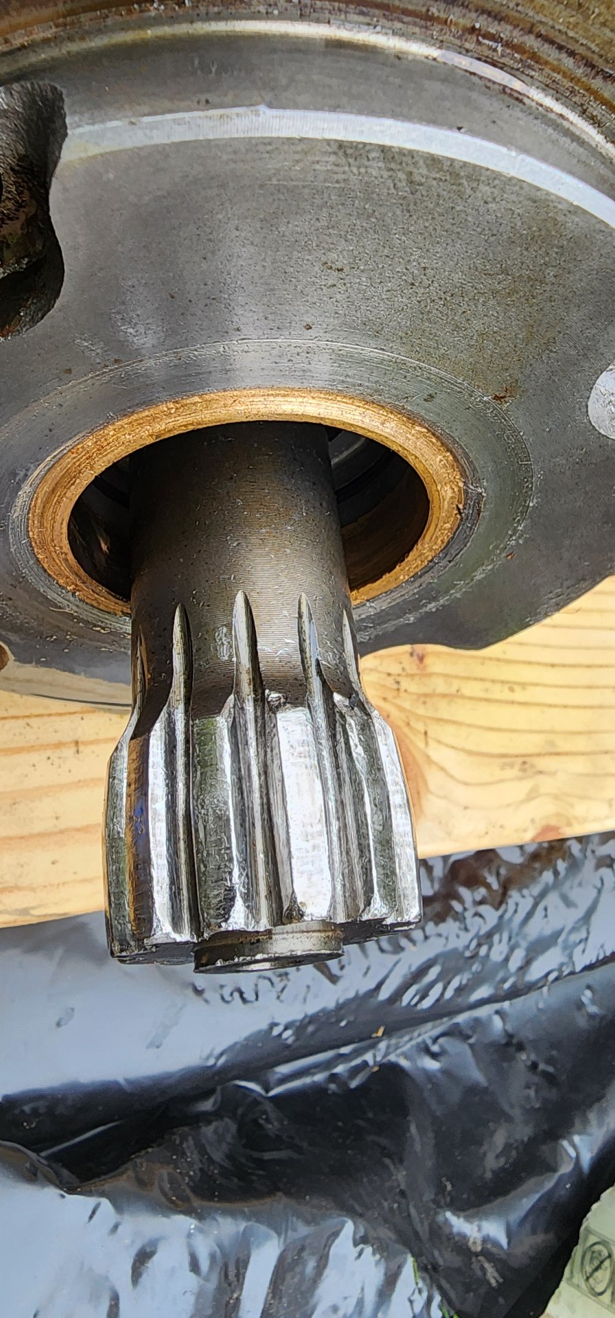

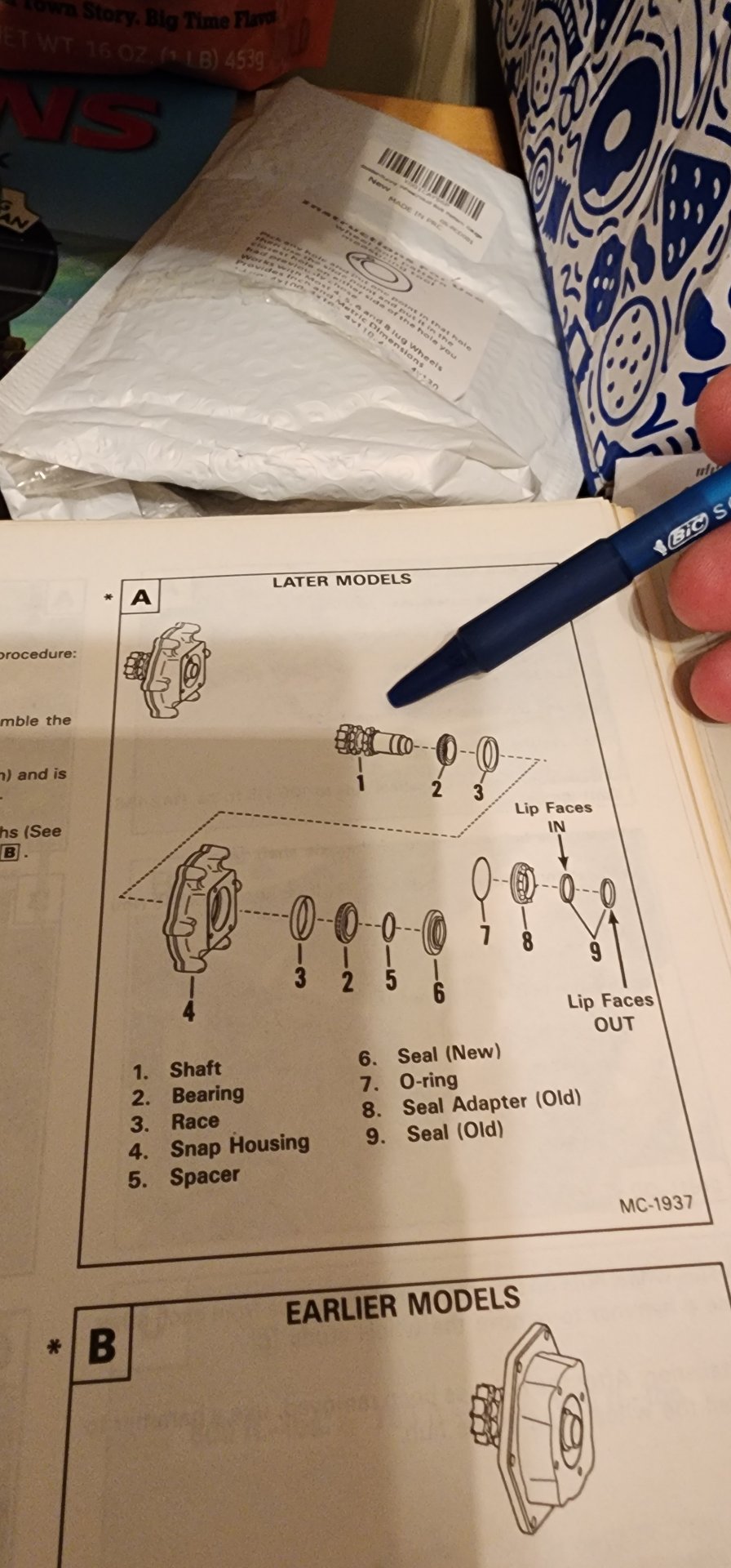

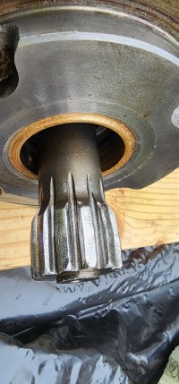

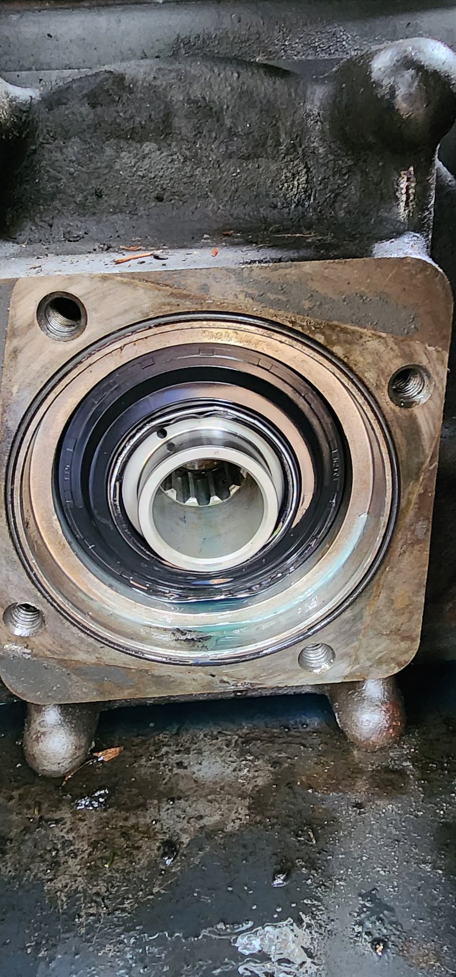

hello everyone! new member but have been following for years.
need help... my 7753 is leaking hydro fluid really bad into the chain case. moves about 100ft then wont move.... ive pulled the motors... resealed 1 seals were junk.... while removing the other side motor i noticed that the brass bushing on the motor was worn a little... i am able to move the shaft on the body side a lot with the seal out.... is that normal?????? or do i need to dig into the machine more? if i do what would i be looking for to be worn out???
thank you in advance for your help
