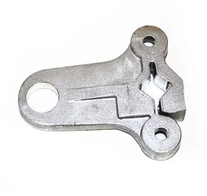

The problem with pulling to the left MIGHT be due to a worn out or cracked control lever on the side of the hydrostatic pump. Definitely worth a check. The hydrostat has a square trunnion shaft that sticks out for the lever to connect to. It looks like this.
