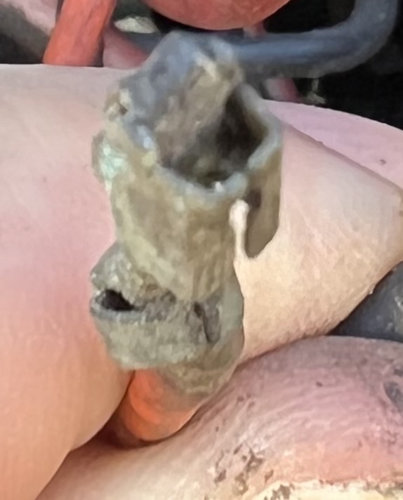

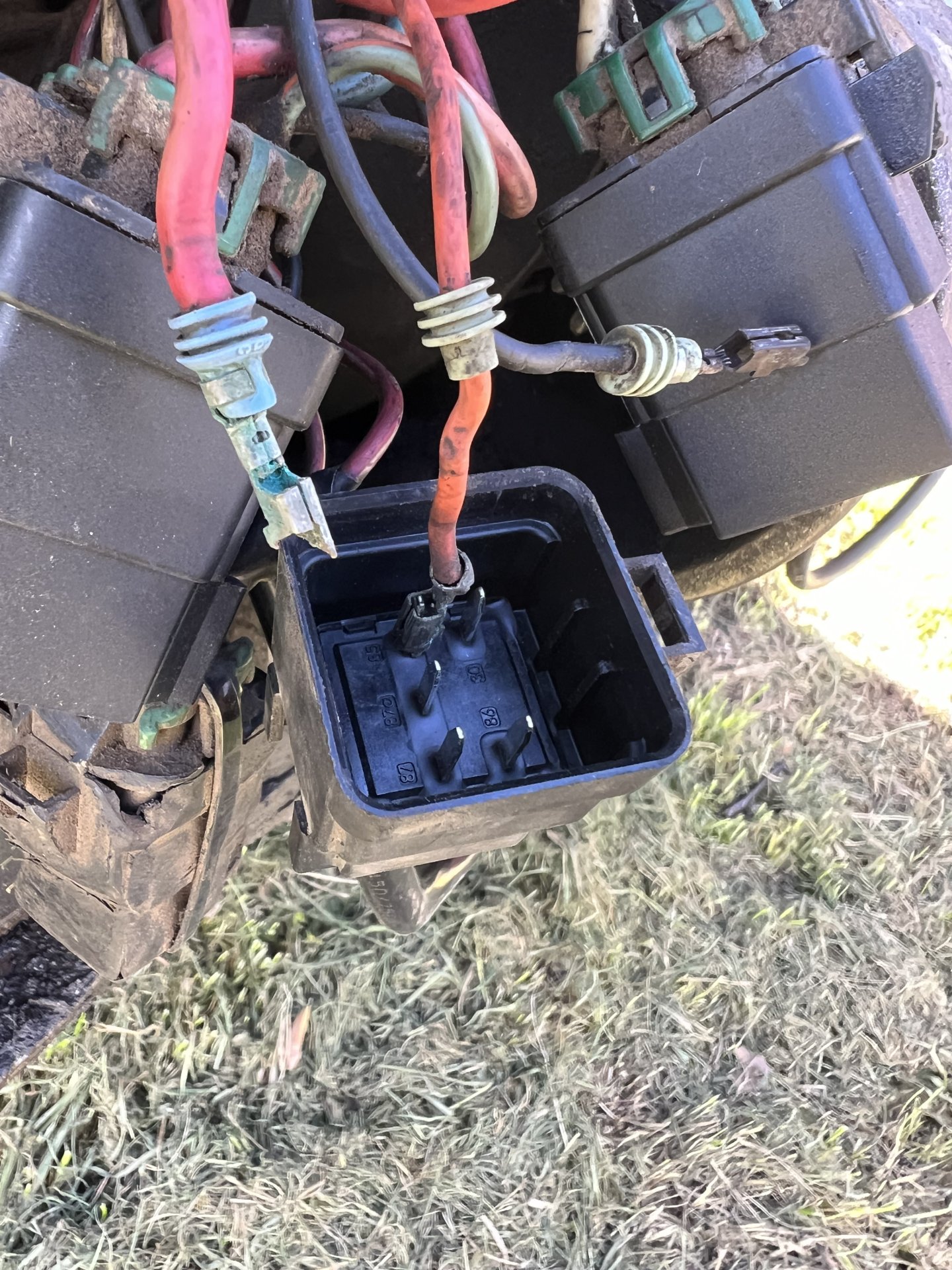

I have a late ‘90’s 763 F series and the starter relay connector female pins have broke. I am looking to replace the female terminal (in the socket - not the relay itself) and I am unsure what type of connector they are. Does anyone have any suggestions? I am attaching pictures of the female terminal connectors, including one I connect to the relay pin.

Try local Auto parts store. I bet Dorman makes an assortment pack. Female pin terminals.
Look at part # 85377 @ autozone . The smaller one might be it??
