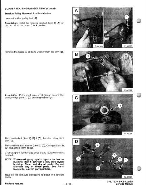

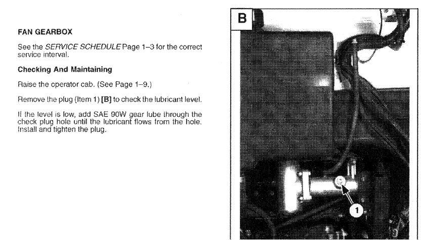

<blockquote data-quote="OldMachinist" data-source="post: 45739" data-attributes="member: 437"><p>That belt is tensioned by the idler/tension pulley. If its been awhile since it's been greased it may not be applying the proper tension. The belt could also be stretched.</p><p><a href="https://www.skidsteerforum.com/skid2/javascript:void(0);" target="_blank"><img src="http://i245.photobucket.com/albums/gg49/calfranch/Bobcat/753/Fan_idler.jpg" alt="Fan_idler.jpg " class="fr-fic fr-dii fr-draggable " style="" /></a></p><p>While you're there you should check the oil level in the gearbox</p><p><a href="https://www.skidsteerforum.com/skid2/javascript:void(0);" target="_blank"><img src="http://i245.photobucket.com/albums/gg49/calfranch/Bobcat/753/Fan_oil.jpg" alt="Fan_oil.jpg " class="fr-fic fr-dii fr-draggable " style="" /></a></p></blockquote><p></p>
[QUOTE="OldMachinist, post: 45739, member: 437"] That belt is tensioned by the idler/tension pulley. If its been awhile since it's been greased it may not be applying the proper tension. The belt could also be stretched. [URL='https://www.skidsteerforum.com/skid2/javascript:void(0);'][IMG alt="Fan_idler.jpg "]http://i245.photobucket.com/albums/gg49/calfranch/Bobcat/753/Fan_idler.jpg[/IMG][/URL] While you're there you should check the oil level in the gearbox [URL='https://www.skidsteerforum.com/skid2/javascript:void(0);'][IMG alt="Fan_oil.jpg "]http://i245.photobucket.com/albums/gg49/calfranch/Bobcat/753/Fan_oil.jpg[/IMG][/URL] [/QUOTE]
