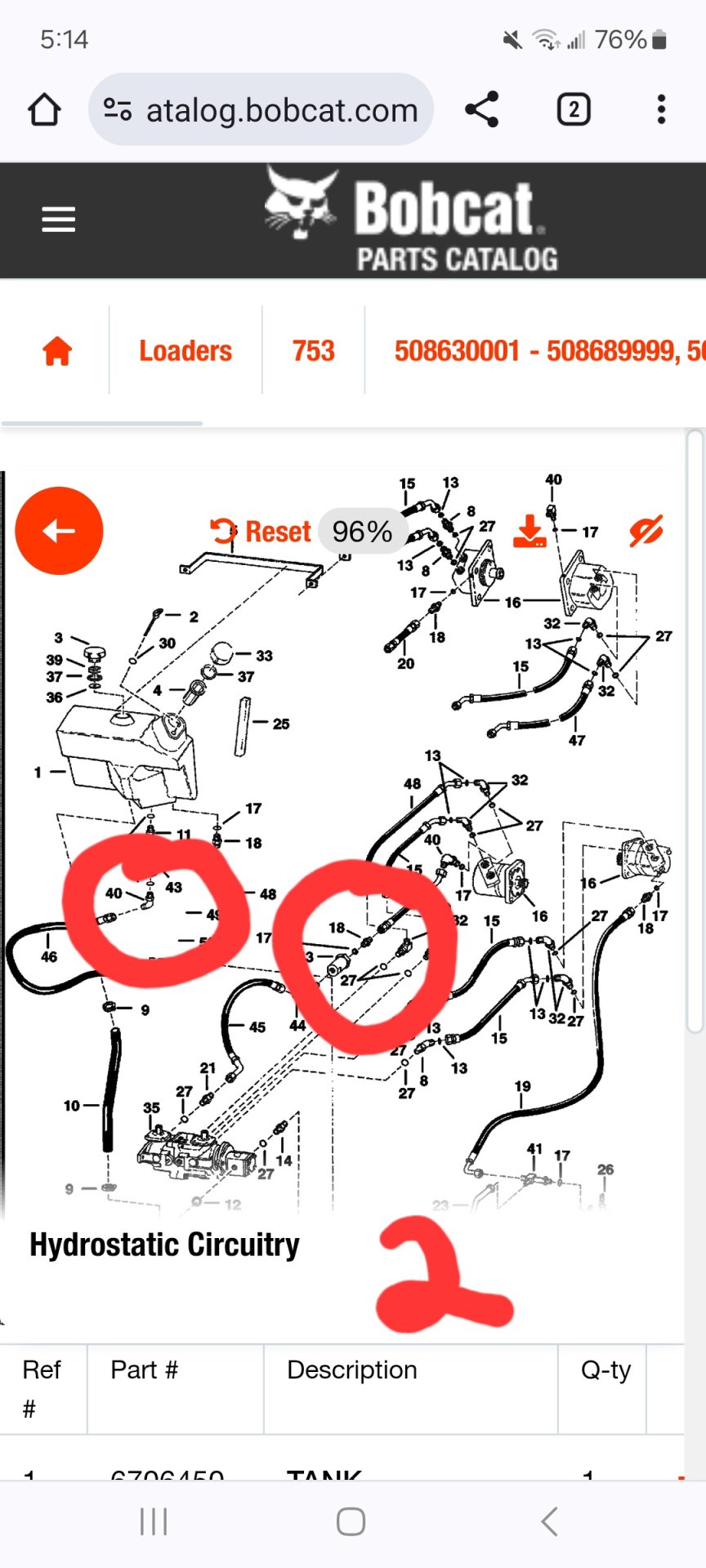

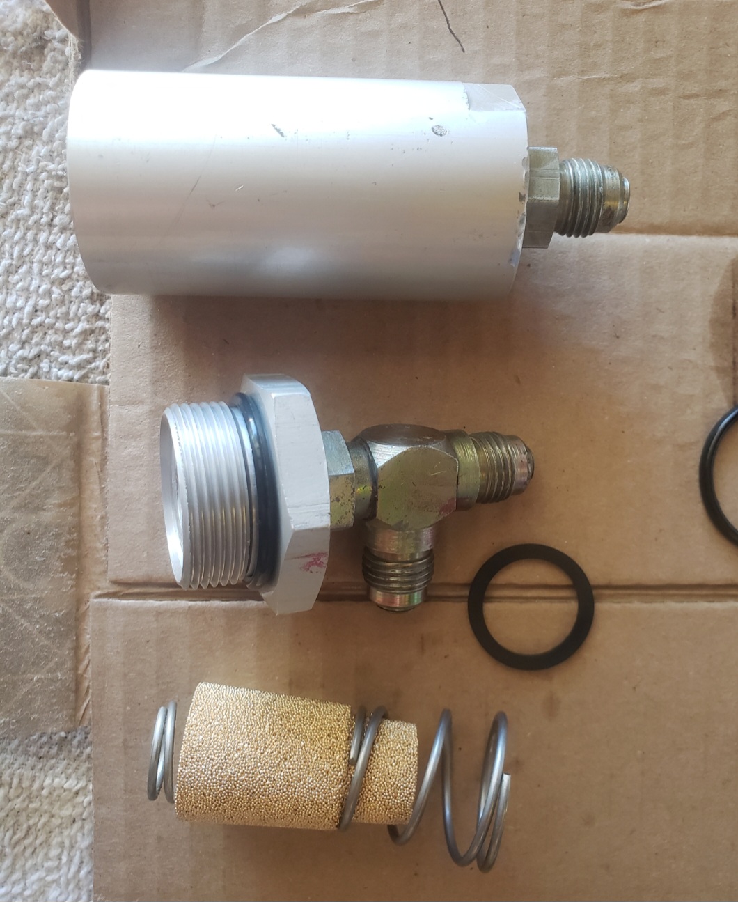

I have a 863f, it has two in-line filters and two screw on filters.
Fast check Bobcat website for your exact model and you can see schematic.
General 753 model shows two in-line filters fyi.. #43 ! If one gets clogged up it can give the same symptoms. But i'd be willing to bet it needs a rebuild. I did mine in one day and got the kit from LPS .
