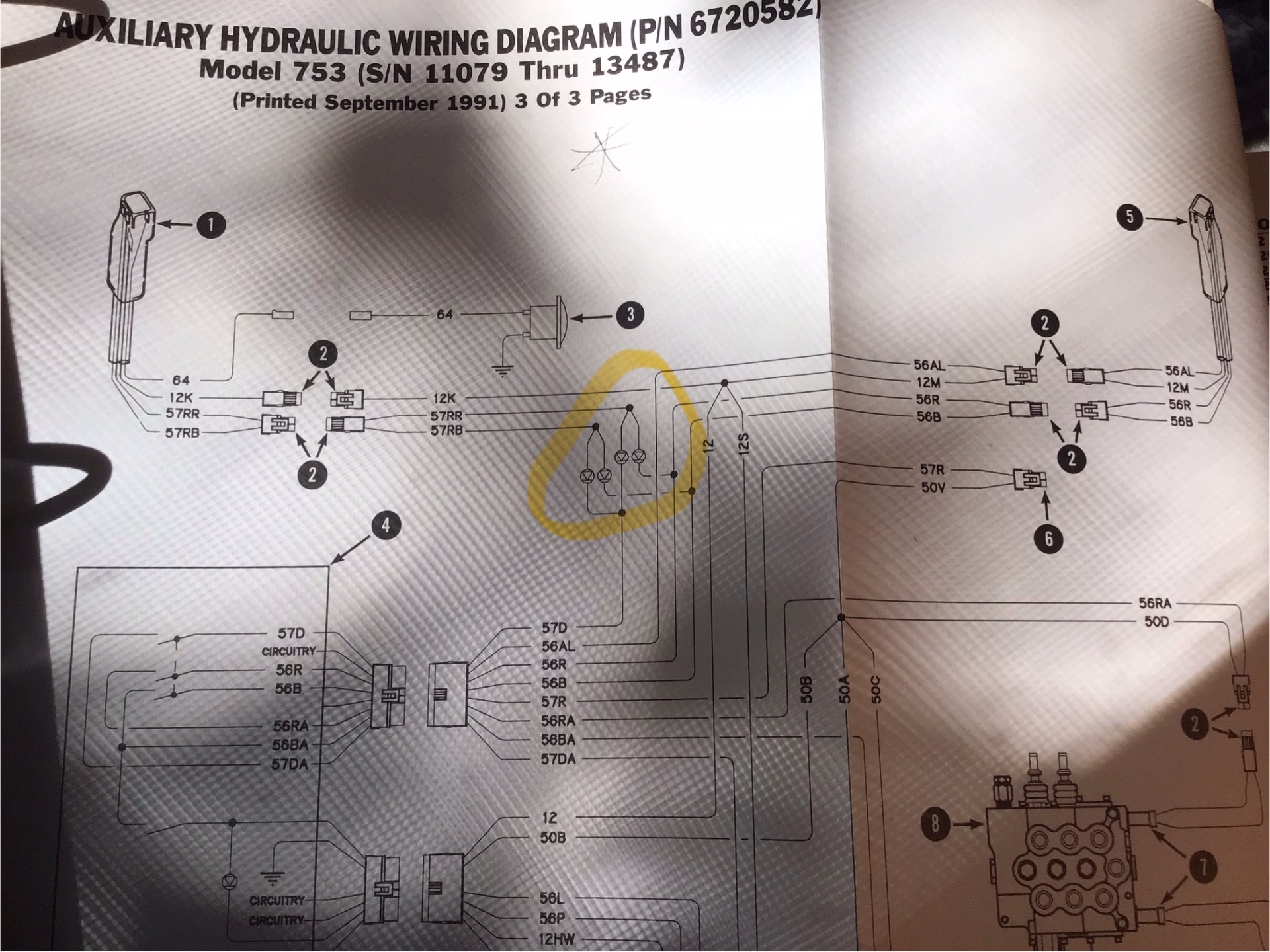

Are you saying the rocker switch doesn’t reverse flow as it should.? I had a similar problem for my 753 rear aux hydraulics for downriggers. The diodes in the harness had to be replaced. Now it functions perfectly. This is the harness the left and right joystick wire feed attach to.

See wiring diagram, triangle thingies, between joysticks
