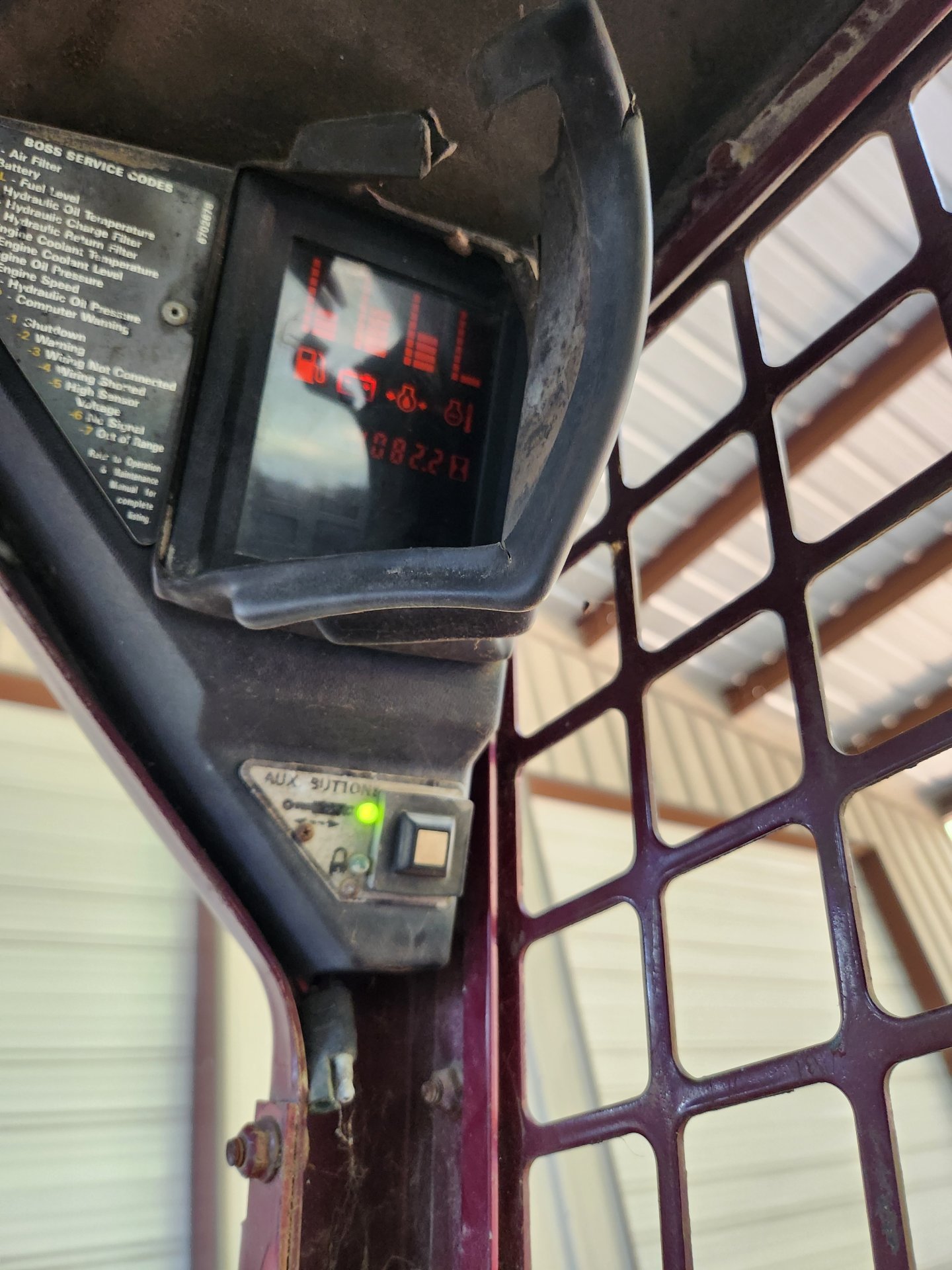

My Aux Hydraulic light is staying on and the button does not change anything. I have not hooked up my grapple yet but it did work the last time I used it. I am currently just using some forks.. I think this is an electrical issue. I will start trouble shooting now that I have stopped the Hydraulic leaks. This is a 1991 753, according to Bobcat with BOSS system and 2408hrs and no BICS. Don't know series and have asked, but did not hear on that.
Any suggestions on where to look would be appreciated.
Thanks
Brian

when you had the grapple hooked up does auxillary work before you button and after you hit the button?
Yes, the grapple would open and close. But it didn't seem to have the gripping strength, and that may have been a factor of the leaking hoses that I just fixed. I have the service manual and wiring diagrams, so I'm hoping it is a short somewhere and not the module on the frame.. PWC???? can't remember right now
Oh yes it did open and close, and the aux light will not go out if you push the button or the lock light does not come on..
my question was with the grapple attached opperating the auxillary the grapple moves? now hit the button does it still move
