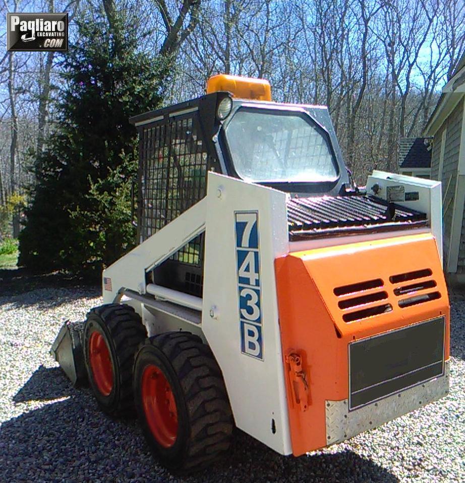

Owned this 92 743B since 2005 and had no idea about these 3 zerks . Did my research , (Thanks Tazza ) and made my way in today . Found the 3 zerks and offered the GF to reach in since her arms are skinny and offered a 100 bill ... ( offer taken from previous posts ) She said " I'll do it for 300 " . PLAN B : I told her to stand by and hit the trigger on the Lincoln Battery Grease Gun .... All 3 zerks took grease with no resistance ... gave them all 20 pumps each ( i know maybe over kill) , Then cranked the starter a few times ... then started motor at lowest idle , for 5 min. Then drove around at high RPMs . No mess in under the cab or in the engine. I wont be doing this again , my right arm has a few blemishes . BTW i used regular length lincoln greaser hose length .... She hit the trigger. Everything sounded nice and smooth - see attached pic of Old Faithful today :
