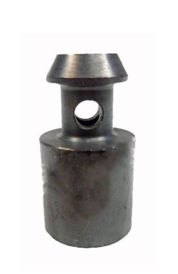

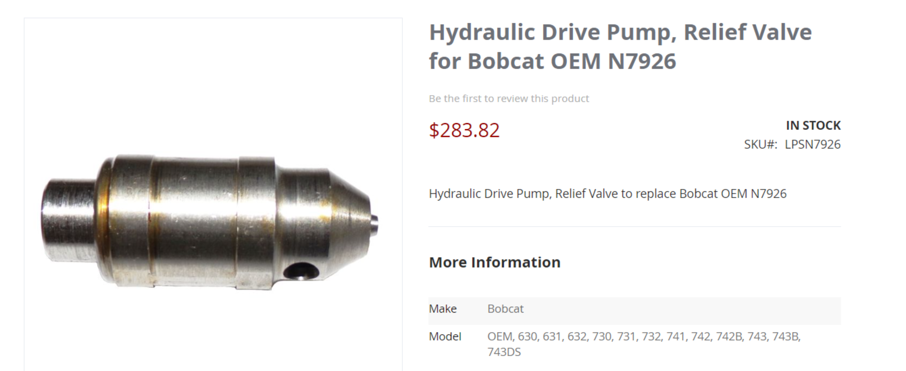

Does this look to be the right part?
What is the difference between this poppet 6513432 from what I see they go into the same place as the high pressure valve above

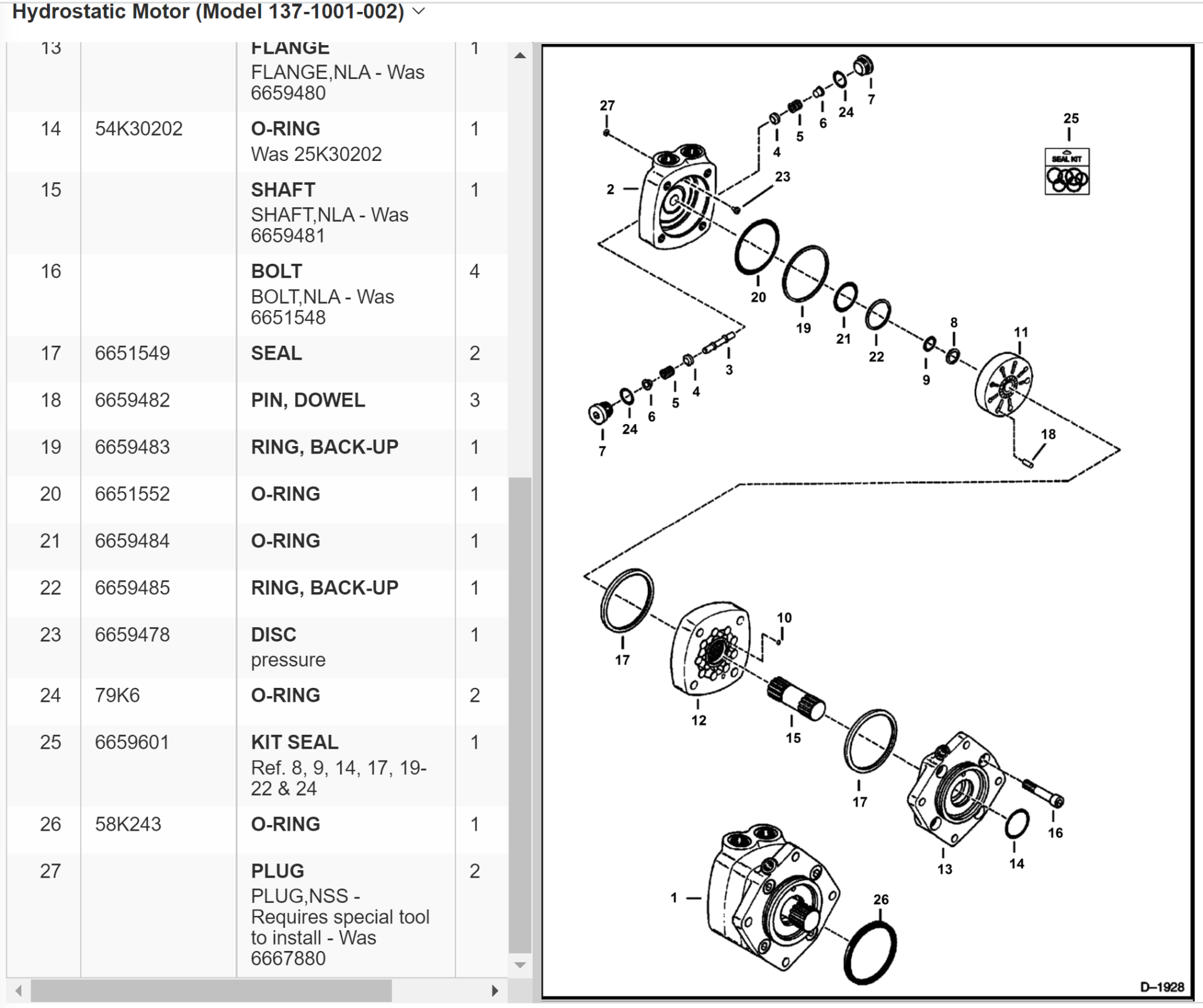

As mentioned I had recently rebuilt my drive motors in March of 2022. By about July the steering malfunction started showing up. I replaced the High pressure replenishing valve thinkin it couldn't be the Drive motor, it was just rebuilt. Wrong! So I contacted LPS (Loader Parts Source) James sent me a pdf of how to isolate the drive motor from the rest of the system. It is called a pump dead head test. The two large caps you need are a JIC12. I bought 4 plugs and 4 caps from Discount Hydraulics Direct (Click the active link) When you do the test the pump should stall the motor. Mine did so I knew the problem was in the drive motor. It is not a difficult job. I found that one of the three o-rings installed in March had disappeared. It is the one in the center with the wide flat retainer ring that covers it. In the kit it is slightly off color. Took about 1.5 hrs start to finish. All is working good.

Just wondering what could have caused this o-ring to disappear in the motor. When I did the rebuild originally in March the retainer was cracked and the o-ring was in pieces and partially gone. (Ref 21 and 22) This time the retainer was still there and un harmed but no sign of the 0-ring. Could Hydraulic oil cause the o-ring to break down or something else?
