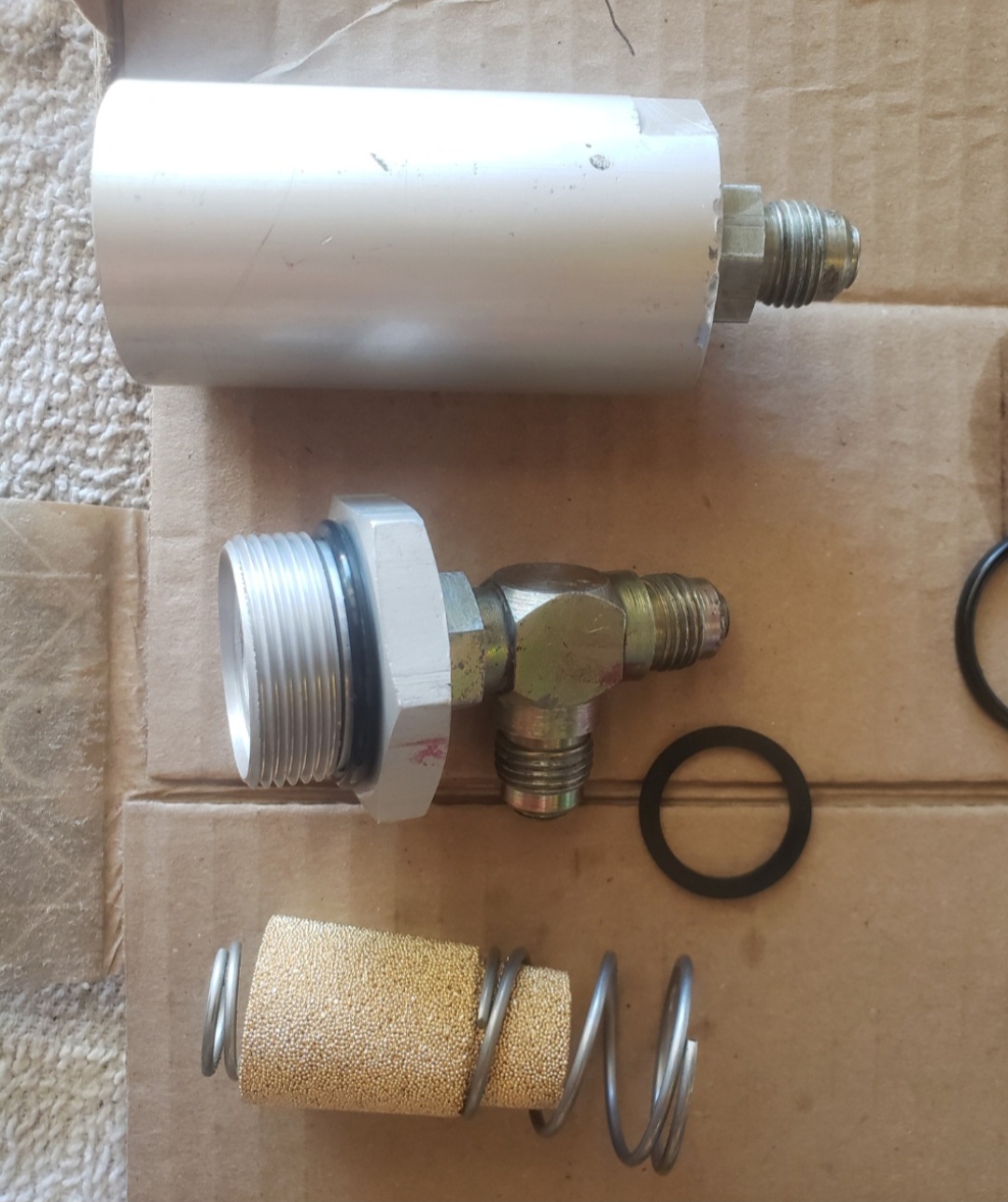

The in-line filter looks like this:
Sometimes its nasty dirt, oil covered and hard to find. Usually just before a drive motor.
