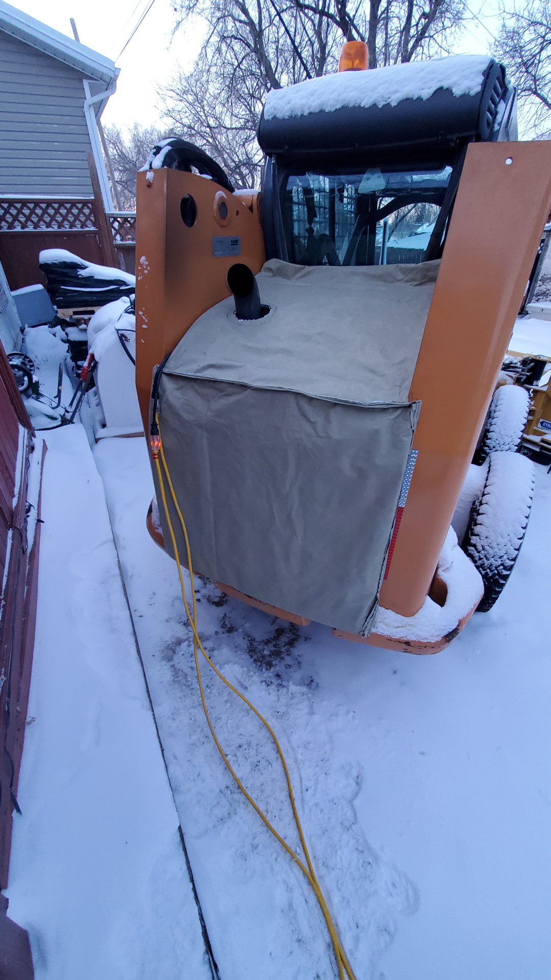

I have an old 743B that I occasionally have trouble starting when it gets REAL cold.
I have a neighbor that loaned me this HUGE insulated tarp. Does anyone have one of these? I can't find them anywhere online, but would like to get one the size of the back of my bobcat, so that when I plug it in on super cold days ... I'm not tryna heat Alaska.
Any links?
Thanks in Advance

I built my own. An hour on the sewing machine, Walmart deck table cover on sale $15, left over foil bubble insulation from a local plumber(free) super magnets from dollar store $5, and some vinyl drawer liner for magnet strips. Water proofed with whatever is cheap. Silicone spray, tent spray, linseed oil.
2 hrs at -30, everything under the hood is at operating temp 180*f
200w block heater, 750w circ block heater and heat pads on the fuel and hydraulic tank.

200w block heater, 750w circ block heater and heat pads on the fuel and hydraulic tank. View attachment 5601This looks like what I'm after. In your spare time, consider making these as a side job. 😊
