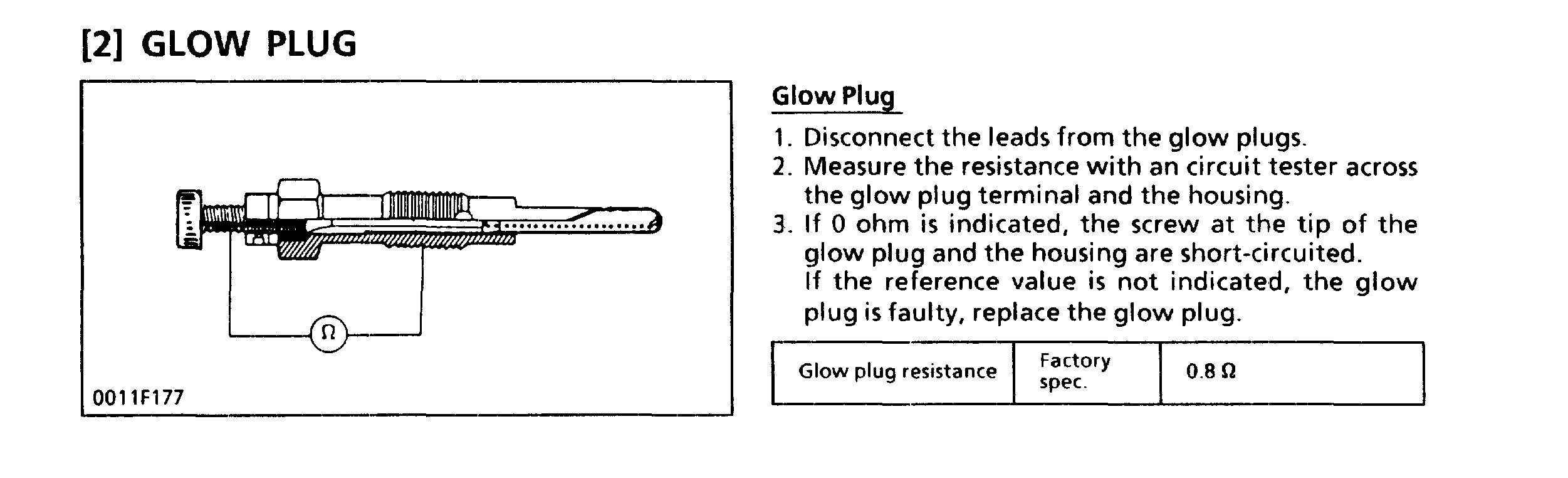

When you are trying to start the machine does it put out white smoke with strong odor of diesel? If so and if the compression test is good and you ohmed the glow plugs. see insert
Clean the glow plug and connector rail at connections and use Noalox or a dielectric grease you can find in the Electric aisle or Electrical supply house. Check for any frayed or broken wires. For good measure clean all electrical connection.
Check battery voltage and voltage at glow plugs also check voltage when cranking the engine. Buying a remote starter tool will help you greatly.
