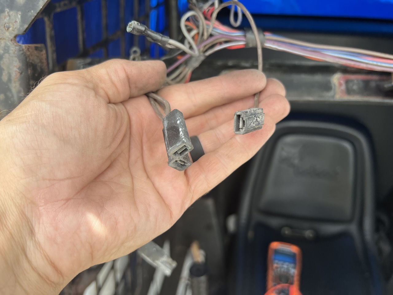

Second question is on the light switch. Mine did nothing and no lighting worked. So I pulled everything apart, cleaned contacts all over and got things working. The switch has 4 positions like this:
0) off
1) power to empty wires (see pics below)
2) front two lamps and rear lamp turns on
3) front two lamps only

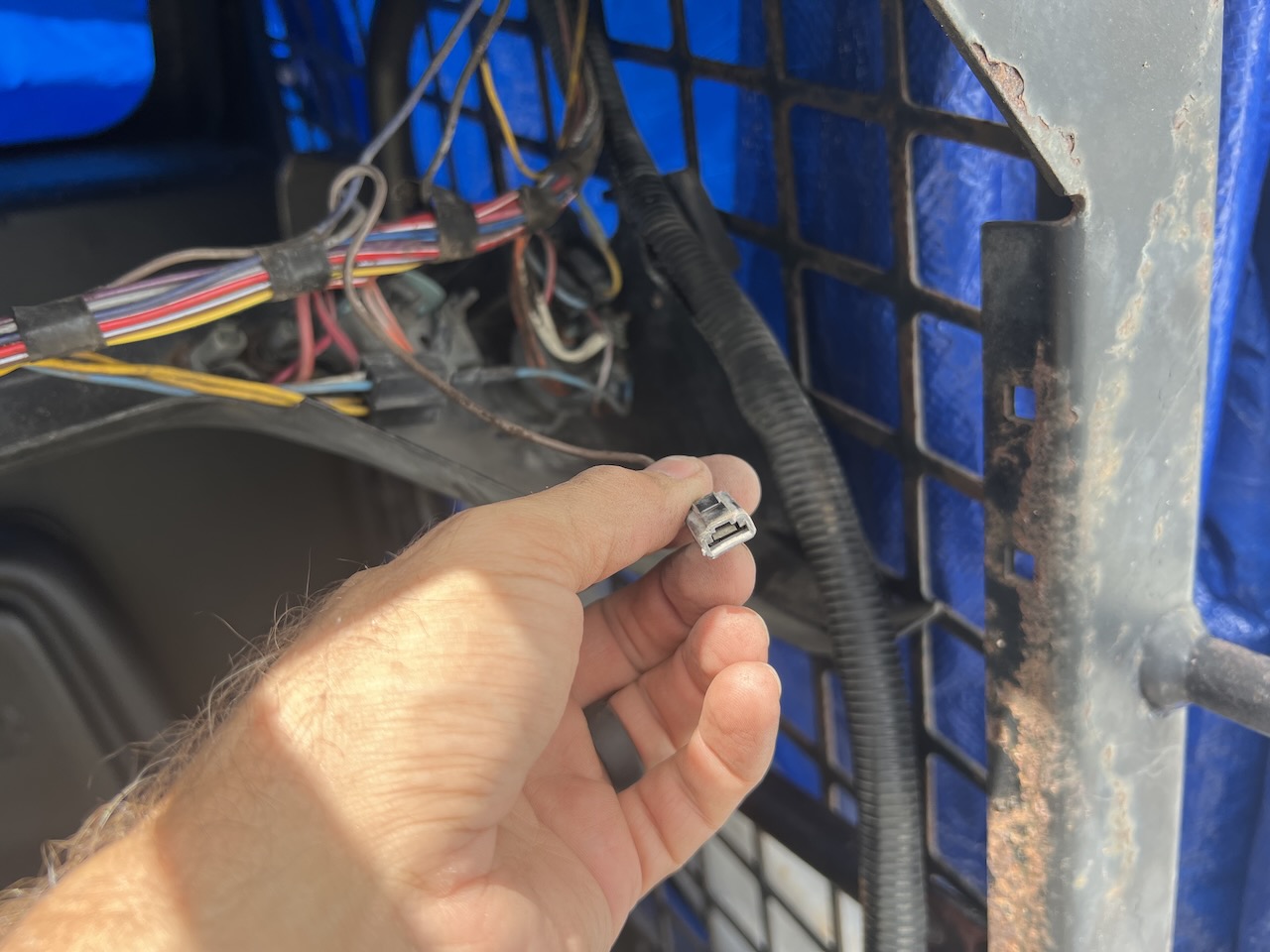

After tracing wires I found that position 1 of the switch (the first click from the off position) sends power to these two connectors on the right side (passenger's side if it was a car)
and it also sends power to this connector over on the left side
What did those used to go to? What would have normally light up or happened on the first click of the light switch?

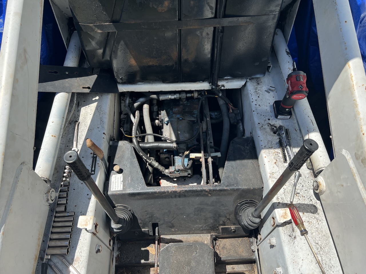

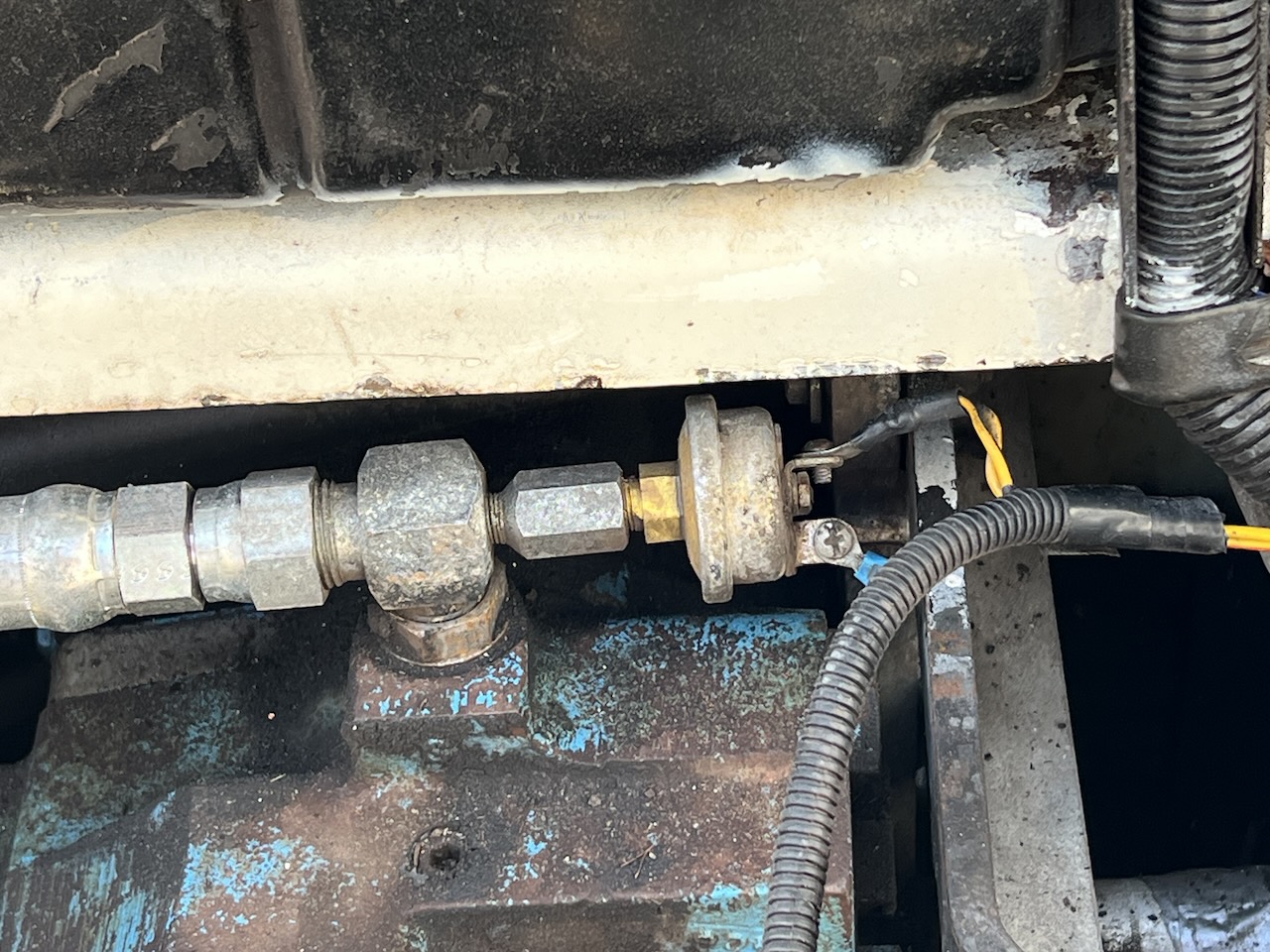

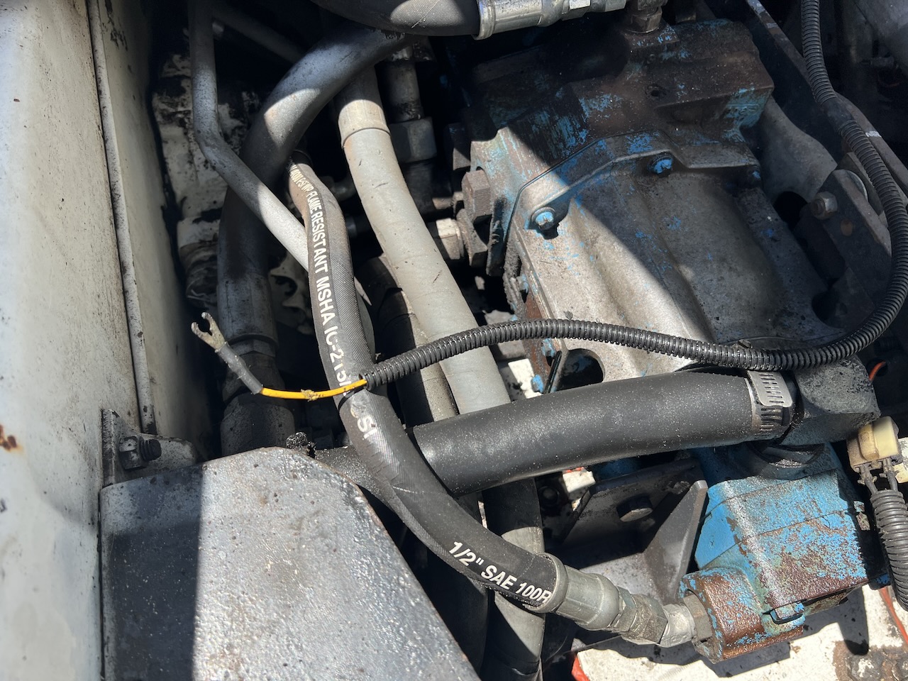

I got to looking under the cab and possibly found the hour meter wire. Found the same looking yellow with black stripe wire and not far from it is some sort of pressure switch.
I unfortunately ran out of time and had to bolt to work so I haven't traced out the wire yet but if that checks out does this pressure switch nearby seem like it might be the place to go? That looks like some sort of pressure switch on the hydraulics but I don't know if that activates when the engine starts up or when the unit is backing up or what?
Thanks
After some searching I found this thread (for anyone searching)
https://www.skidsteerforum.com/threads/want-to-try-to-get-hour-meter-working-on-743.118773/
There's a post in there by a guy named Michael that explains that pressure switch I found under the cab has two connections. One normally closed and the other normally open. When the switch gets pressure they toggle.
The normally closed lights up the oil pressure light on the dash at key on and the normally open side turns on the hour meter once the engine is running.
Since the previous owner cut the hour meter wire off of it I'm assuming the switch is bad. I have one on order and will hopefully have everything working next time I get out there to mess with it.
