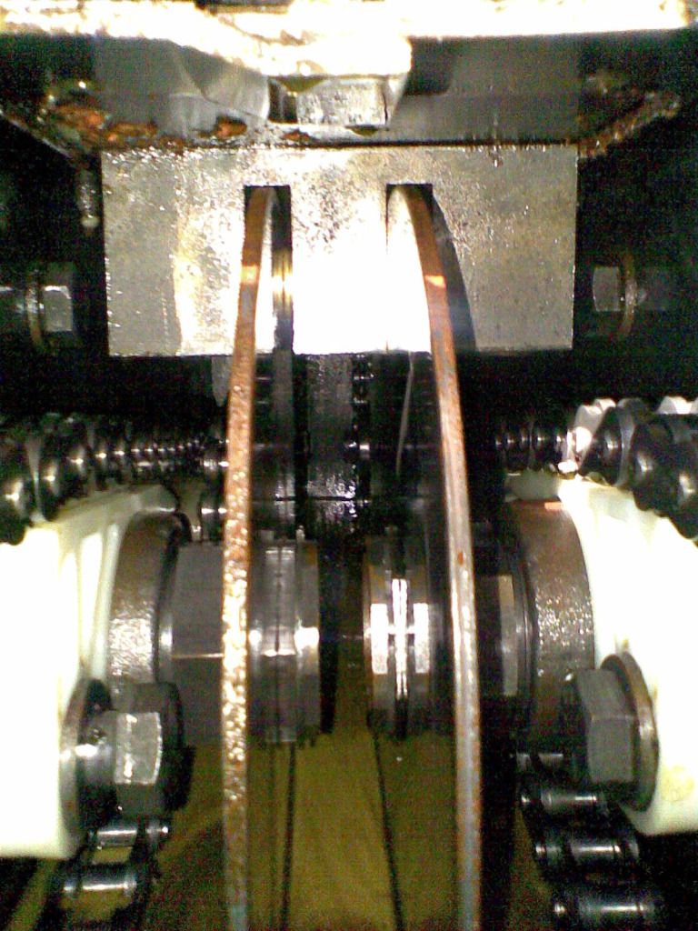

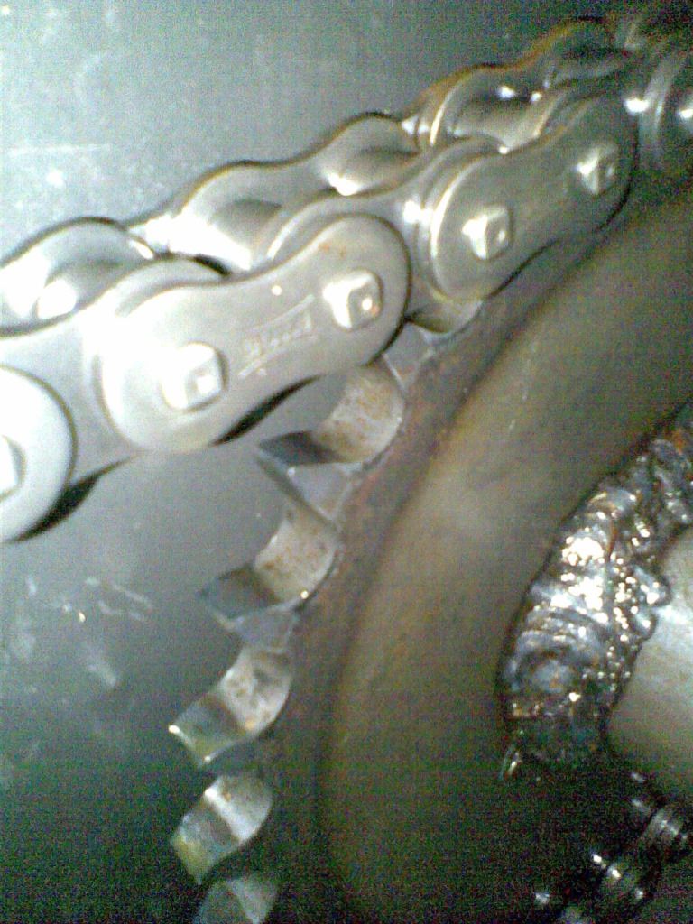

<blockquote data-quote="newy1234" data-source="post: 57596" data-attributes="member: 5611"><p>Thanks again OM and Tazza, not sure how I created the second thread for the same thing, I do not remember hitting the new thread button.</p><p>Yeah Tazza I poured some kero in the case and drove the machine back and forward a few times so it got everywhere (or atleast enough everywhere). I made a new gasket for the inspection cover and also used permetx to seal it correctly. Who ever had been in there before had used silastic to seal the cover and stripped two of the threads in the case housing! This was causing oil to leak out one side and down the side of the chain case. That is one more oil leak I have fixed! YIPPEE! Only about 10 more to go. My machine will never be out in the rain so should be all good now.</p><p>I started this thread becuase I have seen posts about changing this oil but no pics etc.</p></blockquote><p></p>
[QUOTE="newy1234, post: 57596, member: 5611"] Thanks again OM and Tazza, not sure how I created the second thread for the same thing, I do not remember hitting the new thread button. Yeah Tazza I poured some kero in the case and drove the machine back and forward a few times so it got everywhere (or atleast enough everywhere). I made a new gasket for the inspection cover and also used permetx to seal it correctly. Who ever had been in there before had used silastic to seal the cover and stripped two of the threads in the case housing! This was causing oil to leak out one side and down the side of the chain case. That is one more oil leak I have fixed! YIPPEE! Only about 10 more to go. My machine will never be out in the rain so should be all good now. I started this thread becuase I have seen posts about changing this oil but no pics etc. [/QUOTE]
