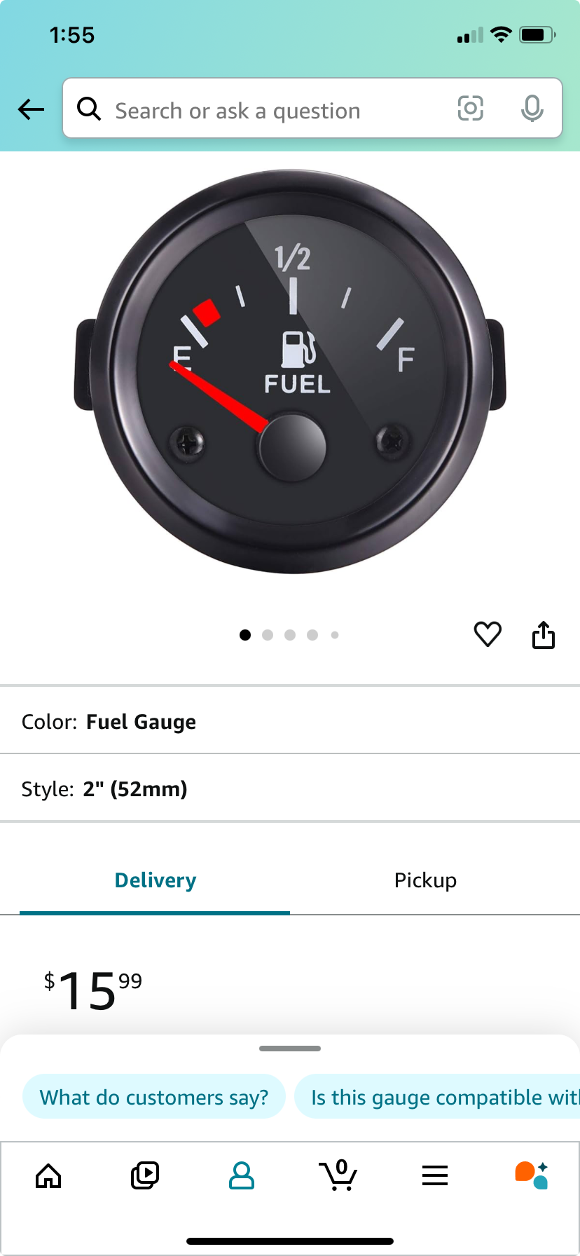

I just replaced my fuel gauge and fuel sender.
Both were bad. The gauge had a broken wire internally and the fuel sender contact wires were corroded.

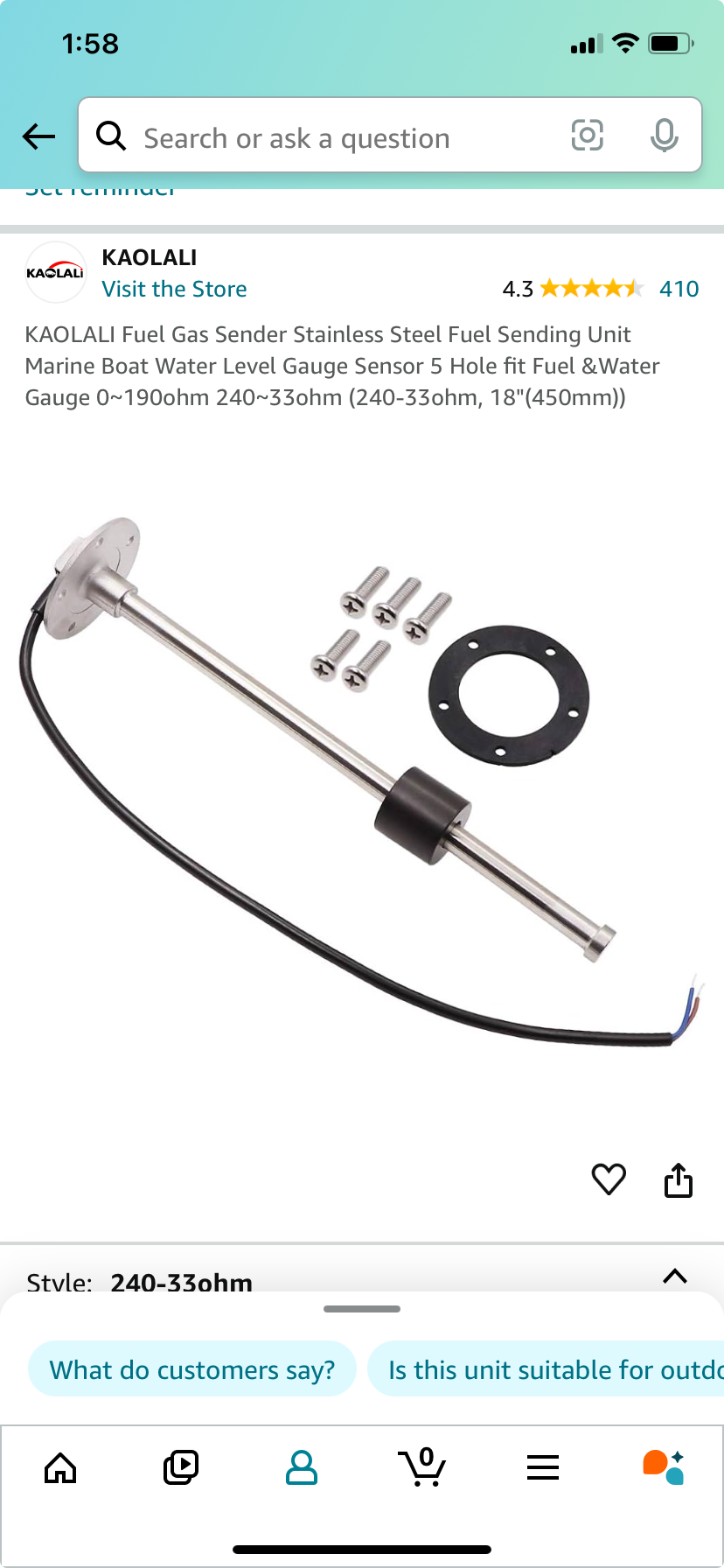

Check and see if you are getting voltage at the fuel sender, it's a purple wire. Don't forget to turn ignition on. If you don't get any check fuel gauge. Here is the ones I bought.
    511.4 KB
I like this style of sending units if you can get them in the correct lenght. I have used them with good sucess.
