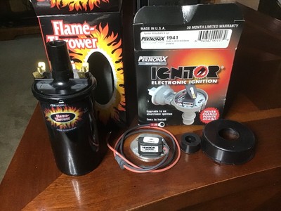

You can check your points cap and rotor visually but from what I remember there is also a condenser that I'm not sure how to check. The coil can be checked with an ohm meter. Maybe think about replacing the parts or upgrading to an electronic ignition (I do actually have one for sale on eBay. It was a left over extra from my 742B. I have most of the extra parts listed on here in the FOR SALE section. Message me if you are interested in any and we can skip eBay or not:
