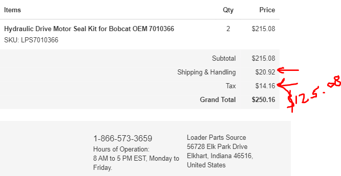

Ok the Drive motor part number for 642B is 6630037
To get a Seal Kit from LPS https://loaderpartssource.com/ The kit number to support this rebuild is
LPS7010366 cost as at time of posting is $107.54
Sourced from LPS

I hope this helps for anyone who still has this old machine and is looking to either get new drive motors or rebuild with a seal kit.
Cheers Geo.
Oh and by the way plus tax plus shipping = $125.08 per kit. If you want an all up cost $250 for both sides.
