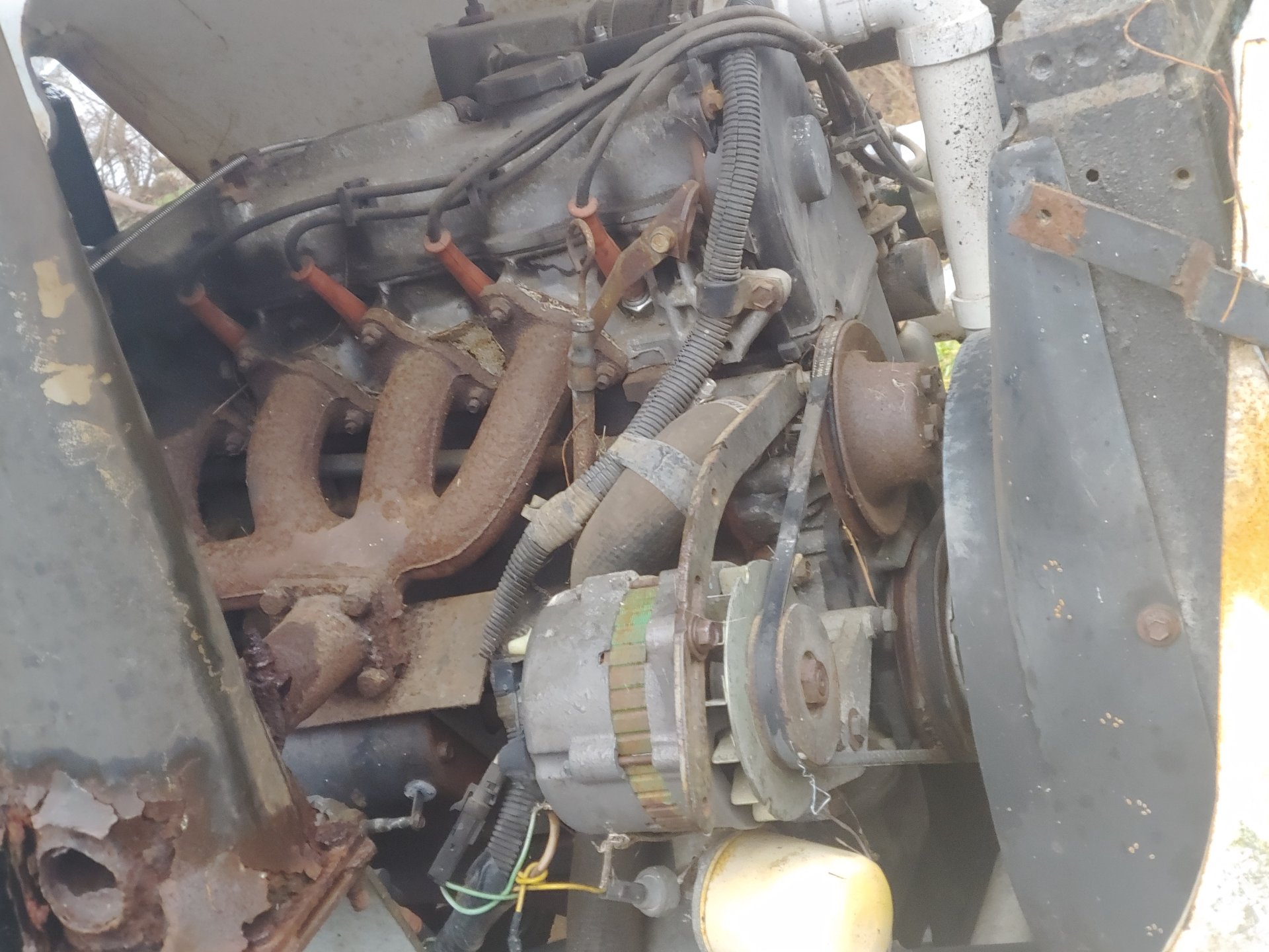

Well cars have tank below carburetor. Why does mitsu car carb have shut off solenoid? Also it has a mechanical.fuel pump. Fuel going travel from.tank up to mechanical.fuel pump and up to carb? Photo is 1979 colt carb.

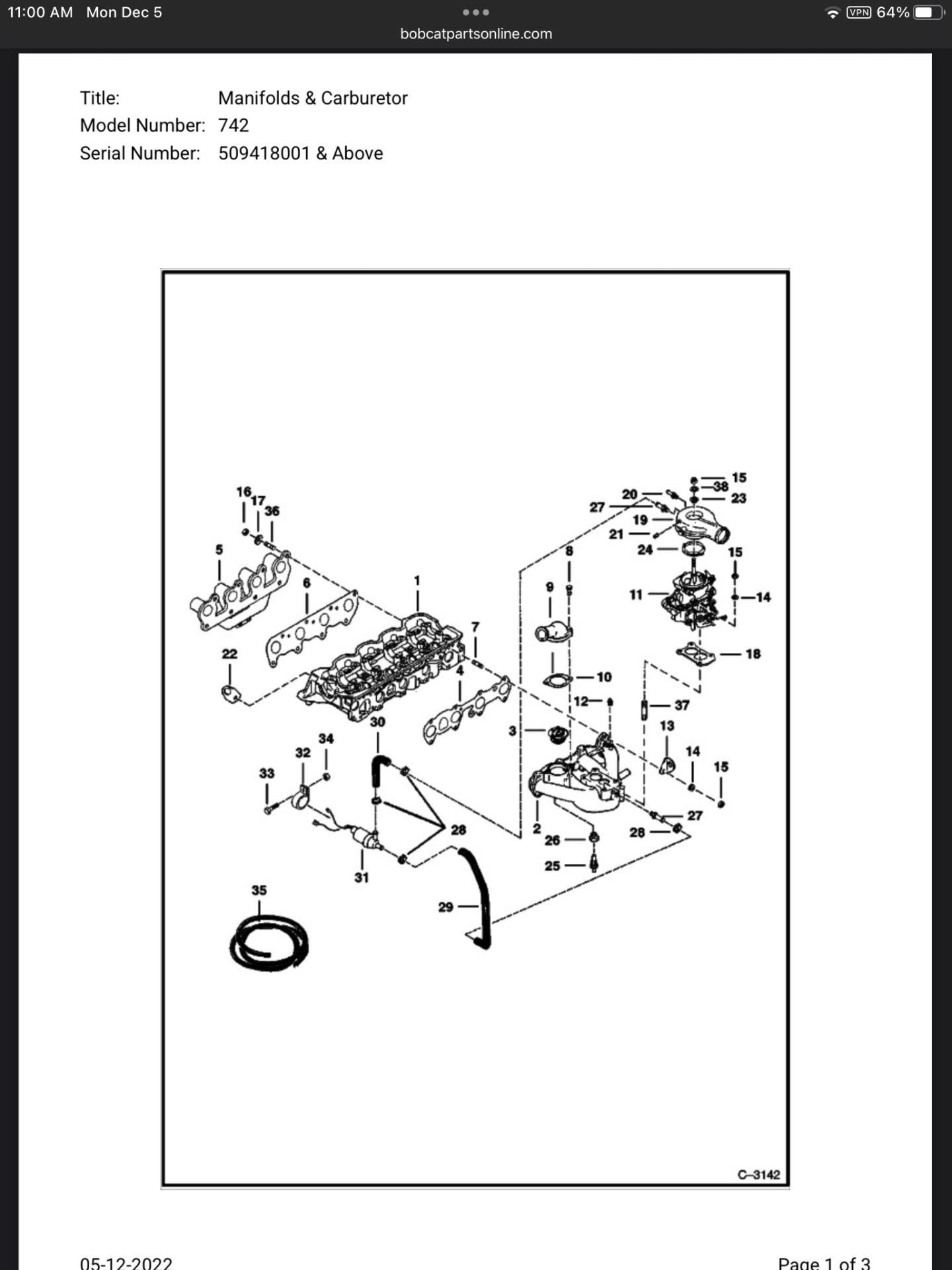

The fuel shutoff on the 642s and 742s with Mitsubishi engines was not enough to stop the dieseling. They have a separate anti-dieseling solenoid hooked up separate from the carb.
It is actually an air valve that is connected from the horn to the intake bypassing the carb. This would keep the fuel from being sucked out of the carb while the engine was stopping despite the fuel shutoff.
It is part number 31 in the attached schematic.

The photo you posted wouldn’t show it if it did have one because they were on the intake side of the engine, not the exhaust.
The solenoid on the carb only shuts off the idle circuit. Unlike cars skids have fixed throttles, not spring return. If the throttle isn't closed when its turned off, there's still fuel being drawn through the main circuit venturi booster and a hot engine could still diesel. I'm guessing the air valve opens to create a big vacuum leak to stop that.
