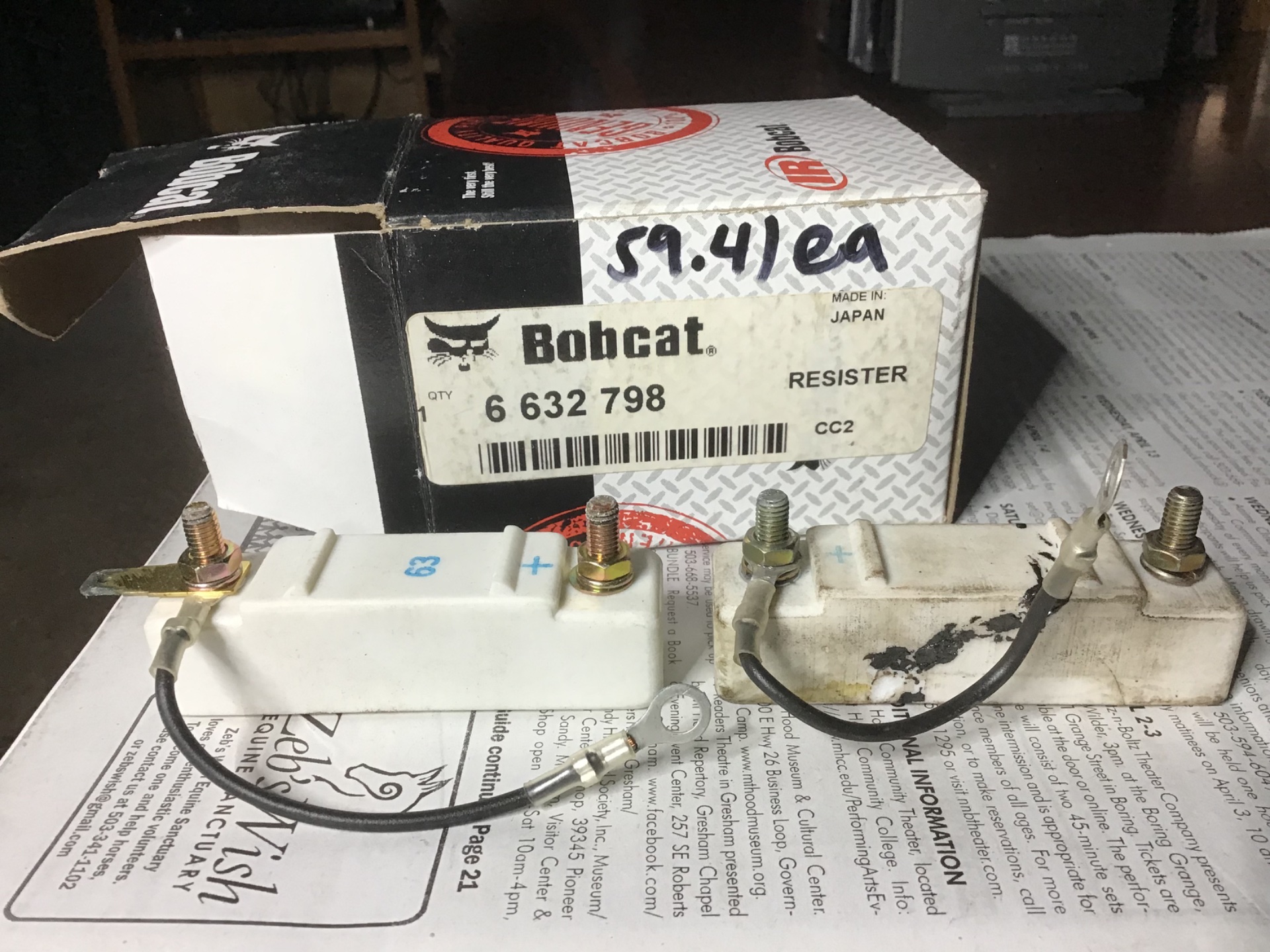

I have a 642 that I want to update to a Pertronix electronic ignition and a new high power coil. Directions say to eliminate the resistor but I can't seem to find one. Ford Engine, Bosch distributor. The current coil shows around 9 volts coming in with the switch on so I assume there has to be one somewhere?

On my 742, it was a diode. In my case the diode was near the coil and is in a ceramic block (see attached photo). The new diodes that Bobcat sell do not have the ceramic block and so I’m not sure if yours would look like the ones in the photo or not.

I guess we should have looked at the picture of the kit. The large white ceramic block has the resistor in it. Our bad!

The white block is the resistor, It even says it on the box. For points there would be 12 volts to get a hot spark to light it off and then the other side would be wired to reduce the voltage going thru the points while the key is in the run position. It doesn't need all that voltage while running and the points would last longer.

My mistake, just getting old. The diode is in the wire harness as part of the line. The resister is in the ceramic block on top of the coil.
