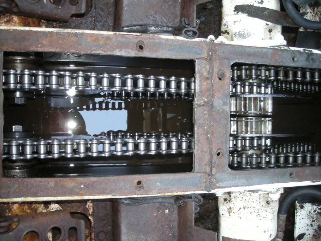

<blockquote data-quote="skidsteer.ca" data-source="post: 49369" data-attributes="member: 307"><p>The chains are not adjustable. If they a stretched and dragging on the bottom of the chain case then its time to change them.</p><p>When there are new, you can jack the machine up and roll the tread area of the tire by hand back and forth about 1 inch. If yours moves 3" or more on the tire tread that chain is getting pretty worn and stretched.</p><p>If the chain is skipping you may have a bad bearing or a sprocket with no teeth left.</p><p>Ken</p></blockquote><p></p>
