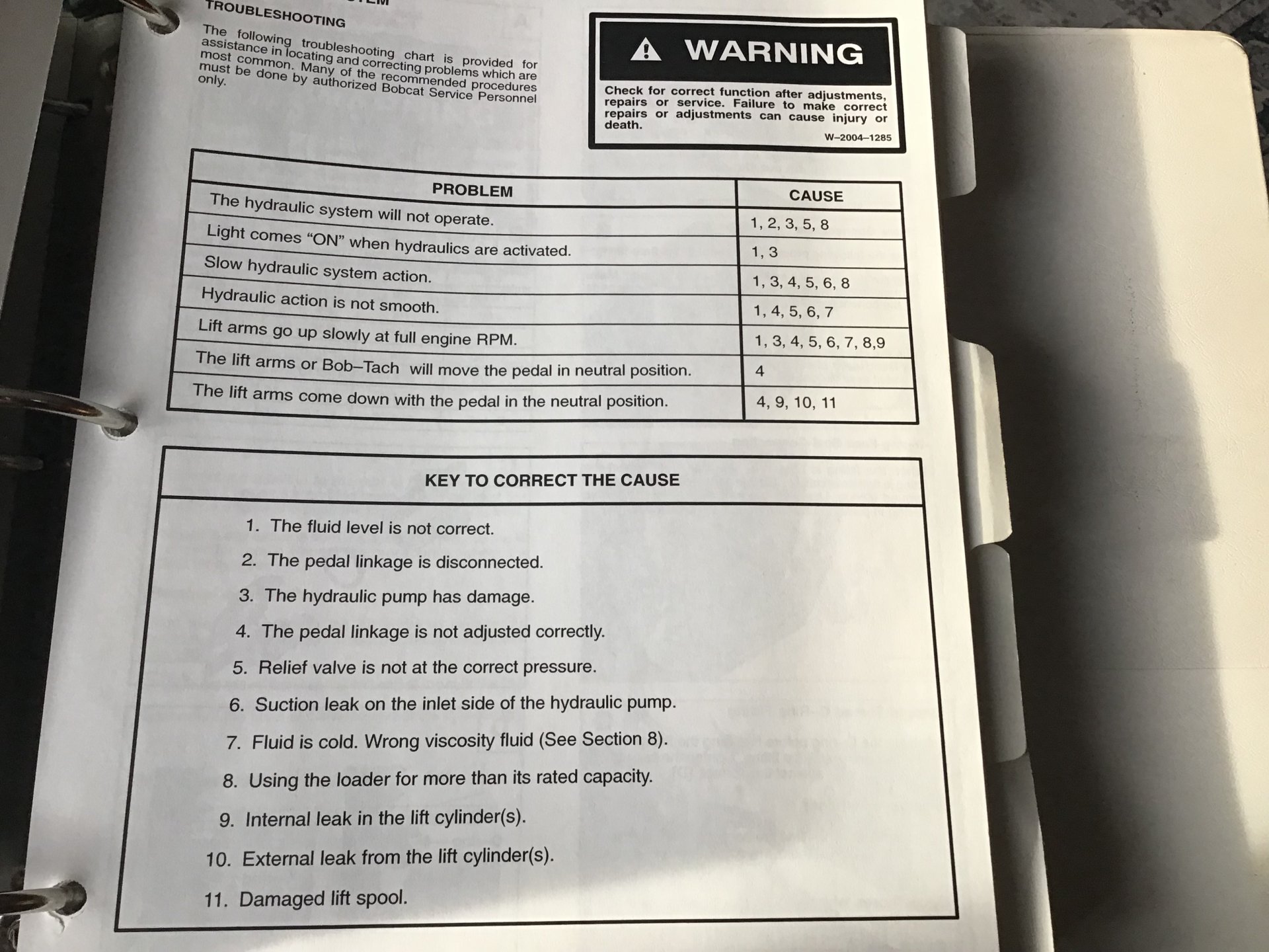

When I say drift down, I mean the arms fall at fast as if your pressing foot pedal down, but the bucket tilt works normal.
From my 743 service manual…see pic

really sounds like to me that you need to rebuild the lift cylinders that the packing internally is bypassing
