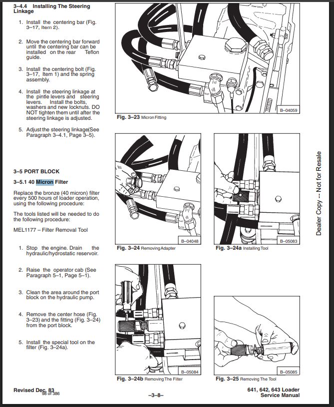

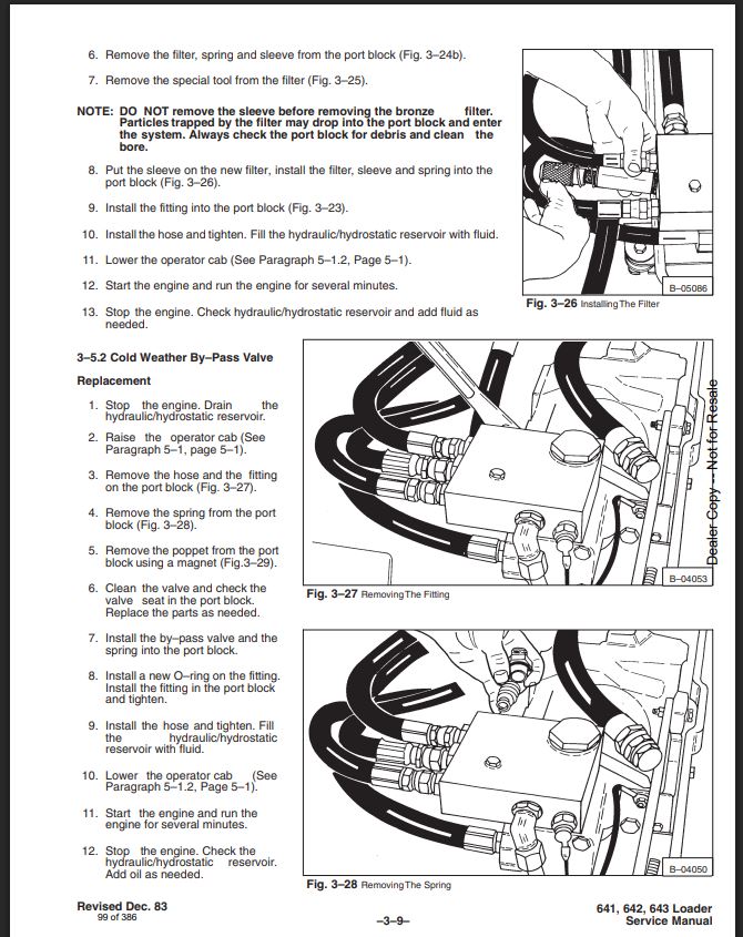

I think this is what you are looking for. The filter almost never needs to be replaced, just thoroughly cleaned.
By the way, i didn't need the special tool indicated in the manual. I just used a pair of needlenose pliers to remove it.
