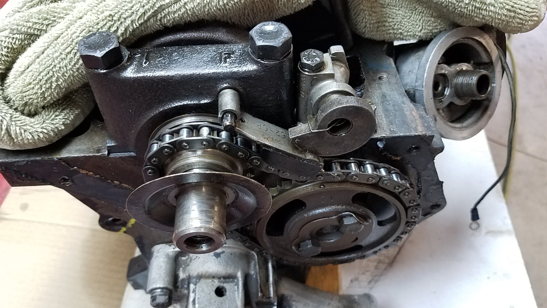

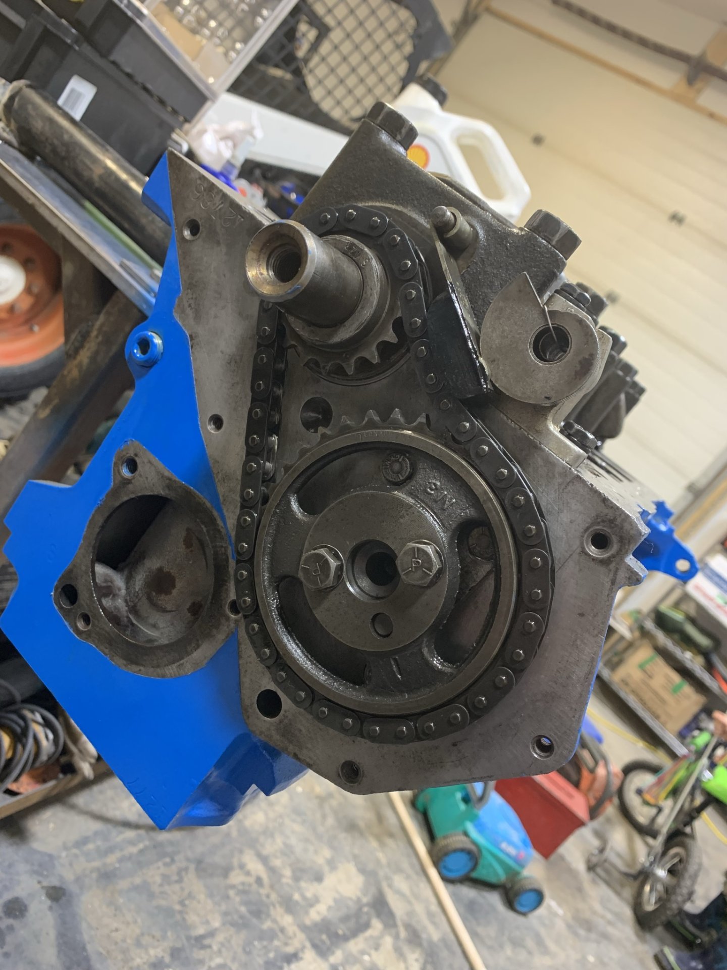

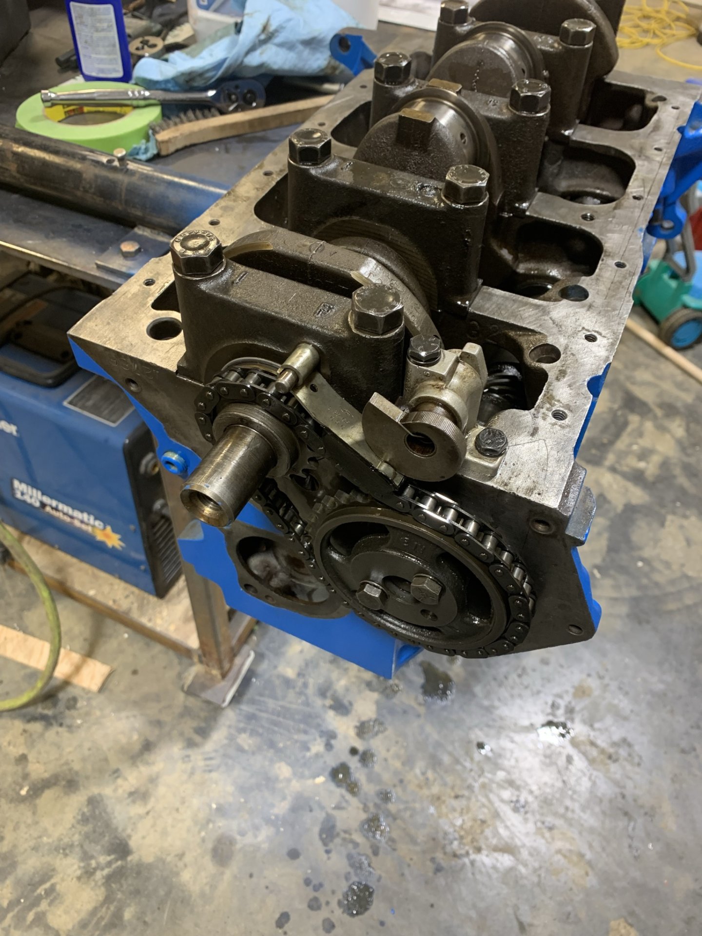

Does anyone have a picture of the engine breakdown for the Ford Industrial model 2274E / KSG416. I'm starting to think that I have a timing issue. Does this have gear to gear timing or a chain? When my issues started, I could hear a tinny noise and thinking it could be the chain hitting the cover. Thoughts?
Here’s a picture of the timing chain setup. There is a tensioner which is the cam shaped gizmo between the crankshaft and camshaft sprockets. If it isn’t tensioning your chain it could very well cause some grief as the timing will not be consistent…

The "comma" shaped part is the tensioner and has serrated surface so it does not back off. The tension is set by the spring that goes through the center of the tensioner. I suppose that spring could break and allow things to come loose. I have only worked on this one so no real world experience.

I have not dealt with the Ford motor specifically but am familiar with a set up like the one shown in the pics below.The tensioner is most likely located on the slack side of the chain. To check this set up, take the coil wire off then try turning the motor back and forth with a breaker bar, first in the normal direction of rotation then the opposite way. If there is a problem with the tensioner not being able to take up the slack you will feel it as a lot of backlash. HTH.
