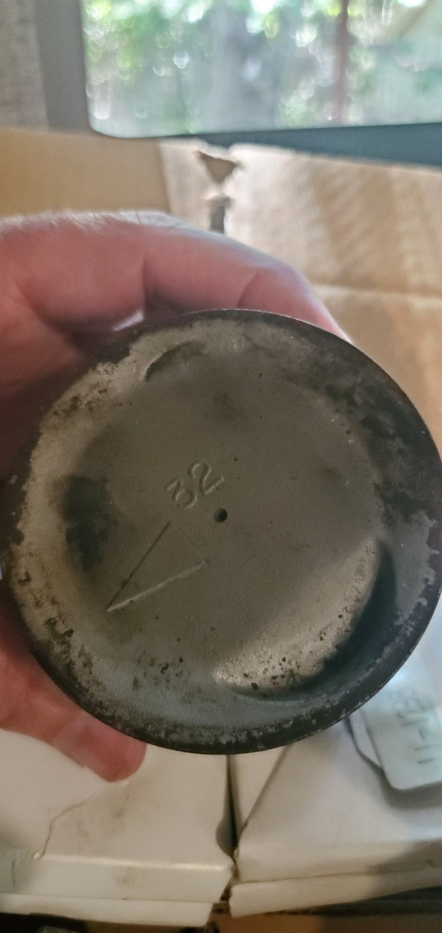

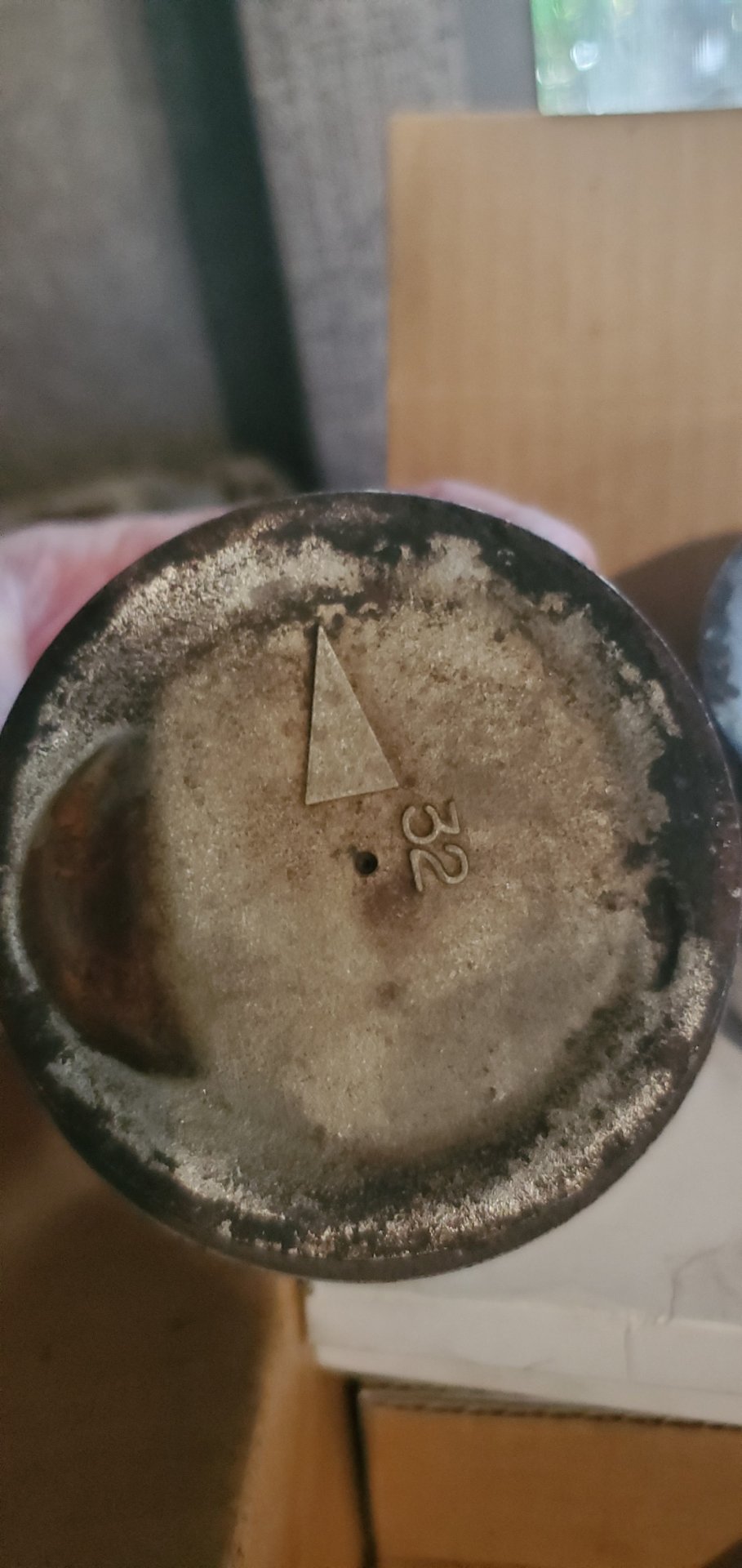

So... attached is all the info I found regarding the 4g32 pistons... I was never quite sure which ones were the correct ones. You can see in the pictures what they look like and some of the images in the PDF's are similar.
Specs according to the 742b shop manual for 4g32 piston OD: 76.86-89
Ring 1: 1.52-54
Ring 2: 1.51-53
Oil Ring 4.02-05
So you kind of get all the cross reference stuff. The part number MD012765 is found in the G32B Turbo / Commercial 4G32 and the 4G32 forklift pdf, although the pictures are a little different for the ones that do have them.

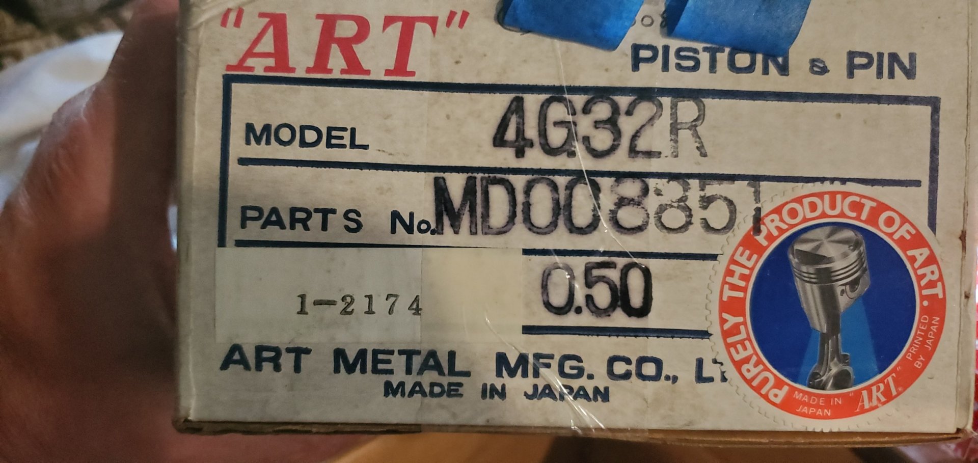

Also attached is the BOX the pistons came in (note it says 4G32R NOT G32B I guess I got that mixed up in my memory bank!)
So that is what I've come up with so far. I found the pistons on ebay.
And... these are the ones that did not fit at all.. I do not remember what was out of spec, but I "think" they were too small... but I also "thought" the pistions I did get were for the G32B! So... consider that!
Good luck. Happy to share other photos/info if I have them

Thank you for those details. These are great details Looks like you got really lucky to not only find any pistons, but the right oversize too.
Interesting that these seem to be for the turbo version also, meaning low compression. Have you done a compression test and if so what is your cylinder pressure?
And, this is confusing to me from your post--"And... these are the ones that did not fit at all.. I do not remember what was out of spec, but I "think" they were too small... but I also "thought" the pistons I did get were for the G32B!" Did you mean to also include a part number or other description of teh ones that didn't work, or was this ("and these are...") just a typo?
Thank you, and thank you for the compliment.
Sorry about that, these are the ones that didn't fit.
FPE Piston (.50MM) Mitsubishi/Caterpillar MD009591 Hacus - New
Thanks for clarifying!
Adam
