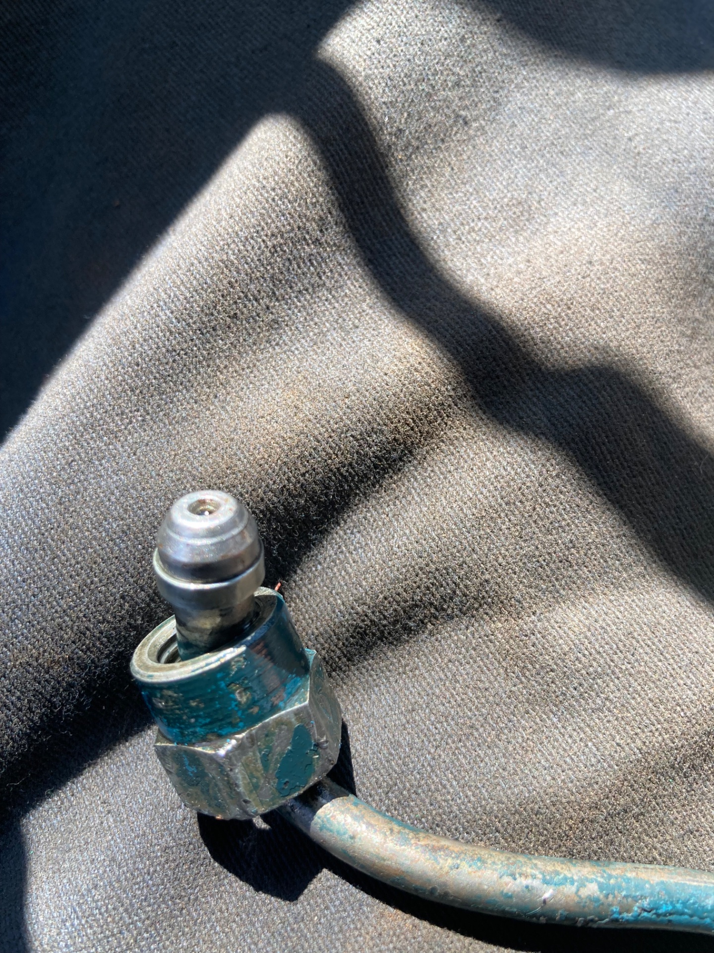

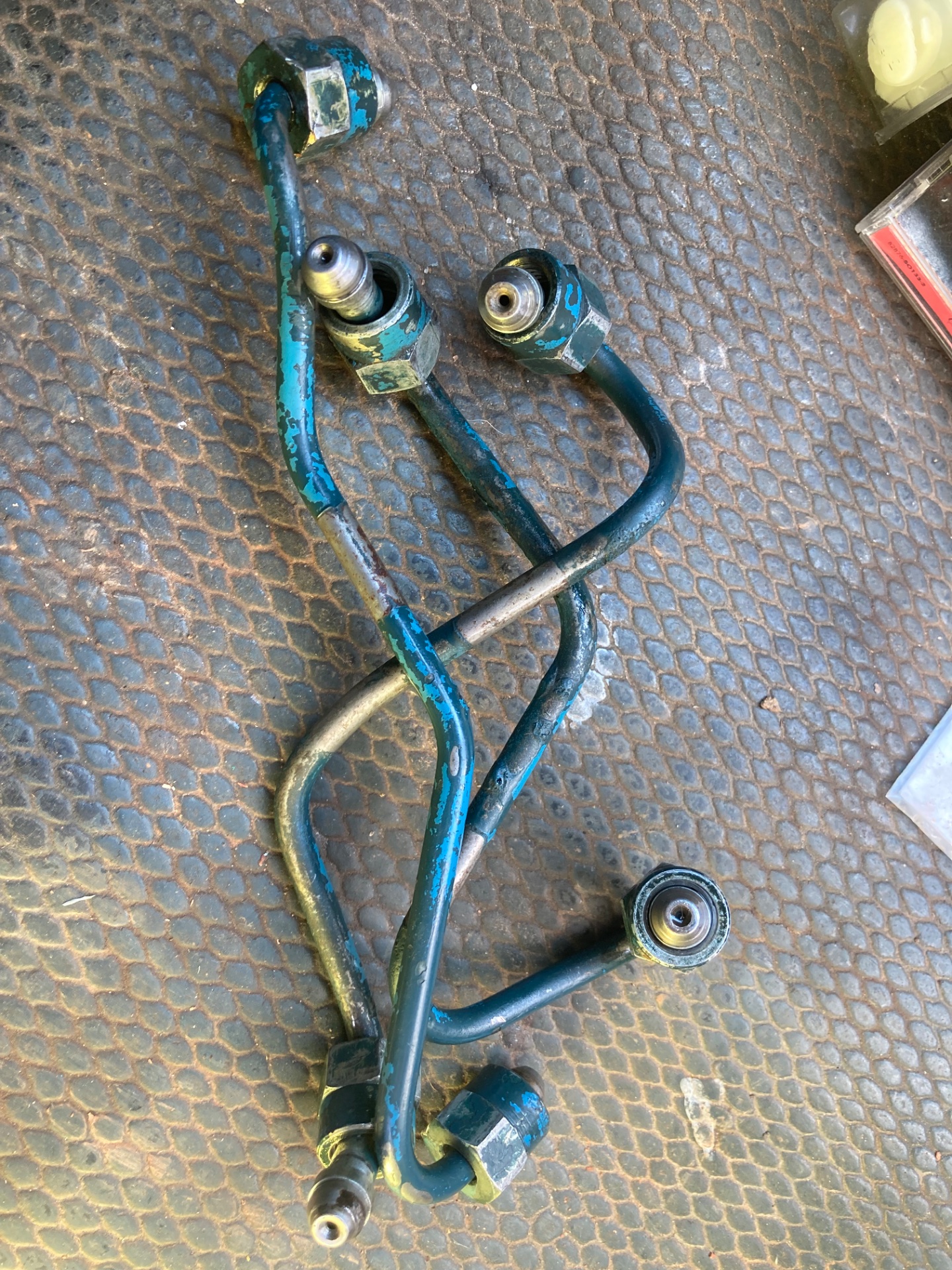

Cleaned everything up pretty well. Replaced crush washers, head shields, etc. with injectors. I just can’t get it to stop leaking fuel. This machine has a 3cyl. Kubota 722. It starts but runs rough and then I see that there are several leaks. Sometimes it’s hard to pinpoint exactly where the leak is coming from but I am assuming it’s from where the fuel line flare meets the injector nozzle // injection pump on other side. I tried to clean these out. I am mostly following torque specs although I don’t have a way to torque the fuel lines. Can these be over tightened and cause issues?
The overflow rail is mounted correctly as far as I can tell (injection pump to the injector near water pump #1, and the return to fuel tank to the #3 nozzle)
