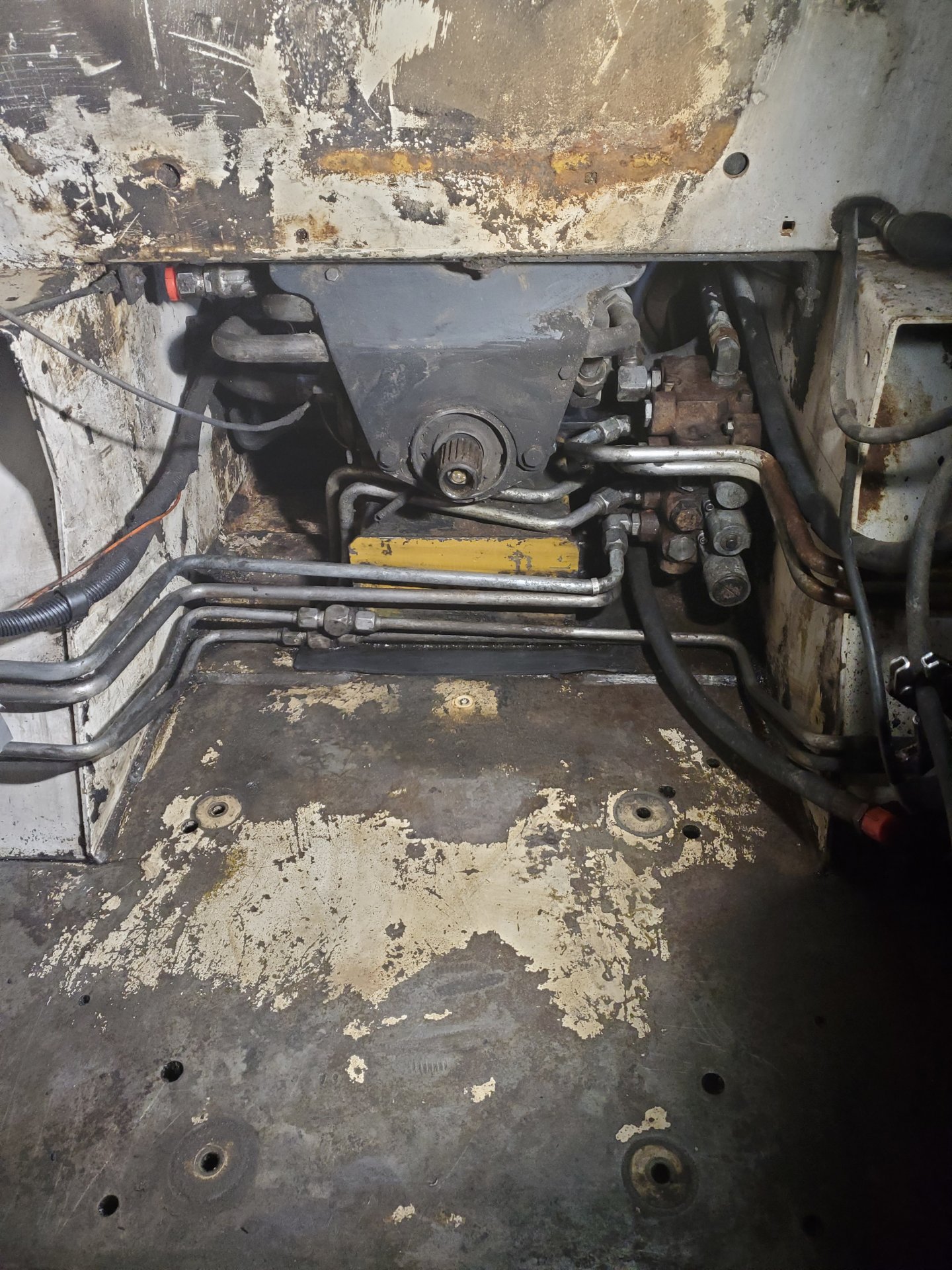

On my 743, engine had to be removed. Then I had access to lots of good stuff. Those lower steel lines are usually compacted in muck, debris, schmutz, and they corrode. This is a pic AFTER hours of cleaning. Good luck
    566.8 KB
Great question. The 743 engine is direct drive and in line with the hst pump, through a ujoint coupler. No more that an hour to get that engine out.
I looked at a pic of the 453 and the engine is transverse mount, driving hst pump with a belt. From the looks of it, I wouldn’t shy from it. I take lots of pictures of where stuff goes, esp wires, when I do something like this first time. If you do it, think of other things that might be needed while engine is out, like other steel hydr lines with exterior corrosion though not yet leaking, and valve spool access might be much easier with engine out (might be worth changing spool seals if not done on your watch before) older machine…runs and drives good…does what you need it to…no computers…might be worth it. Good luck.
